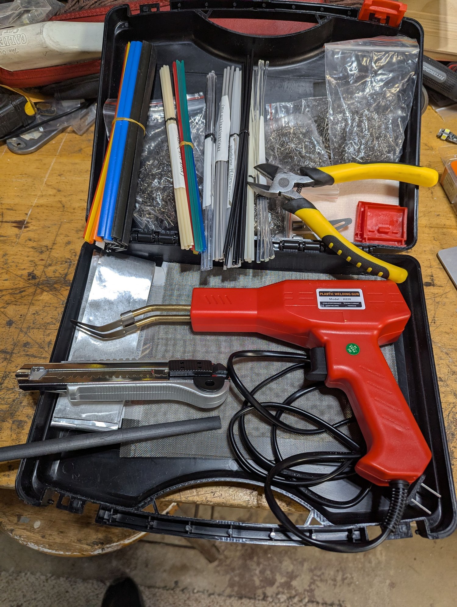

I bought a cheap little plastic welding kit off of Amazon and it has been really useful repairing some things on the Vette. As much brittle plastic is in these cars I highly recommend getting one. Today I repaired the driver's fender/ battery cover I picked up to replace my broken one. I found a crack in it so I'll show how I repaired a factory piece that's kinda hard to find. Here is the kit I got for around $30. Comes with tools, different types of plastic welding rods, and some other plastic repair items.

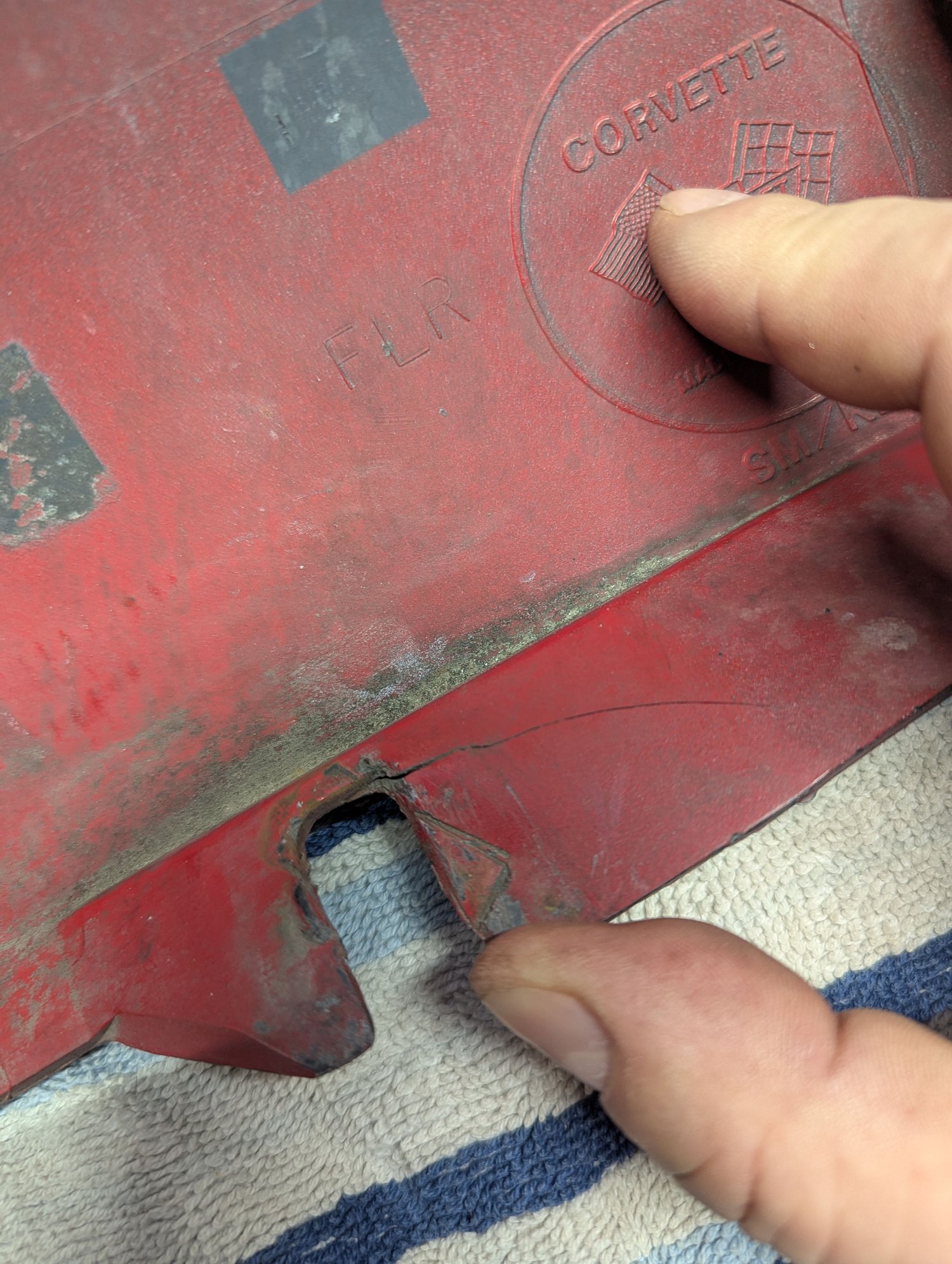

Here is the crack and damage we are going to fix on the bottom of this fender.

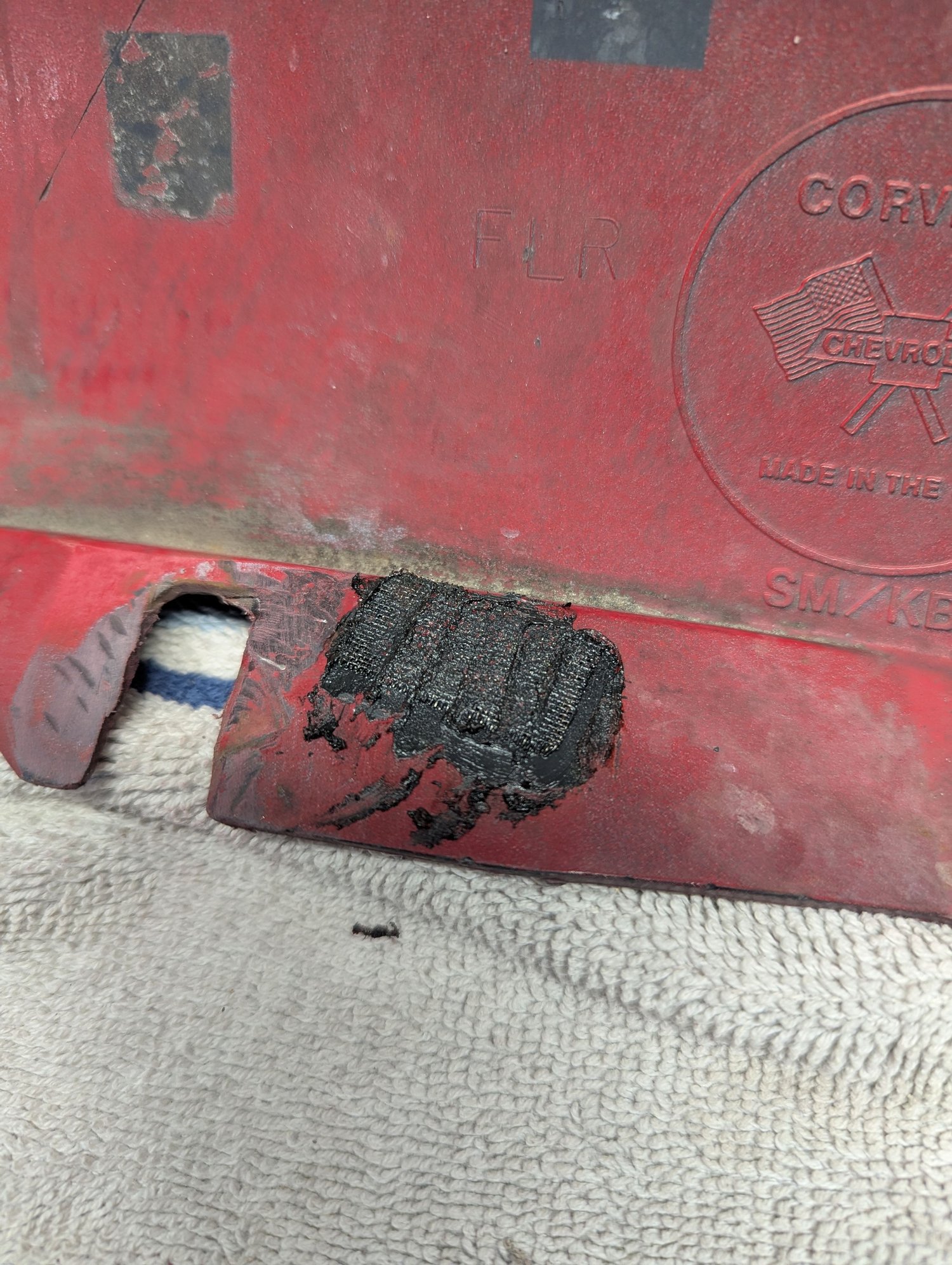

After sanding and smoothing what's been done so far I'm going to melt this section of metal screen into the rest of the crack.

Screen material melted into the existing plastic.

Added a little new plastic to the screen reinforced area and low spots in the opening. This area is on the inside so it doesn't have to be perfectly smooth. I still have to paint this panel so it will look fine when that's done. I don't think I have to worry about that crack anymore. This whole process took about 20 minutes.

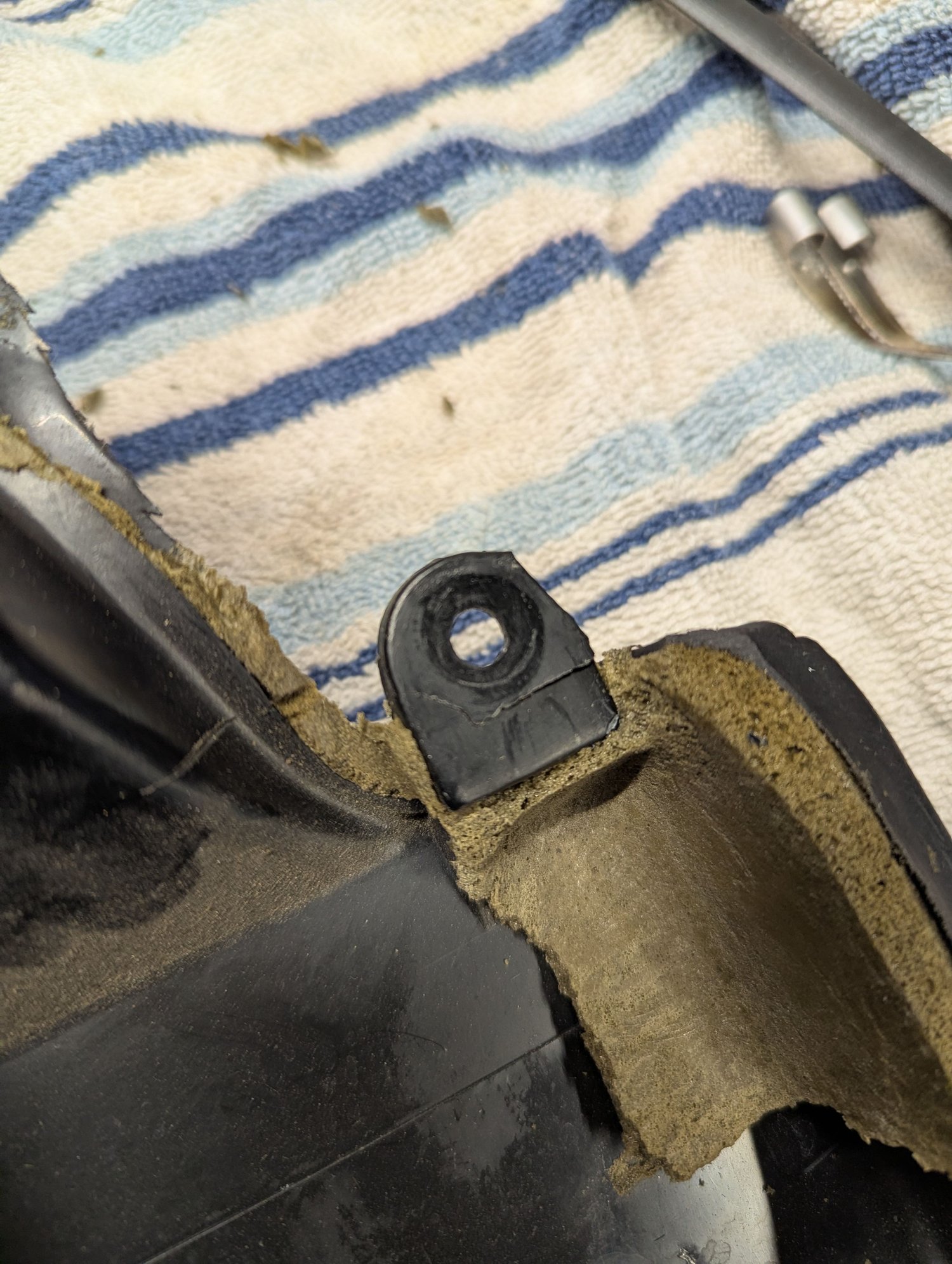

Almost broken off door panel tab.

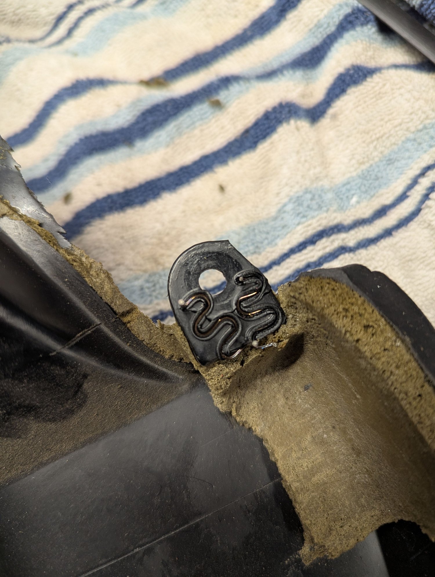

Wires melted in to hold.

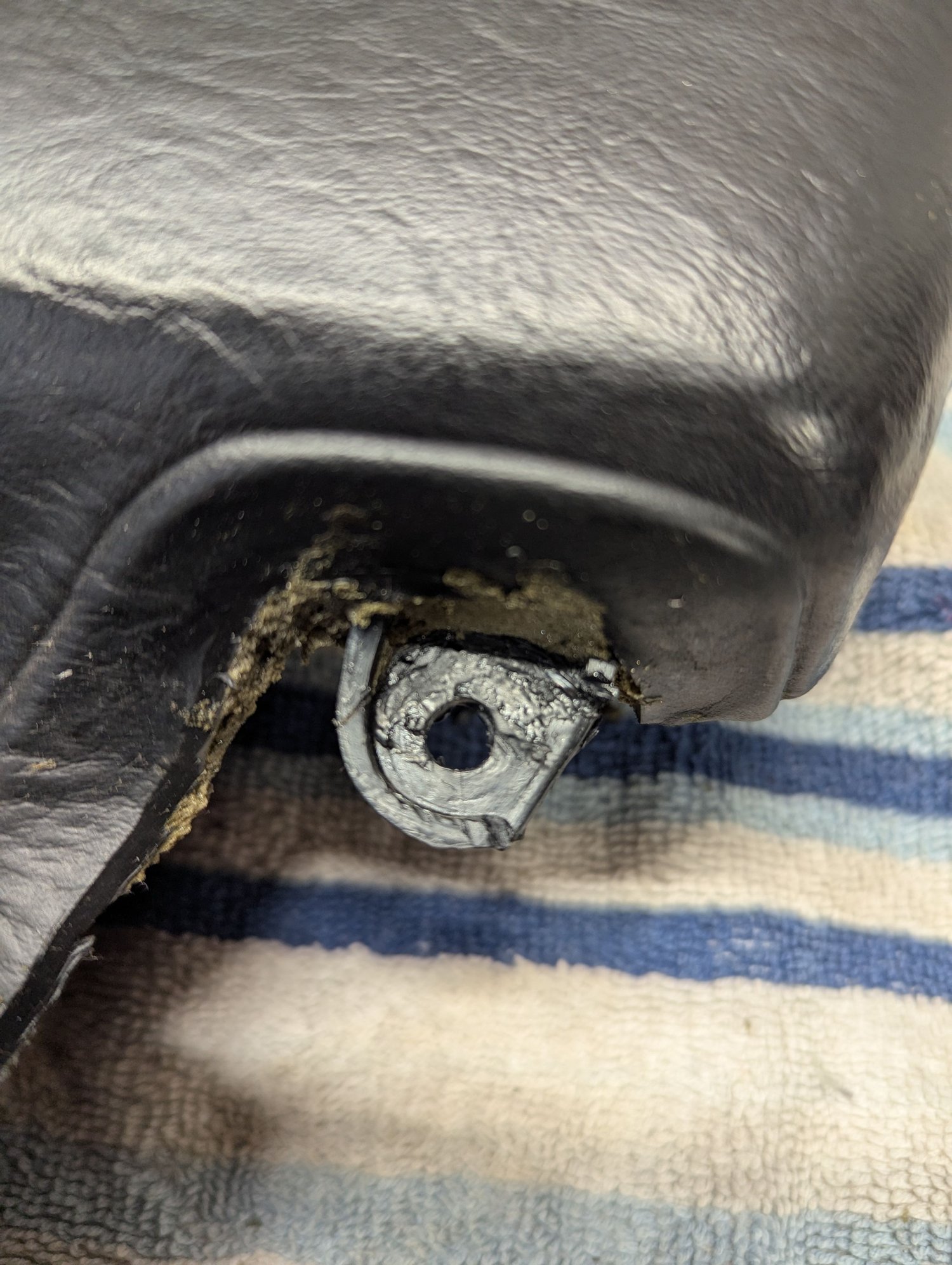

Finished. Not pretty, but functional. Saved a door panel.
