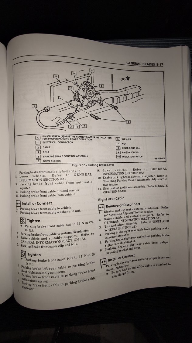

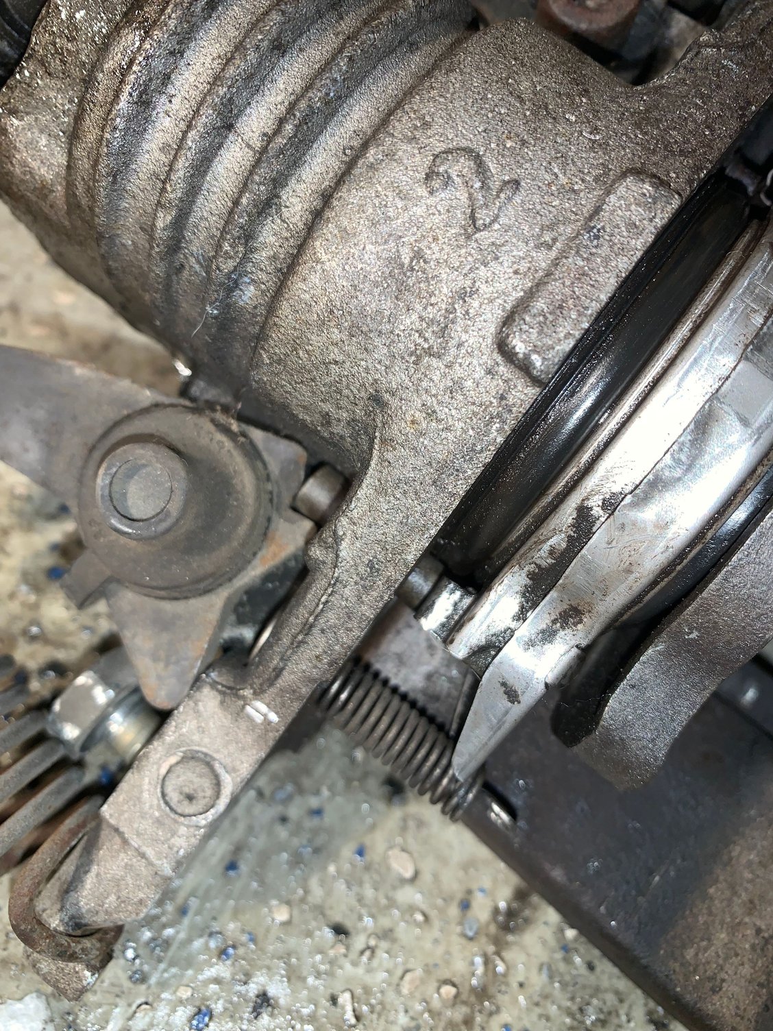

Hi hopefully be something simple, is normal to use a G clamp to press the caliper pistons back into the callipers. No need to release the bleed screw, anyway always good to bleed the brakes every two years as brake fluid absorbs moisture. Sounds like your issue is now with the rear brake dragging, have attached images from my shop manual to show the calliper handbrake mechanism adjustment. Also the automatic handbrake adjust how to disable and enable it. It may be the auto handbrake adjuster or incorrectly adjusted calliper adjusting screw (23 in rear calliper diagram) causing your rear brake to not release fully.
Hope these images help you 🙂👍

Appreciate these images greatly! Will report back.
I just ordered my service manuals today, wishing I had these a while ago.

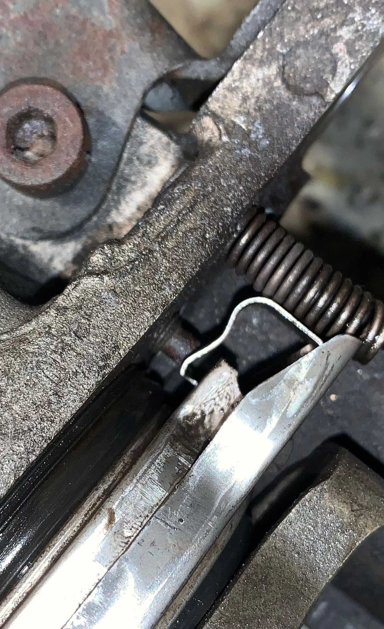

A few hopefully clearer images

​​​​​​When at the rear calliper with handbrake cable pulled off the calliper lever, you will know if its the calliper adjuster screw incorrectly set not allowing the piston back fully or the handbrake auto adjuster needing to be reset. Good luck 🙂👍

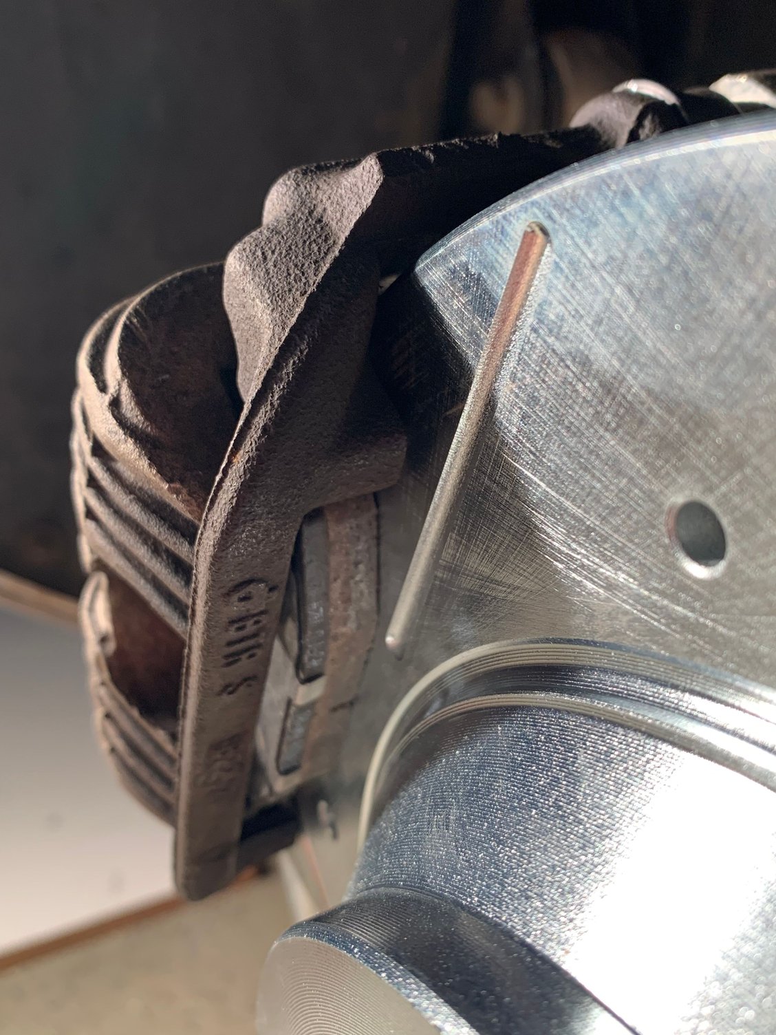

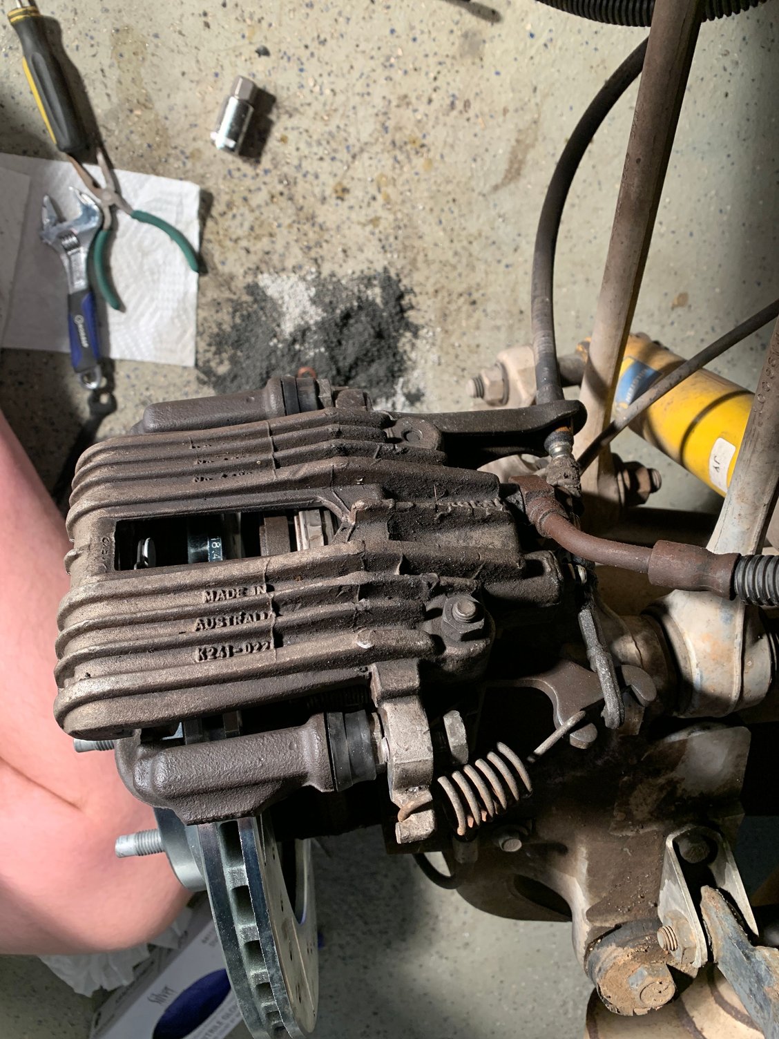

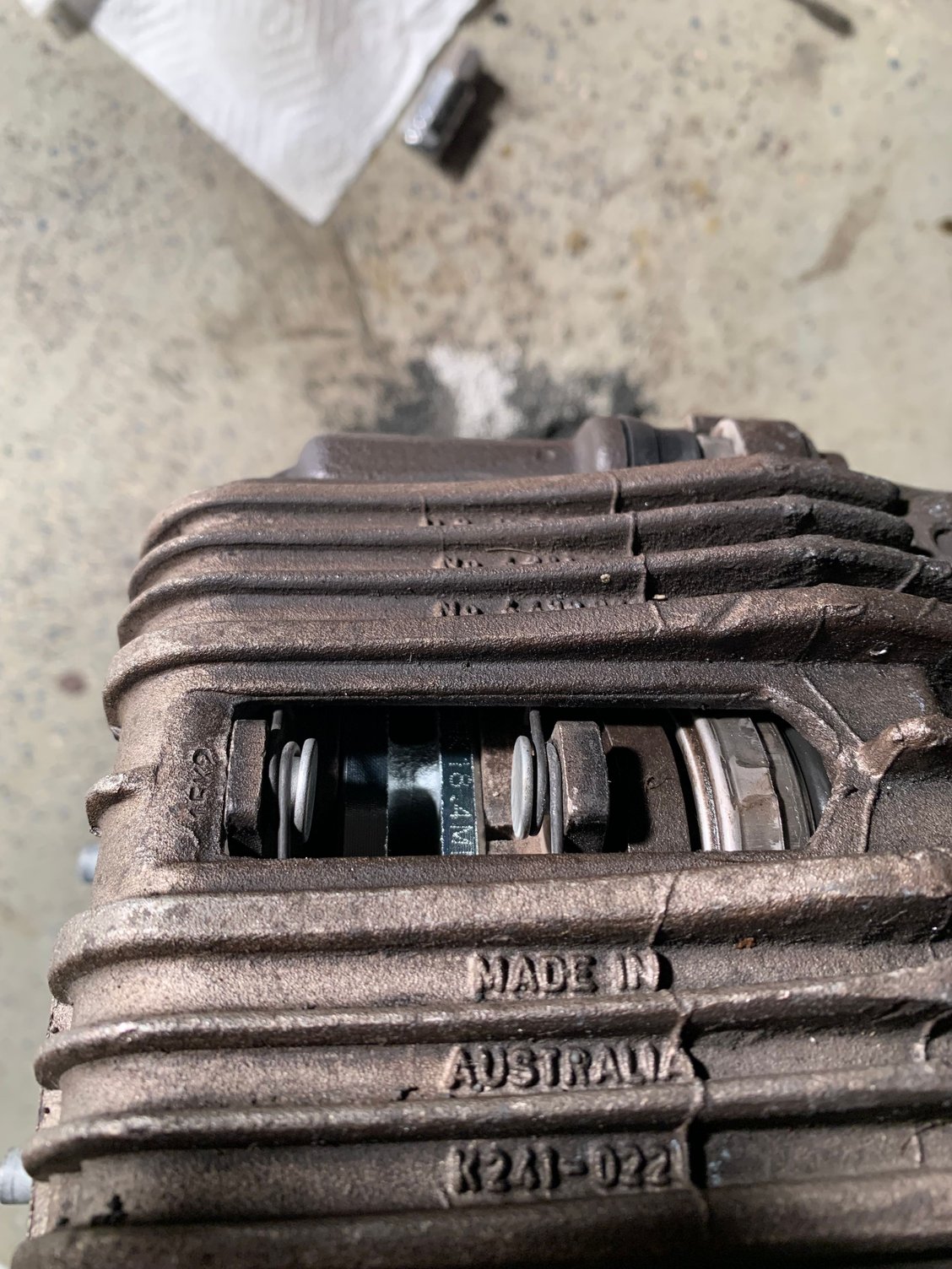

Here are some images.

The caliper looks fully compressed, correct me if I’m wrong, but the pads still stick right up against the rotor with a pretty tight fit. I tried to show that as best I could in the images. As for the parking brake does everything look normal? As I’m not engaged? Pic shown below
(I do have the caliper and pads off in this photo)
EDIT: I took the brake line off for better access to the caliper. Both 11 and 23 in the caliper diagram are pushed faints the piston: parking brake. You said to take off the parking brake cable and then I would know if that was the problem? How do I go about doing that

I suppose I should have asked this earlier but this isnt normal right? for the brake pads to be smushed up against the rotor like this? i can't rotate the rotors by hand with the caliper and pads on, but i can with them off. I can't imagine this much resistance is good to drive on? Im not making a problem out of nothing right... this is my first brake job.

It looks to me like the pistons aren't compressed like at all. I could be misinterpreting that picture, but I see what looks like a lot of piston sticking up out of the caliper.

Hopefully someone has a rear calliper out and can measure the gap between fully retracted piston and calliper end, then you will know your piston is fully back and not held out by the adjustment screw or pushrods . Have replaced the rear pads on my vette a few months ago and had no issue fitting the calliper and brake pads onto rotor, however I did disassemble the calliper and put a new seal kit in. I followed the procedure in manual to ensure the adjuster screw was set correctly, if not it can limit how much room there is for the brake pads. it's a one off only adjustment when calliper is being rebuilt. Hopefully no one had fiddled with it, not knowing there is a separate handbrake lever area auto adjuster as well. Have never had brake pads that were too thick, in my 20+ years of replacing them on my corvettes. Always pushed the piston back fully with a G clamp, pushing fluid into master cylinder. You cannot damage the abs unit, unless there was a lot of rust debris in the calliper. I suggest checking the calliper adjuster screw as per shop manual, to ensure correct clearance and eliminate that being an issue before sanding the pads down to fit. Good luck, perseverance pays off, you will find the problem eventually 👍
