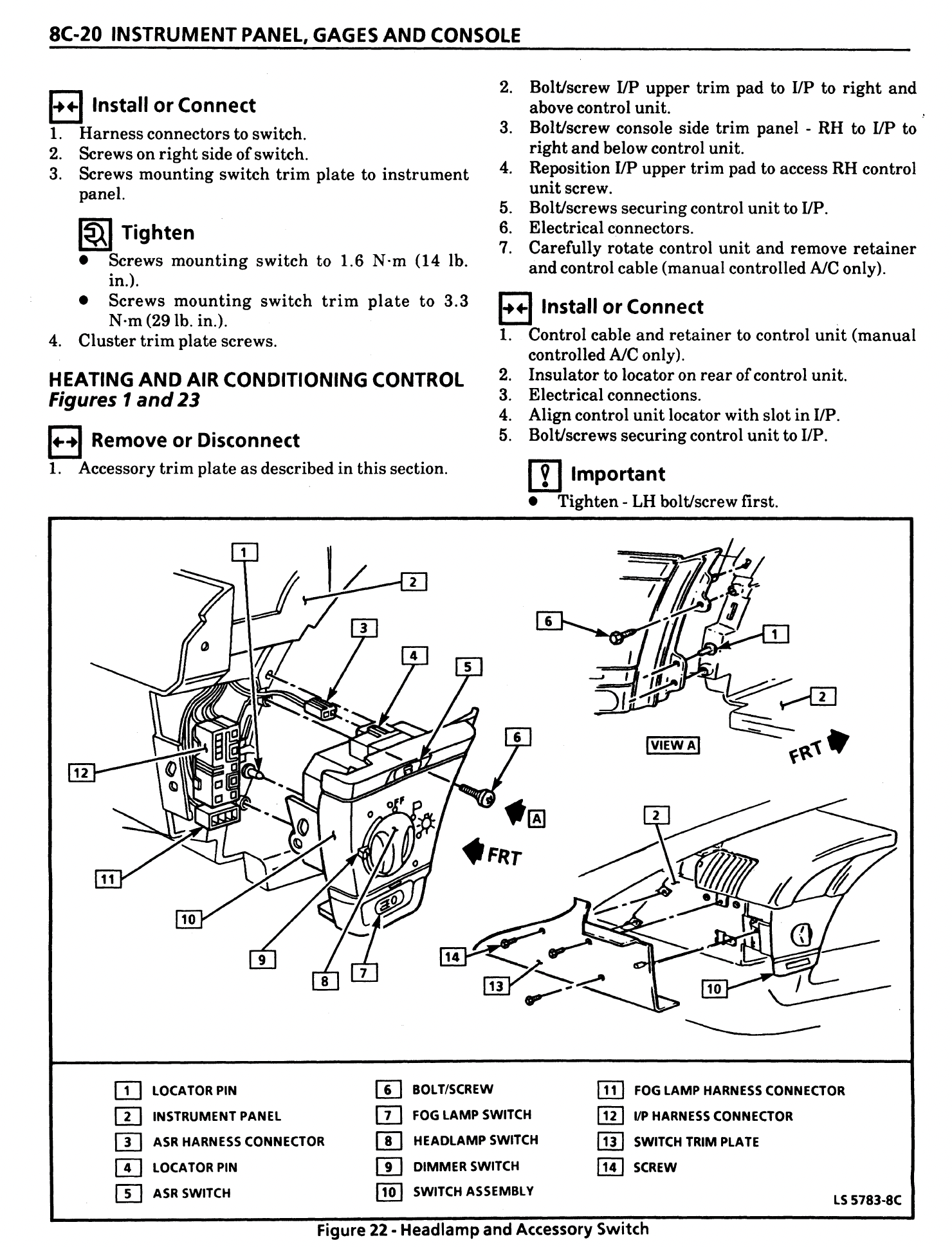

Good morning, anyone know of a video or any help how to replace a headlight switch 92 C4, thanks (Can't find a video

Follow the instructions in the FSM(Factory/Field Service Manual) 8B-14

from 1992 FSM

Thank you, just what I was looking for.
