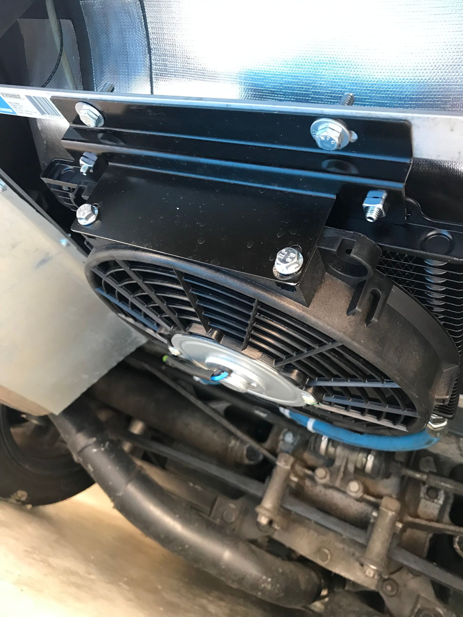

Rear cooer with all 6an lines I don't see any problems, before the rear cooler ran 6 an lines off the stock radiator cooler no problem .
