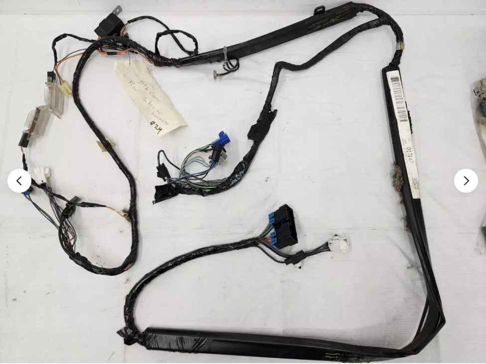

I decided to take on the horrendous wiring that a previous owner decided to screw up and it was beyond fixing so I decided to order a new used harness off of eBay the rear body harness that I ordered was out of a 96 corvette convertible and the car I have is a 93 convertible and the wiring looks identical now that I installed the new wiring I have an "service ABS" light on that's constantly on and the ABS isn't functioning and I can't figure out why the new wiring doesn't have any corrosion or cut wires and everything seems to be grounded so my question is since I can't find an answer anywhere are the pinouts different on the 96 harness compared to the 93 or do I need to get the 96 ABS module or is it a fluke and the ABS actually has something else wrong like a sensor or something.
This is the harness that I installed that was out of an 96 Convertible
