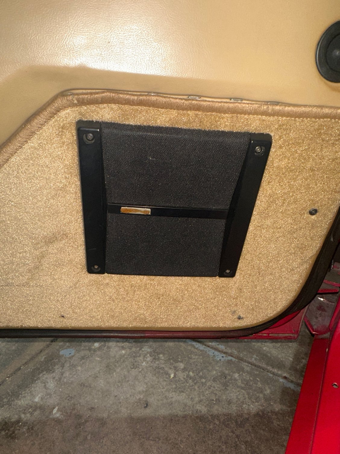

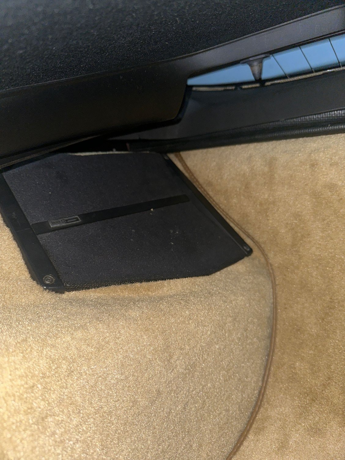

All stock Bose/Delco on the covers. Not to sure if this help. Sorry the hard top is in the back right now so makes it hard to take those pics. Let me know if this helps or if I should send something else. Thanks👍

Okay, a factory Bose system. That will help a lot.
There's people here a lot more knowledgeable about this stuff than I am, so I'll defer to them. My car came with an aftermarket radio and what appears to be the original Bose speakers. I thought it sounded really good, but YMMV. I like that you want to keep the stock look. Wasn't an option for me.

You have a bunch of different ways to do this. It really depends on how involved you want to get with it. So by the sounds of it you just want a basic radio that sounds half decent and doesn't cost a bunch. If that's the case the first thing is to select some parts.
For the head unit (in dash radio) you have an almost unlimited amount of choices. The most straight forward approach would be a simple single din style head unit with a built in amp and all the features you want. So here's where you're going to have Bluetooth, USB and your aux connections. Just stick with a good name brand here. Pioneer, JBL, Sony etc.
Next is speakers. Any basic 6x9 coaxial will fit under the rear speaker covers. You may need to drill new holes to mount them but it's not a big deal. Now is the tricky part. You can remove the door speakers and replace them directly and keep the Bose speaker boxes that are on the door. If you do this you will need small 4" speakers. A speaker that small won't make a lot of sound. So you will want to spend some money here on something quality. Another option is to remove the Bose box and make an adapter plate that will allow you to mount 6 1/2" speakers. This will sound much better but requires more work and a little fabrication. This is what I did in my 84. The third option is to pull the dash pad off and install 4x6's. This was what was installed from the factory on non Bose cars. Then simply don't use the door speakers.
The "best" budget system in my opinion is to do both the 6 1/2" door and the dash pad speakers. Then run the door speakers off of a small amp. But you can always upgrade to that later.
For wiring just get a adapter harness. Then solder the wires to the harness that comes with your new head unit. The wires are color coded so you can't really mess this up. The last piece is a mounting kit. This just mounts the new head unit in the dash.
One last thing. Most people who install after market audio in a C4 that had a Bose system will run new speaker wire. Just get a roll of the stuff in 16 gauge or larger. Routing this will be the time consuming part. Take your time and just do one speaker at a time.
