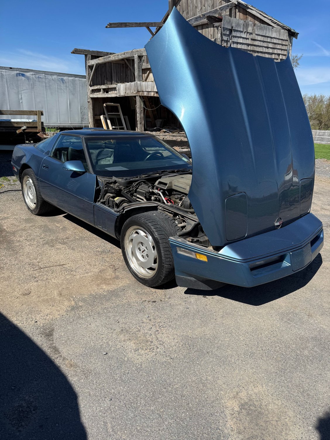

Originally Posted by mazdaverx7
If the engine is not on and the key is in the on position, and you see the battery voltage dropping, I would first suspect a weak battery. I would test and replace the battery if you find that its not good.
Battery tested clean on both an analog and digital portable tester. The voltage drop I experienced was while driving, not idling or off. Taking out the alt to get tested today, hopefully that’s the issue. Can’t wait to get it back on the road. Pic below

That paint looks really clean. It’s certainly aftermarket (painted belt line) so I wonder if the car is an original blue or maybe another color. Love the look of this machine though.
Mine isn’t quite so nice. Almost looks two-tone with how bad the previous paint job was. But she drives good and I’m sure once your alternator situation is figured out, yours will be problem-free for a good chunk of miles.

Some interesting adds to the '84, CHMSL and the 'sawblades'.
Good eye, I had hardly even noticed the high-mounted brake light. Previous owner must have been real safety-minded.
