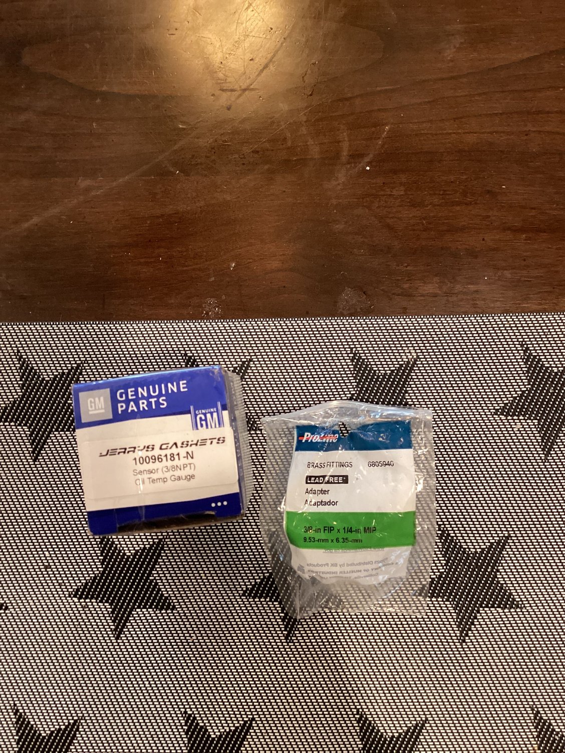

i found a fix! I bought this sending unit for a ‘92-95 ZR-1.
https://www.jerrysgaskets.com/sensor...new-92-95-2b1/
The thread is too large so off to Menards for an adapter number6805940 (3/8 in FIP x 1/4 in MIP). Thought I had it but the hex on the adapter interferes with the engine. I ended up putting the adapter in my drill press and removing the hex up about half way. This allows the adapter to thread all the way into the block. I’m sure if I tried a few different brass adapters I could find a solution without modifying the adapter but I was hot and sweaty so I didn’t feel like multiple trips to find different adapters. Plug in the connector and start the car, Check For Leaks!
my digital gauge and analog gauge now both work!
I wish I took pictures but again, Hot, Sweaty etc! Hope my description works.
