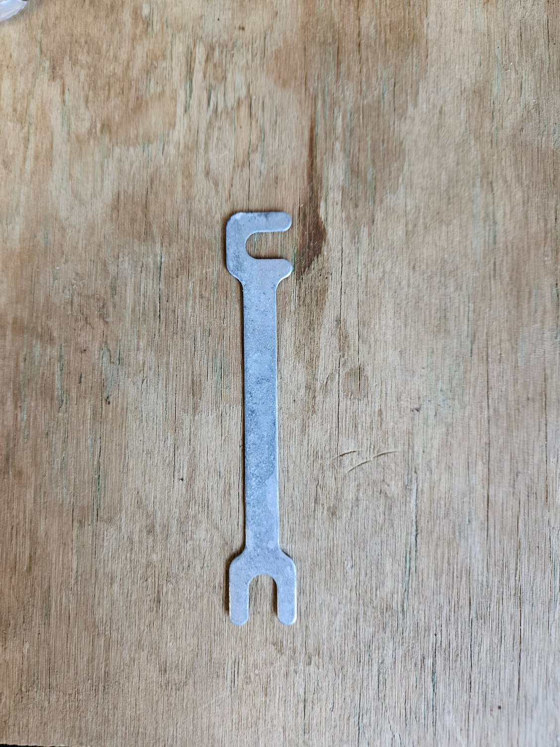

I was adding insulation to the floorboard and this thing fell out from under the carpet on the "wall" behind driver's seat.
Looks like a shim... To what?

Shim for rear targa top mounts on the halo.

What would it be under the carpet...any theories?
I assume it puts space between the bracket and halo itself, correct?
How do I know I need to add the shim? Creaking?

Somebody trying to fix it and it fell and not noticed. Could have been at the factory or a private owner.
But yes, to shim the bolting plate in place for the targa top.
