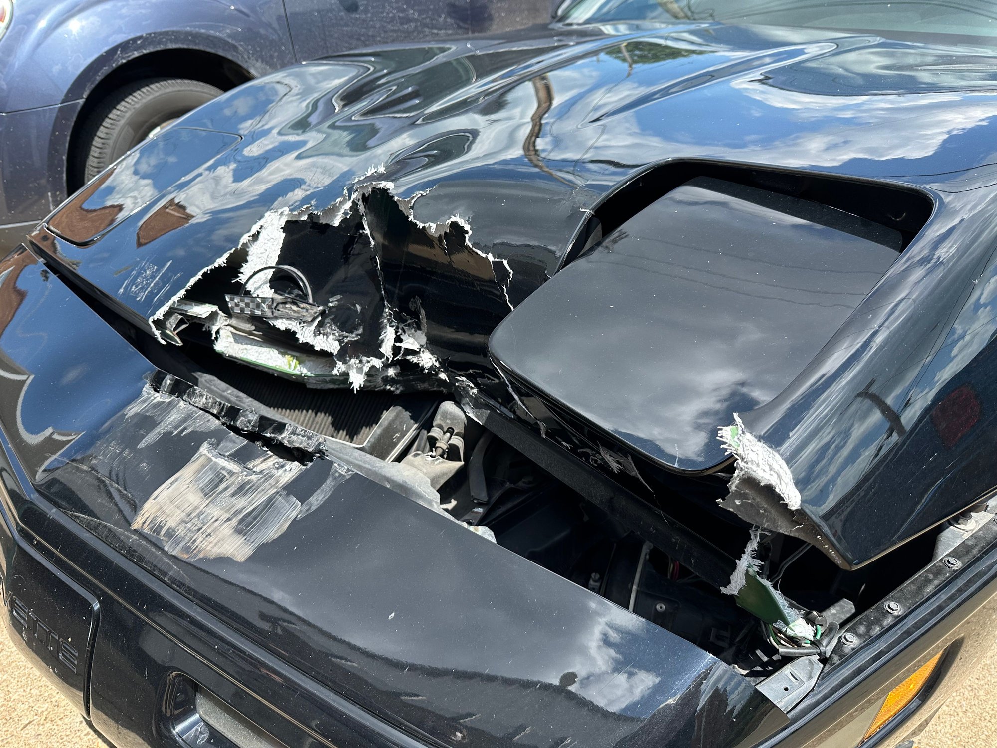

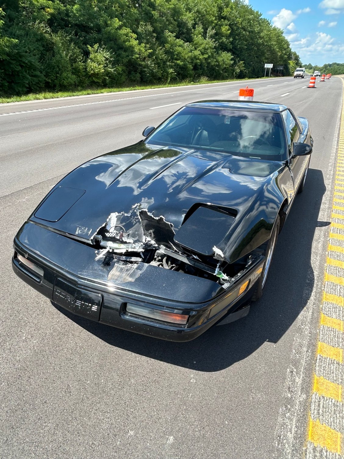

OK, So I bought my 17 YO son this 1993 6 Speed coupe so we could enjoy our cars together. Yesterday he was traveling on the expressway when the person in front of him hit the brakes hard due to what he thought was a construction vehicle entering the left hand lane. My son stuffed his 1993 under the bumper of THE 2500 Silverado and as you can see the hitch receiver crushed the front of this 1993. Thankfully no one was hurt, except for my sons love for this car.
As you can see in the picture I took i think its hit pretty hard. Once i got there to I was understandably upset so I took a picture, picked my son up, called a tow truck and left. So I don’t know what the underside of the hood engine bay looks like.
A little about the car though. 1993 Coupe, 6 Speed, FX3, Dual Roofs, 115K Miles. Really clean vette.
Please give me some feedback back what am I looking at, full coverage through State Farm.

If you avoid an insurance claim I'd say very repairable. Conversation with insurance won't be pleasant.

As already mentioned it can be repaired but if you claim with insurance they will total it. I had damaged the hood of my 95 It was not to the extent of yours but did require a new hood and also damaged it hinge. I paid out of pocket. It was just over $5,000 including repainting front.

That's a new hood, paint, etc. I would guess it's totaled, insurance won't want to pay to fix that.
Let them total it and buy it back to fix it yourself, it's very fixable, just expensive to do so.

If the Silverado wasn't damaged, and its driver isn't going to file a claim with his company, I wouldn't file a claim with your company. Your 17 year old son doesn't need an accident on his record at this (any?) age.
Fix his 93 yourself. Make it a father/son project. It looks like the bumper barely took any impact, the hood itself absorbed the energy. Keep in mind that the Silverado's rear bumper was elevated because he was braking too. The Corvette mostly under it. Very low energy was transmitted to the frame, so probably no frame damage. There is probably only minor, if any damage to the core support, air cleaner assembly, ect. You've already located a hood and headlights. It looks like you'll need a bumper cover, although you may be able to repair that one.

Now, onto the car. The first thing I would do is to remove the hood and headlight assemblies as one unit. Look for any damage to the engine itself and to surrounding things such as the air cleaner, radiator, radiator shroud, wiring, etc. This will determine the extent of rhe damage and from the picture posted, I dont think it will be terrible. If I were in your shoes, I would definitely fix the car. Keep us updated on what you end up finding.

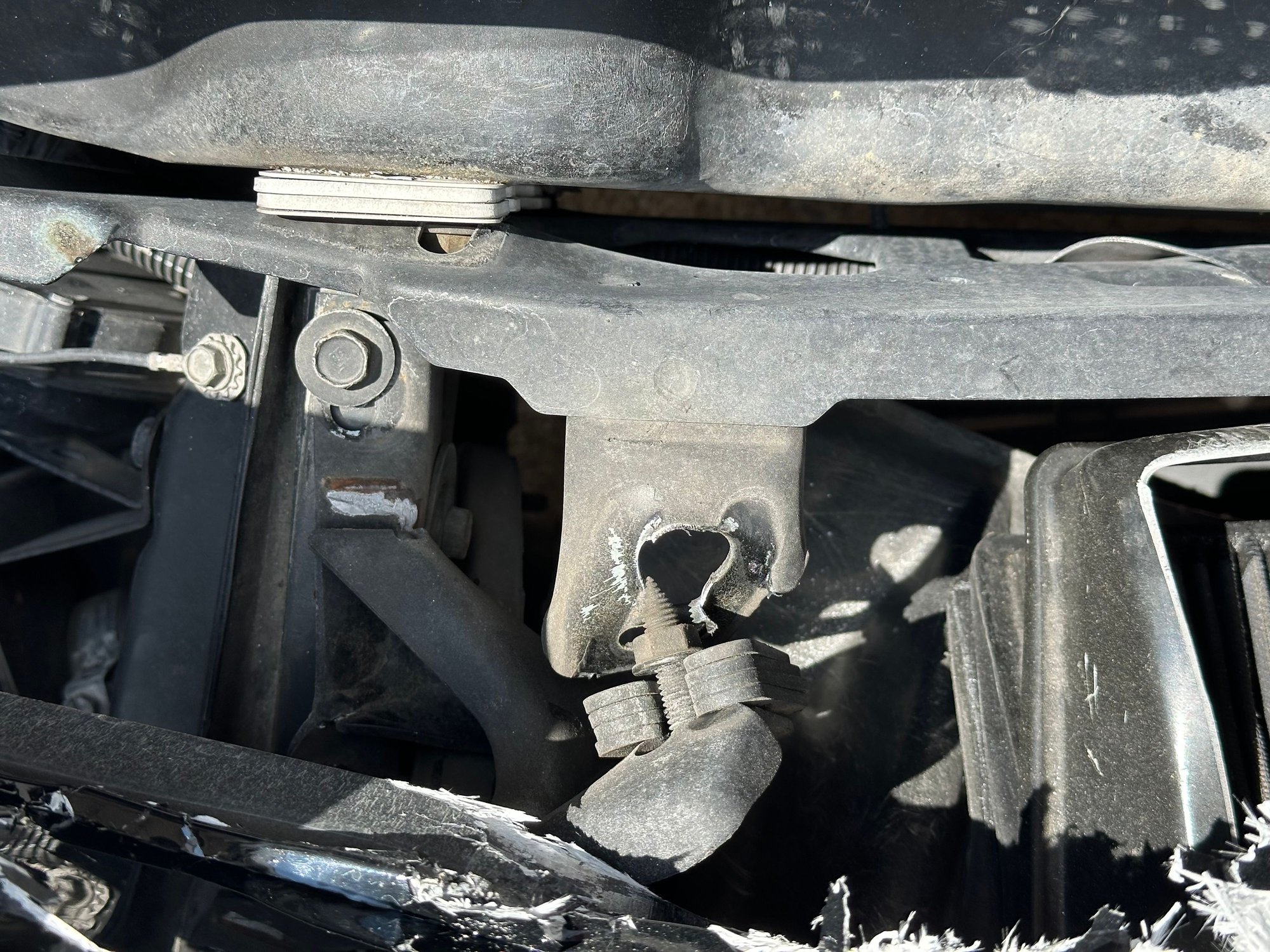

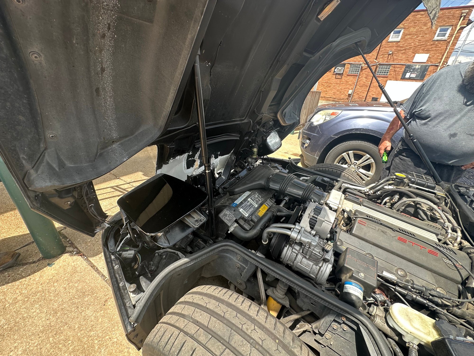

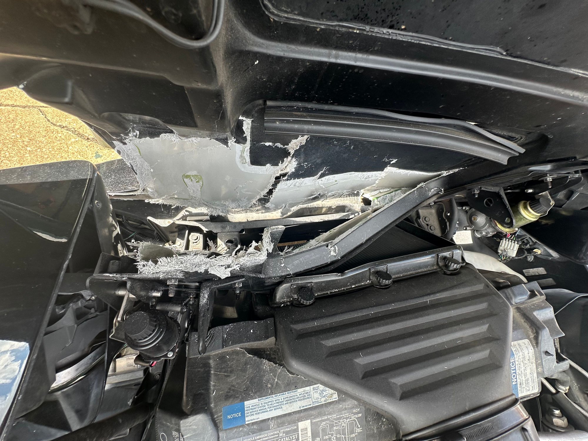

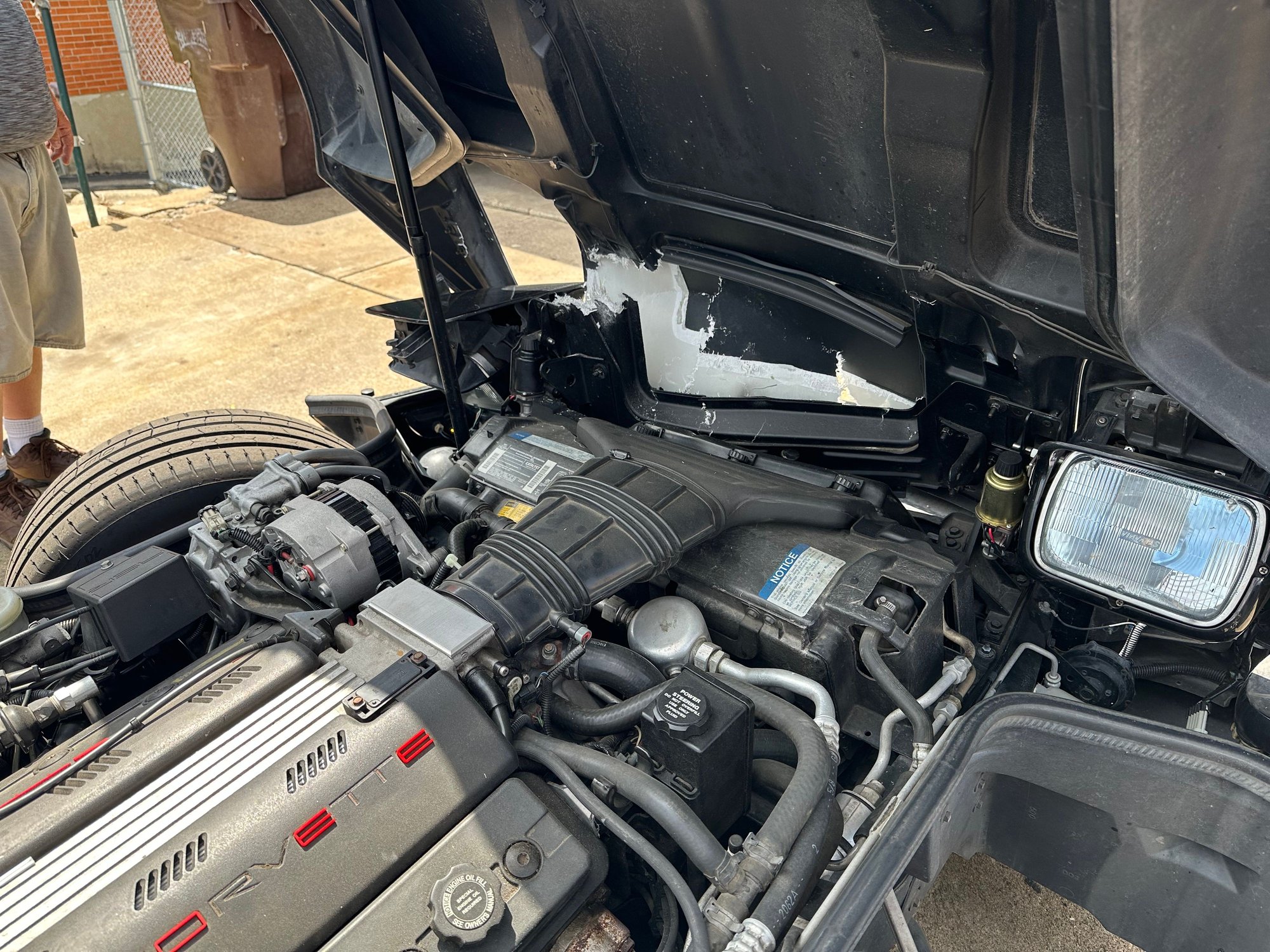

Thanks for everyone’s opinion. Here are some additional pictures. The truck involved only received a scratch to the receiver hitch. Kentucky is a no fault state so no one was cited and if the truck owner wanted to file a claim he would use him insurance and we obviously use ours.
There is no engine damage, radiator is not leaking, and I don’t think there is any frame damage. I guess I will not know the true extent of it until we start to take it apart. I have already started the claim process but to this point I have paid for everything out of pocket. I will continue to do so until I know what State Farm is going to want to do. I look it like this, I have been with SF for 15 years everything I own is insured with them with no claims. By my math that is about 125K worth of insurance. I think they are going to survive this claim. Regardless, I just don’t want it totaled; I don’t see a totaled car however I sure they will.
