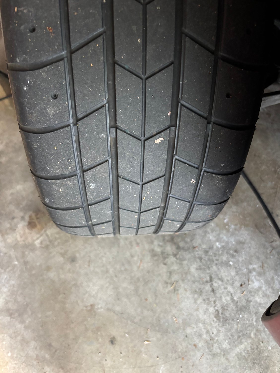

Only if you have the base 8.5" wheels. Z51 handling option means 9.5" all the way around on an '85, so 245's will be too small IMO.
I went with the Toyo RA1 255/50 r16 because my '84 has the 9.5" wheels in the back. The rears lasted over 13K miles and the fronts are still looking good.
I just replaced these rears with another identical set.
These still have a lot of life in the front.
