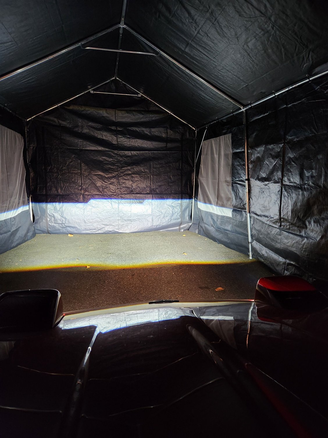

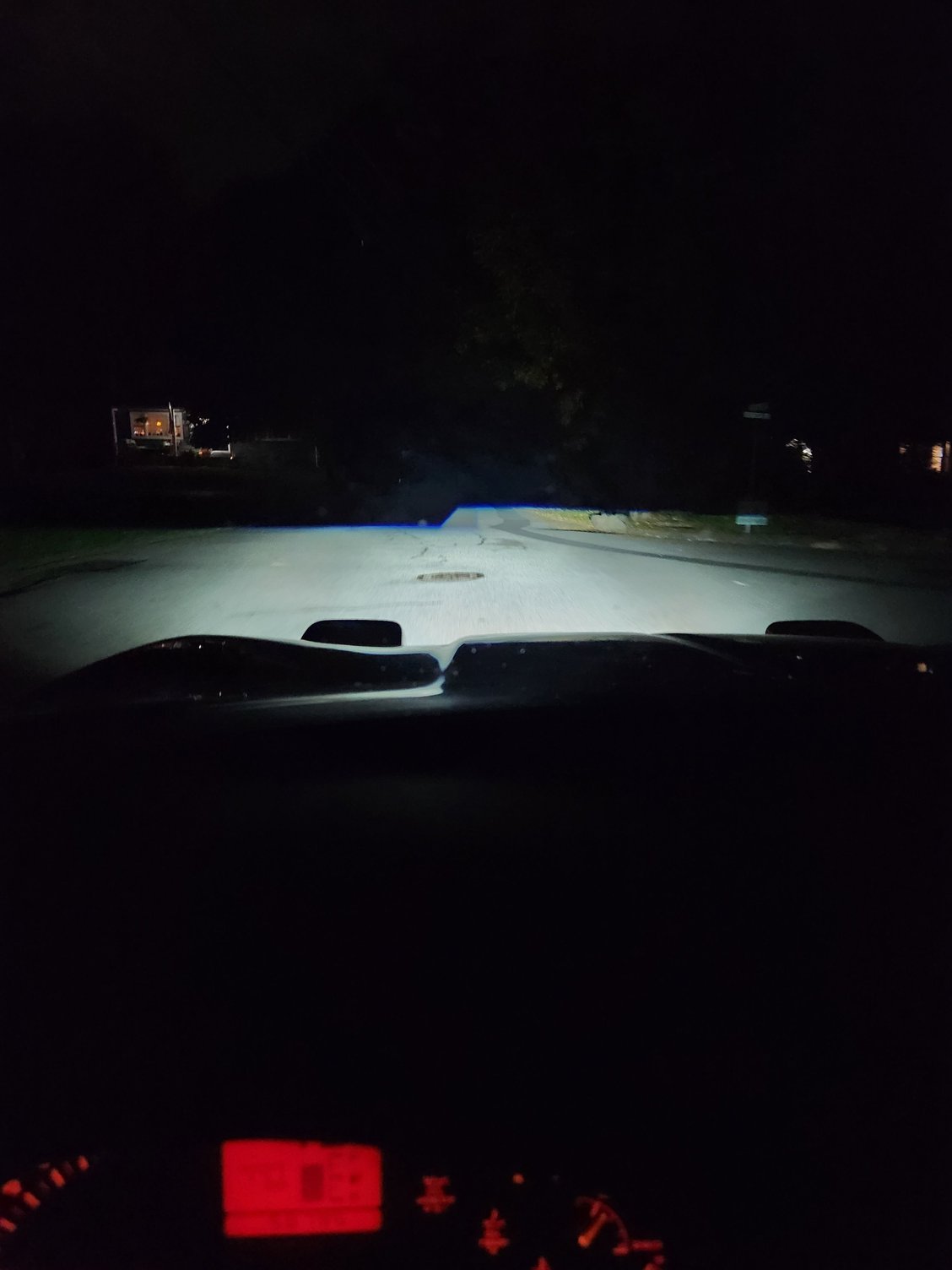

2024 C4 of the Year Winner - Modified
I've got the HWStar "2025" LED projector headlights. HWStar LED headlights from Amazon
They're just as bright as my 2018 VW GTI's factory LEDs:
