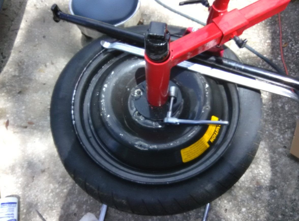

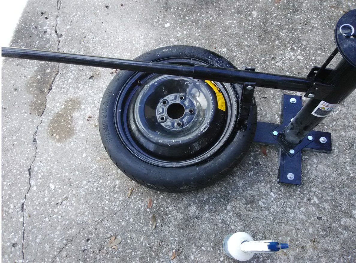

I attempted to dismount the spare 88 vette tire today with the Harbor Freight tire changer unit....ohhh, about 3+ hours later, the tire looked up at me and gave me "the finger"! ...(grin)...
I watched a few vids before I bought the unit and it was straight forward...HOWEVER, all the tires I saw "dismounted" were of a "full size" and not the spare...

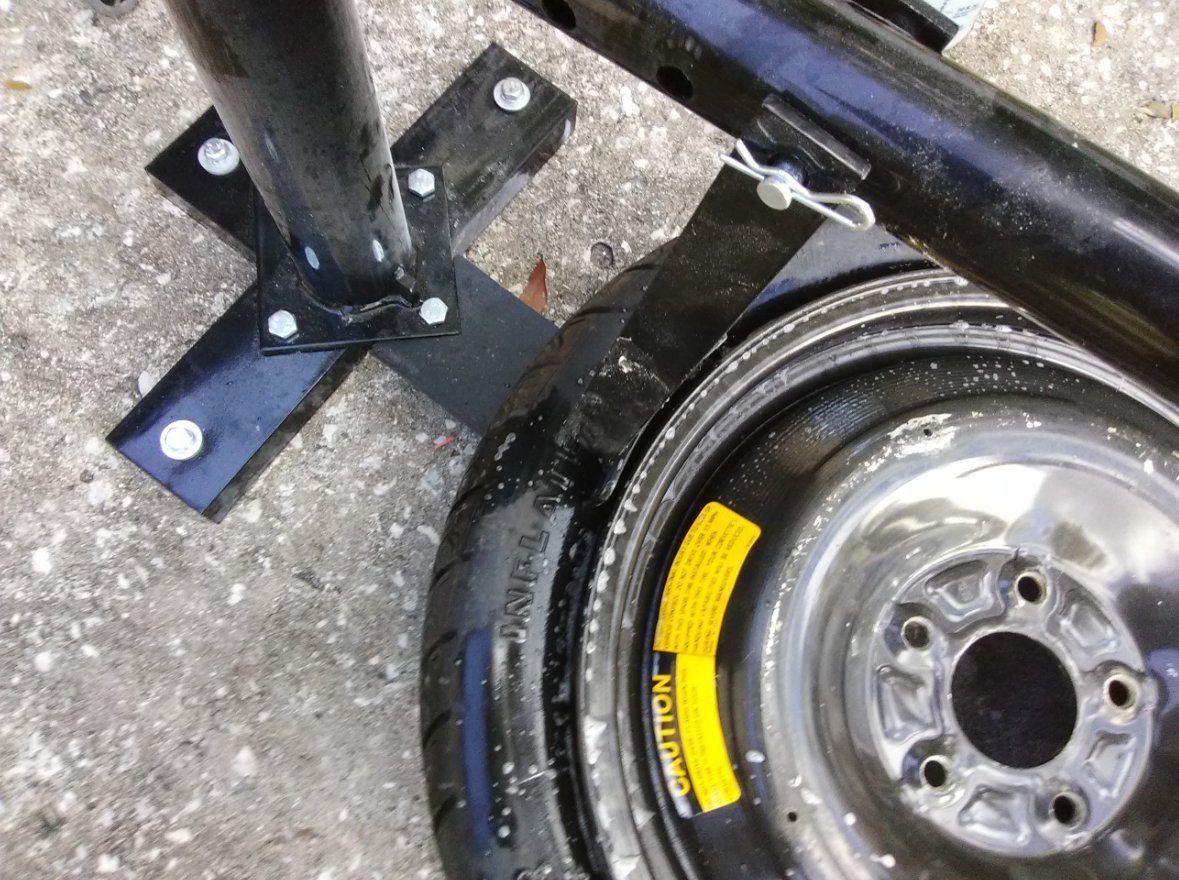

Breaking the tire off/from the bead /rim was simple enough. I purchased the "duck-bill" attachment which dd very little if anything at all...
It was VERY difficult to get the "tire lip" over-onto the duckbill and after doing that, was unable to rotate duckbill attachment around the rim...
I suspect that the age of the tire may have something to do with it along with the thick(?) sidewall and it's inflexibility...
Anyone have this problem with this device?

The only issue is the "toughness and inflexibility" of the age-old tire!...I thought that I was starting to bend the tire tool/spoon (silver - seen in picts) at one point.......
Getting the bad tire off of the rim is one thing but, surmise that I will have difficulties with the "new" tire to go back on the rim in it's place.

I have the old vette spare tire as pictured and, have another tire/rim combo in garage....I want to remove 88 orig vette spare tire from rim (as pictured) and replace with tire that I must take off rim in garage...
The rubber of the spare on BOTH spares is very hard and inflexible and I think therein is my problem....It would NOT matter if new or old tire.......I could cut the tire off but, I could NOT do that to the replacement tire I hope to put on........
