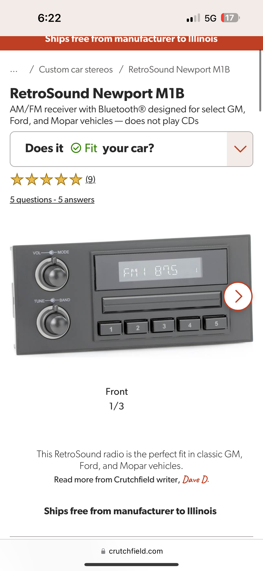

This one looks nice
https://www.classiccarstereos.com/co...8aAg1SEALw_wcB
Retro sound has a funch of radios on crutchfield but they all look like 60-70s to me.

This one looks nice
Retro sound has a bunch of radios on crutchfield but they all look like 60-70s to me.
That's much better. Crutchfield also has some radios intended for trucks that have a similar look but they are a little short on some features.
I agree the retro sound stuff appears suited to older American cars. If I had to replace the radio in my truck they'd look right. But the '98 Jetta is definitely not an older American car.
