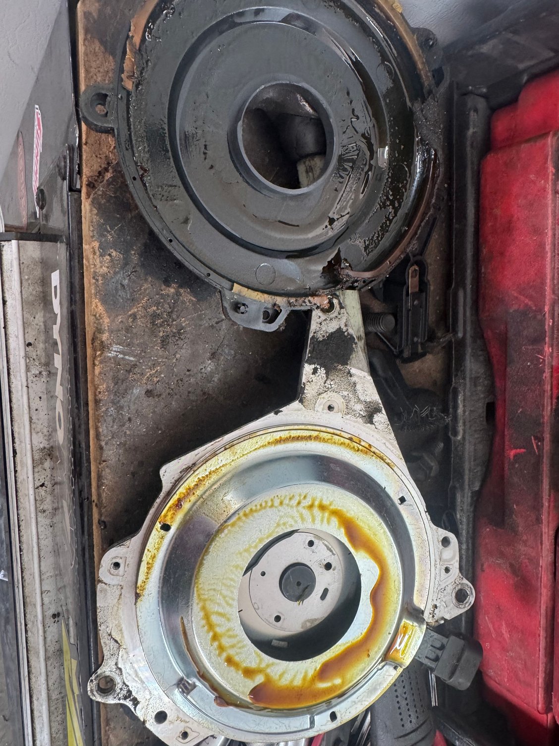

Pulled my Opti today, anyone ever seen this goop covering it?
Old Sep 1, 2025 | 07:00 PM
Polo Vert's Avatar
Polo Vert
Joined: Mar 2013
Posts: 697
Likes: 162
From: Huntington WV
Chinese boogers.....

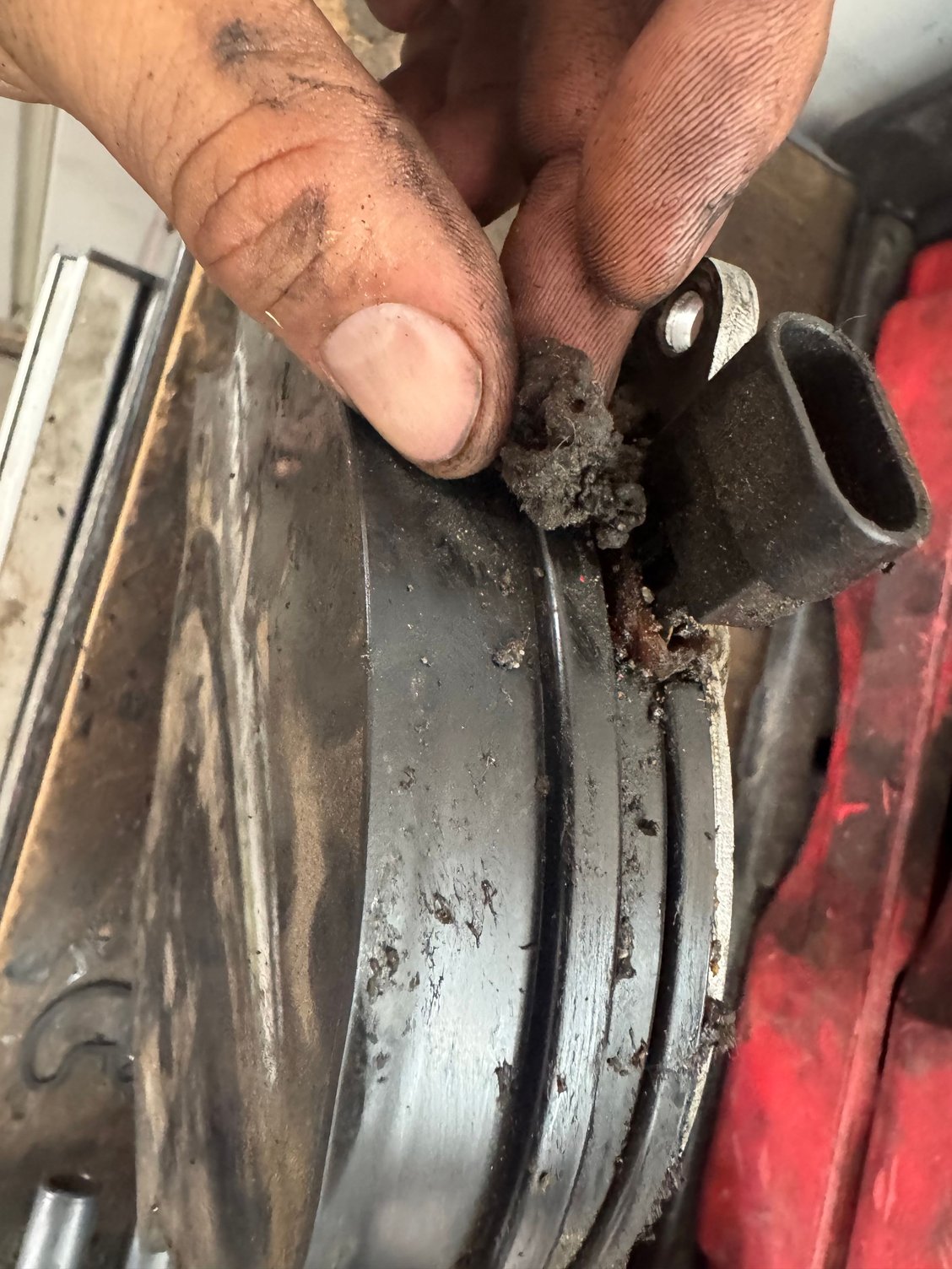

May have found my Opit issue
Old Sep 4, 2025 | 07:41 AM
MatthewMiller's Avatar
MatthewMiller
Joined: Aug 2015
Posts: 6,085
Likes: 1,972
From: St. Charles MO
Sorry for the late reply. Yeah, looks like you have a leaking seal behind the Opti. There are videos on YouTube for how to replace that. As I recall, there's a little tapered tool to help with it.
Old Sep 4, 2025 | 08:30 AM
Whaleman's Avatar
Whaleman
Joined: Mar 2017
Posts: 4,188
Likes: 1,307
From: LeClaire Iowa
You need the tool if the leak is at the water pump drive seal. You do not need a tool if the leak is at the opti seal. Dan
