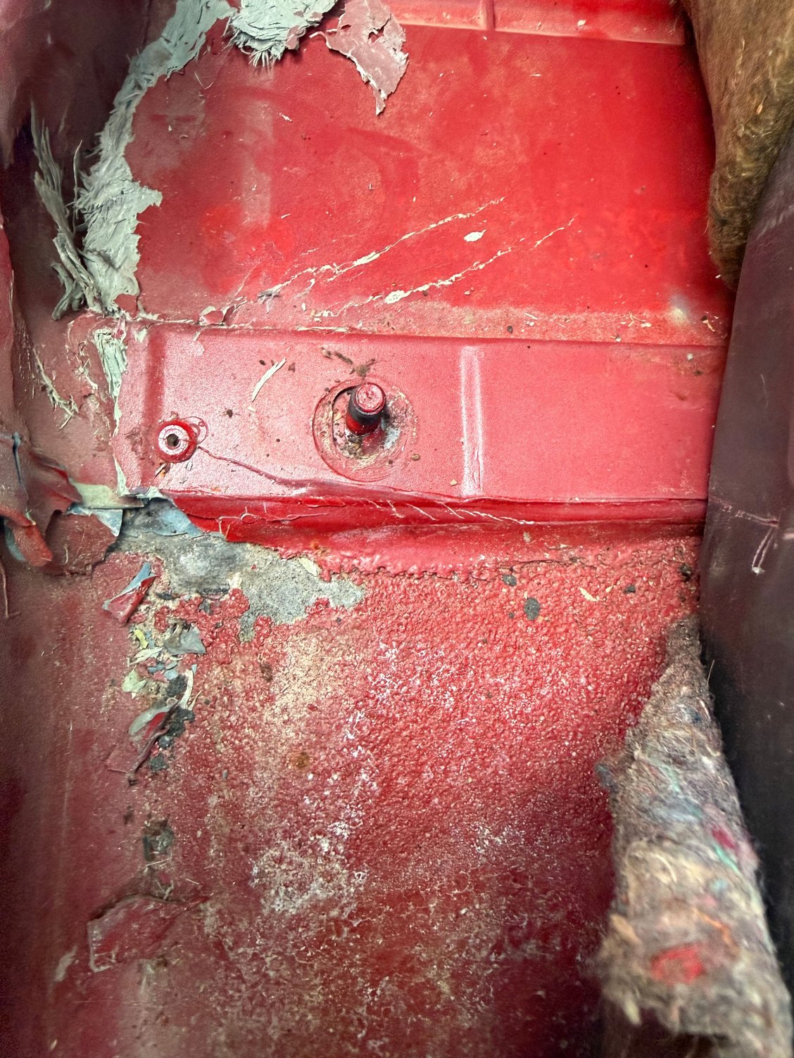

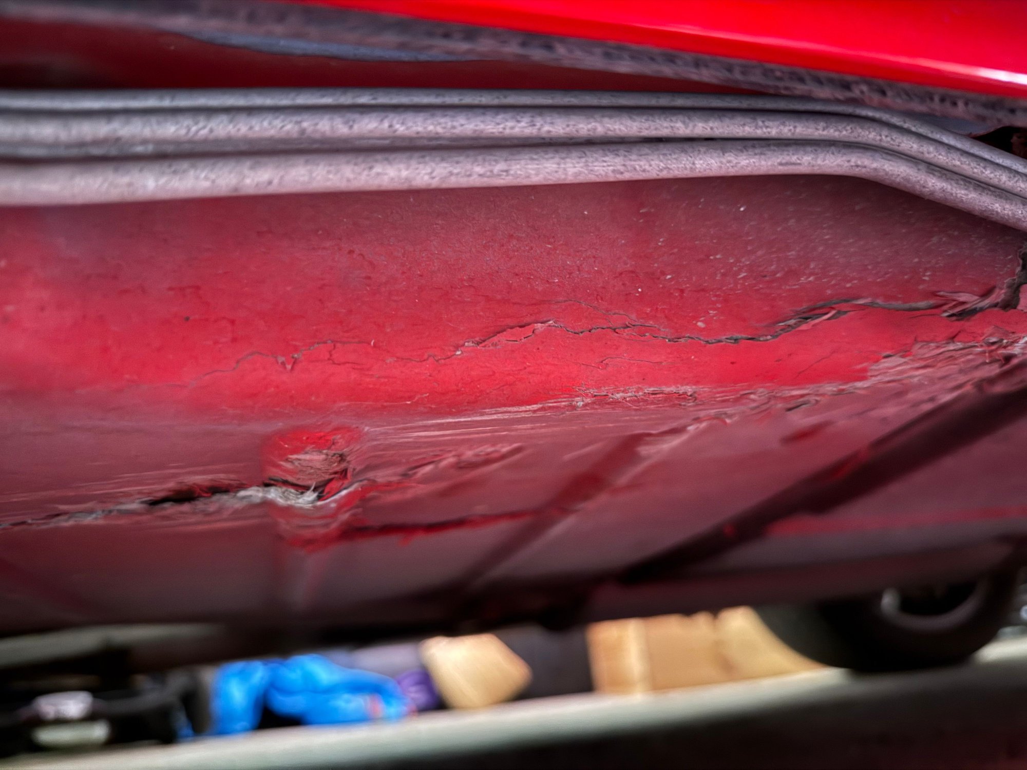

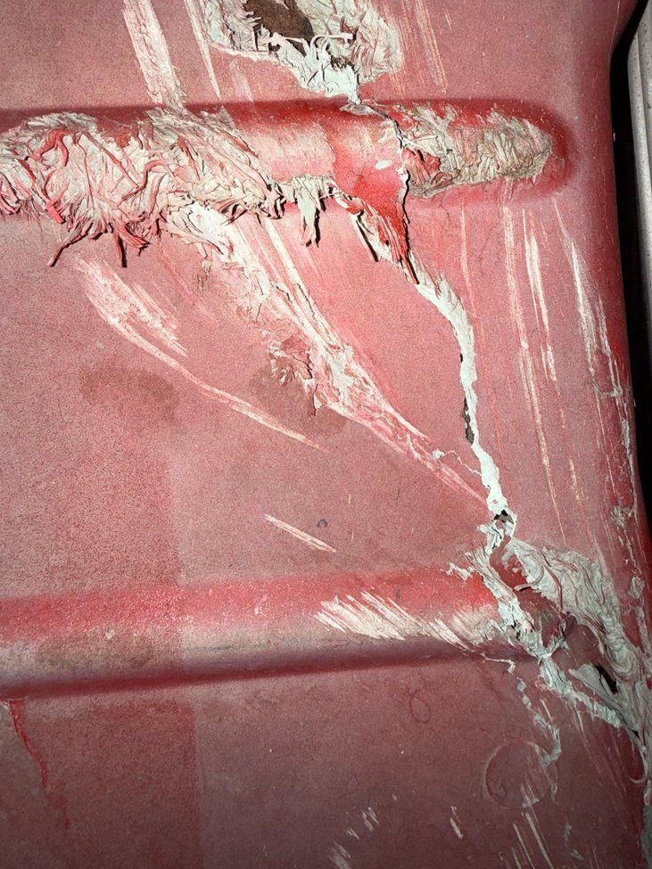

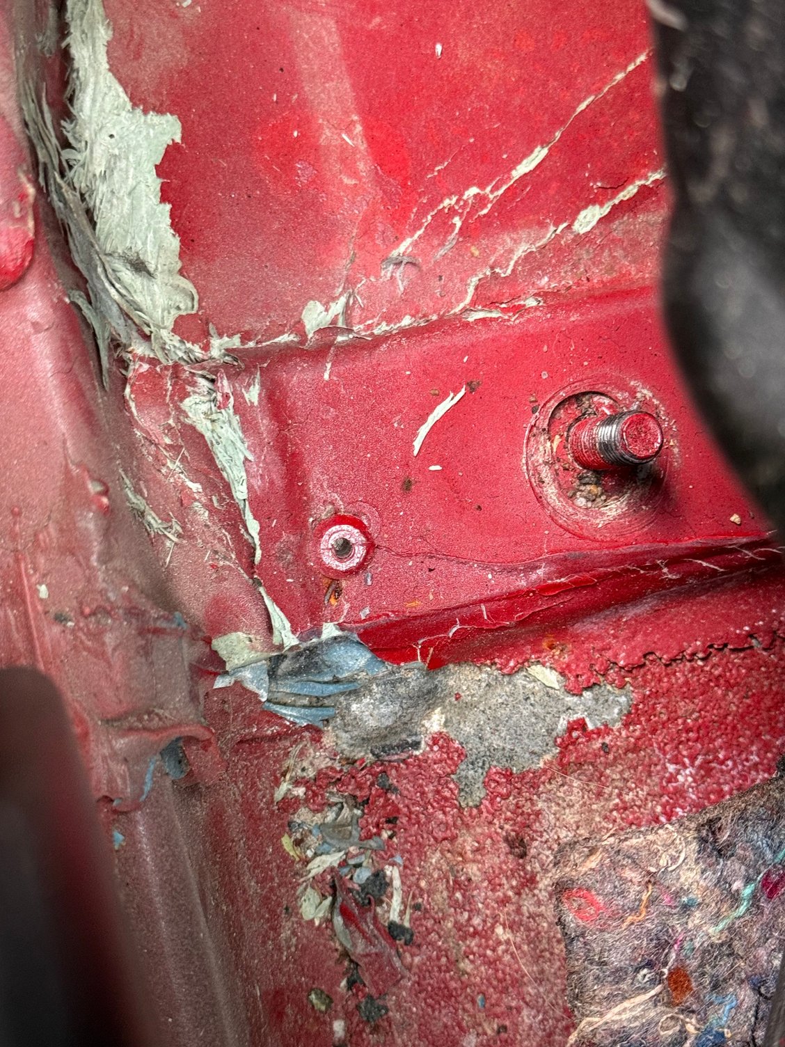

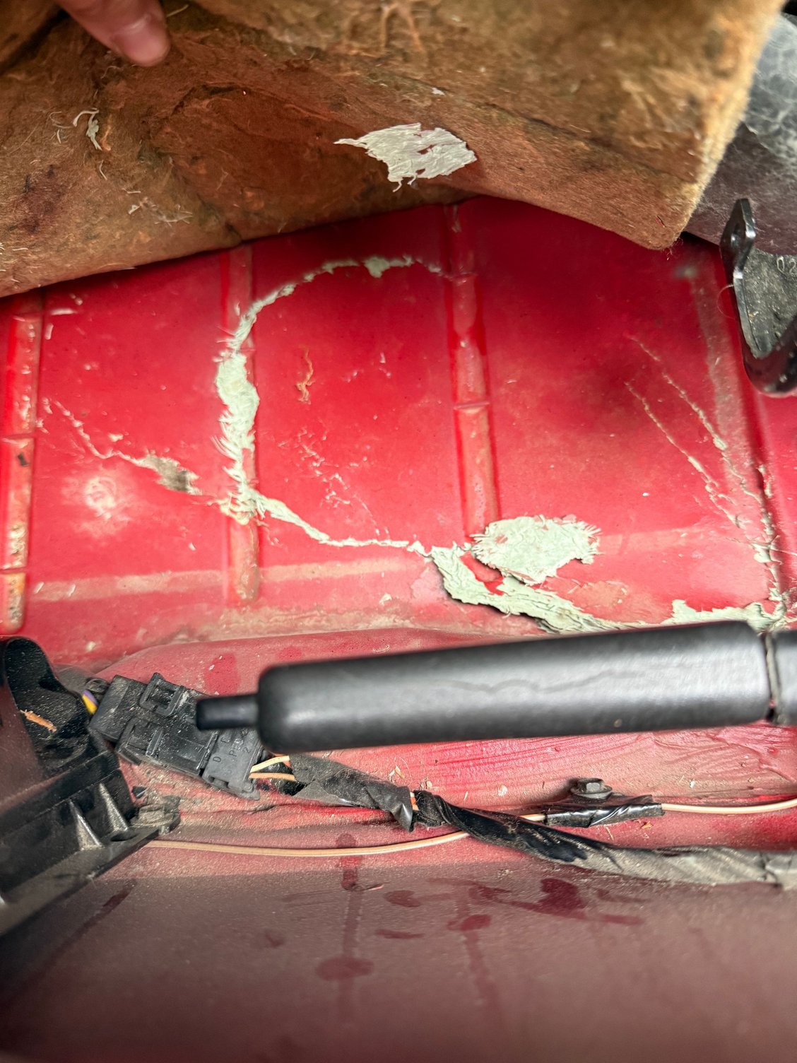

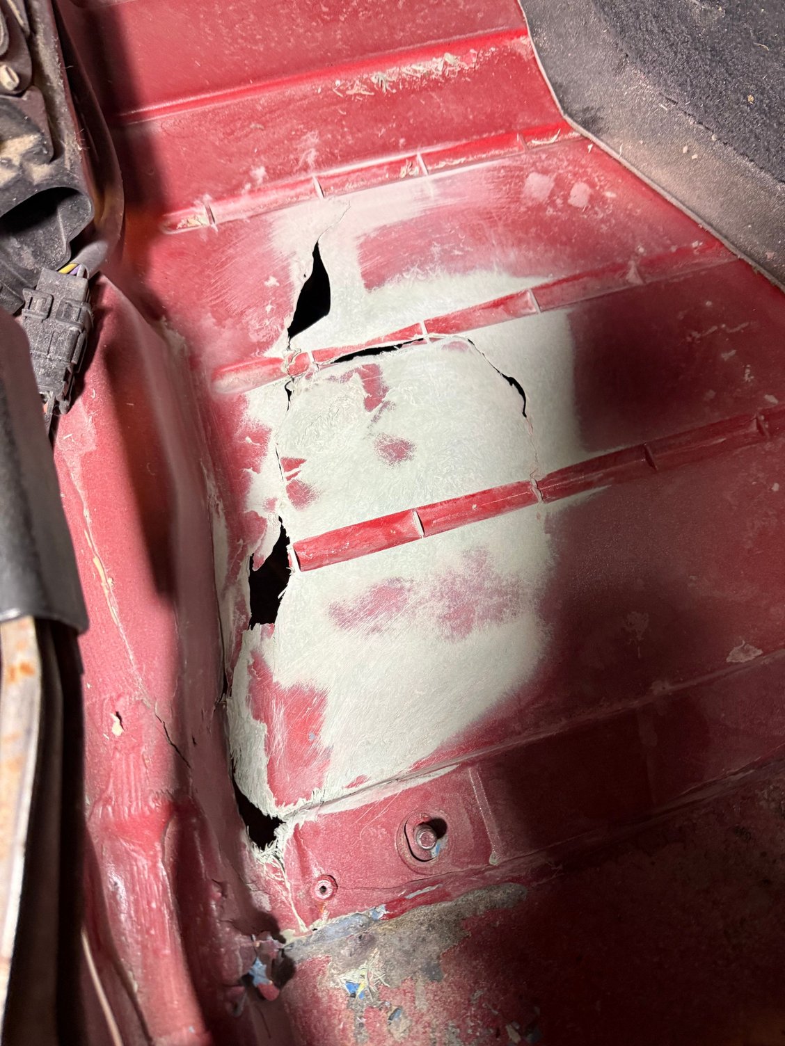

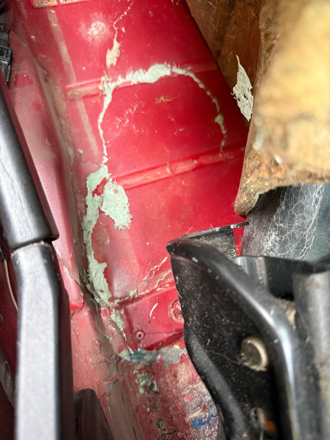

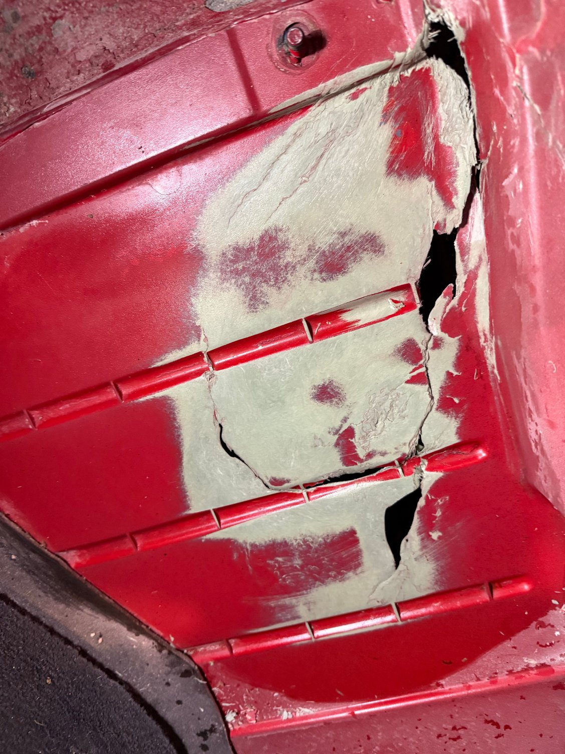

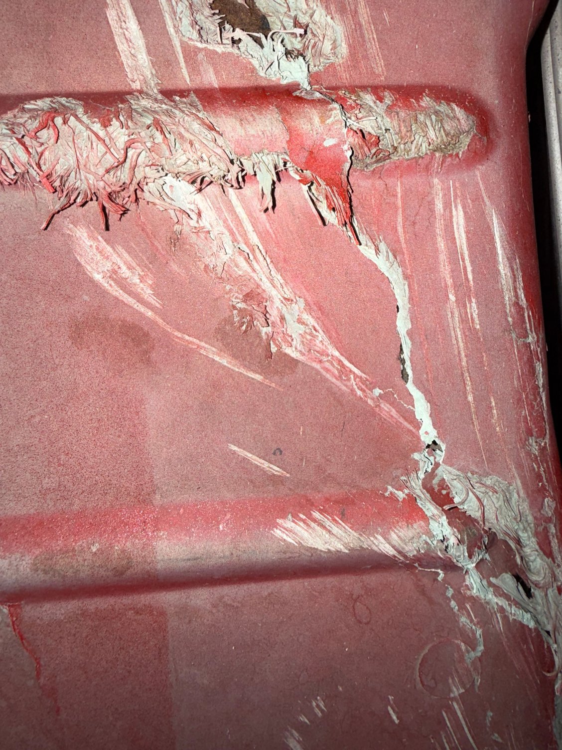

I just discovered this damage to my 94 (not enough due diligence on pre purchase). Does this damage impact the mounting point for the drivers seat? Thanks for the info!

Looks like it just involves the fiberglass floor pan maybe from someone trying to jack car up in wrong spot. You can pretty it up with some glass patches but as is won't affect the seat mount.
from improper jacking.
This damage was not caused by "jacking". The car drove over something. "Jacks" don't leave longitudal scrape marks as shown in the pics. Large rocks will.
"Jacks" don't leave scrape marks.

Id say you are right on that. To be honest i didnt see that shot underneath.
Same fix advice. You could ad some *epoxy compatible* matt or woven material for strength but ive found as long as you get the topside and bottomside application to meet, ive dound the panel adhesive epoxy is halla strong.
Also, i also remembered that i started BOTTOM side first and held it in place with tape. Smooshing it up through the crack wherever possible. This way i didnt get air trapped.

I feel that floor repairs are a prime opportunity to try/learn "vacuum bagging". You need some additional supplies such as butyl tape to seal the perimeter of the bag to the floor, the plastic for the bag, and peel-ply that goes between the bag and the laminate to absorb the excess resin. For these simple, small repairs, a shop-vac would supply adequate vacuum. You should use an epoxy mix that gives at least an hour of working time, especially for beginners to the technique. The beauty of vacuum bagging is a nice, tight, no-voids laminate with a smooth surface. After it cures, peel the bag and peel-ply and you're done.
Hopefully, I'll never have to do any floor repairs. For a small crack, the epoxy in the crack is fine. For the damage in the OP's pics, plus to restore integrity to the seat mounts, I'd want a couple layers of lammy in addition to just a crack repair. But that's just me.

My 95 was the same Fiberglass really isn't that hard to work with It's just messy just repair it with fiberglass.

I am curious how this turns out, the original owner of mine did the same on the RF floor pan.

Wanted to update everyone on this thread. I was able to complete the repair. I used a SMC resin and fiberglass mat. Took about 4 hours and a heat gun.
