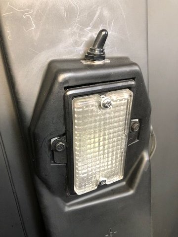

I put a hardware store switch on each light with new LED bulbs. Dan
I want this on my 93. Can you share some details on this. Wires are not my strong suit
Old Oct 7, 2025 | 10:04 PM
jlbruggeman's Avatar
jlbruggeman
Joined: Jan 2001
Posts: 1,135
Likes: 23
From: Joplin, MO, USA
Pretty simple-cut the hot (probably red) wire to the light about an inch away from it. The switch has 2 wires coming from it. Put one wire from the switch on each side of the switch wires.to each end of the cut wire. The switch shuts off current to the light. Solder if you can, and use heat shrink tubing.
