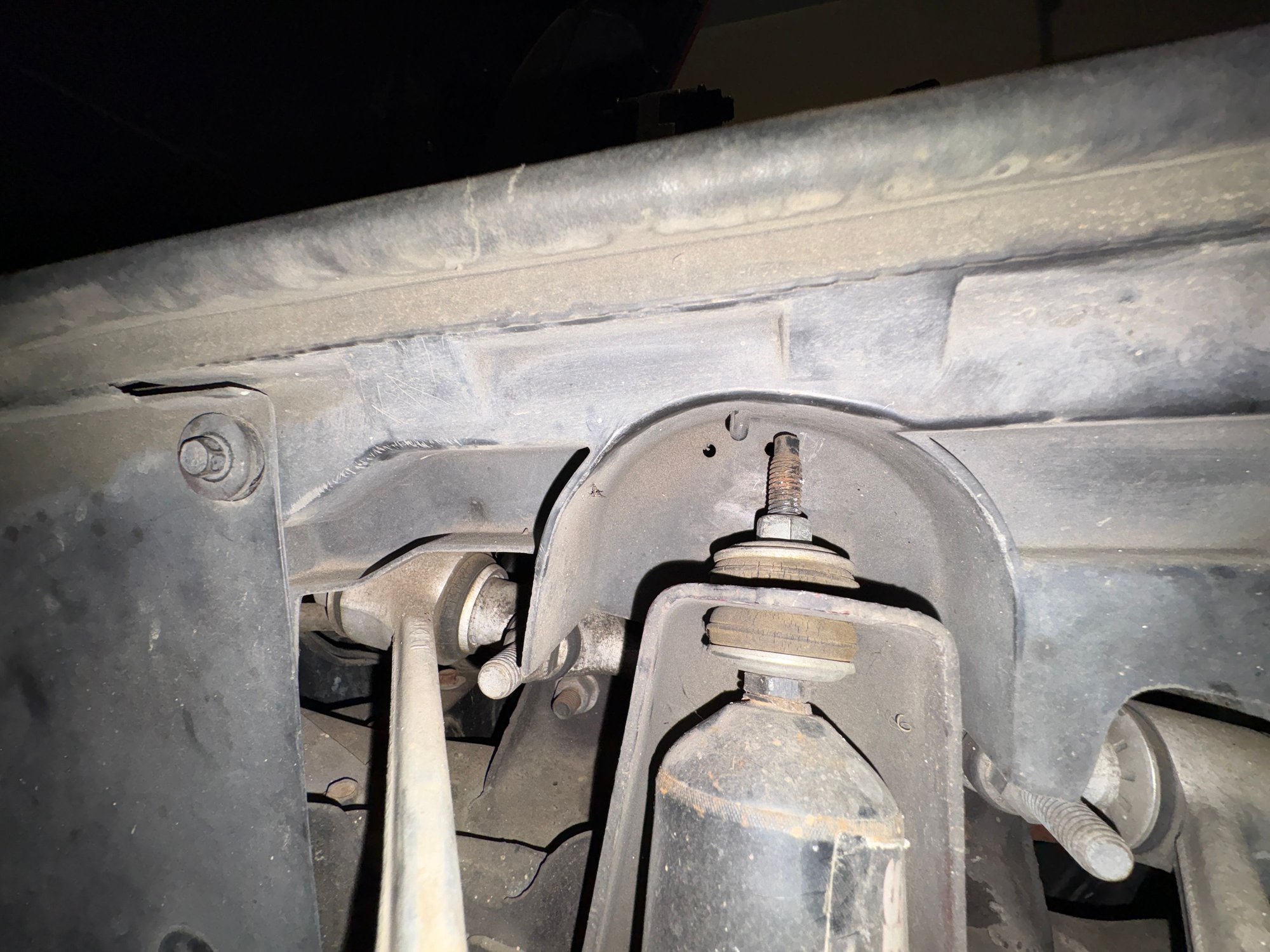

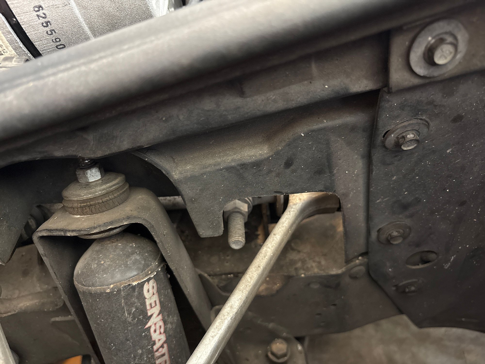

I’m attempting to replace the front struts on my 1985 corvette, but I can’t access the top nut because of a bracket in the way. I was wondering if any other owners of an ‘85 have ran into this issue, and how they might’ve gotten past this. I feel like it’s worth mentioning that I’m a first time owner so I’m still learning.

Ok, I am a bit confused. There is an Upper Control Arm, Lower Control Arm and a shock. What part are you having difficulty with?
There is a bracket (maybe a shield I don’t know)
on the other side of the well that is keeping me from getting to the top nut on the strut.
You have to use the open end of a box wrench.
I can’t get the nut off, there’s not enough room.
Ok, I think I am tracking now. You can get room by removing the bottom portion of the shock and let the whole assembly hang. The whole shock should slide down as you unscrew the nut from the top of the shock. This will create the room for the nut to come off.
Thank you, would this also be a way to get the new ones on?
Yep. Slide it up, install the bushings, spin the nut on and let it all hang.
This worked, the new ones are on and feel much better. Thank you
