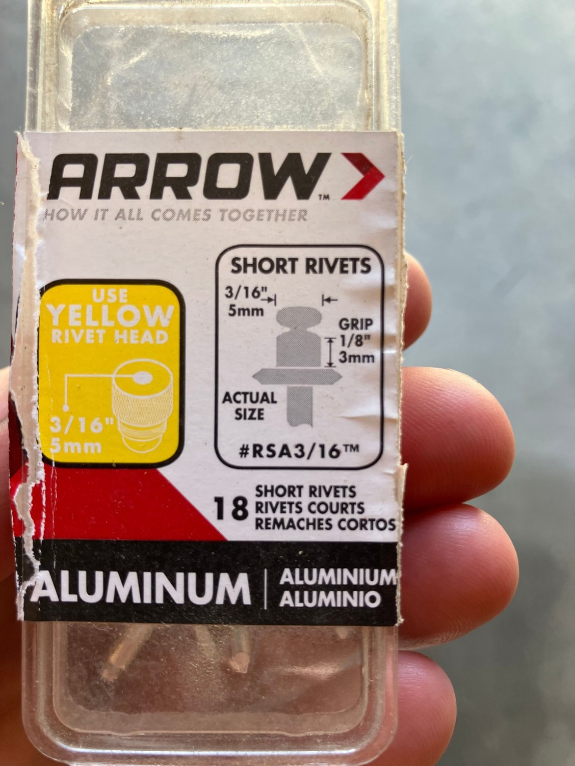

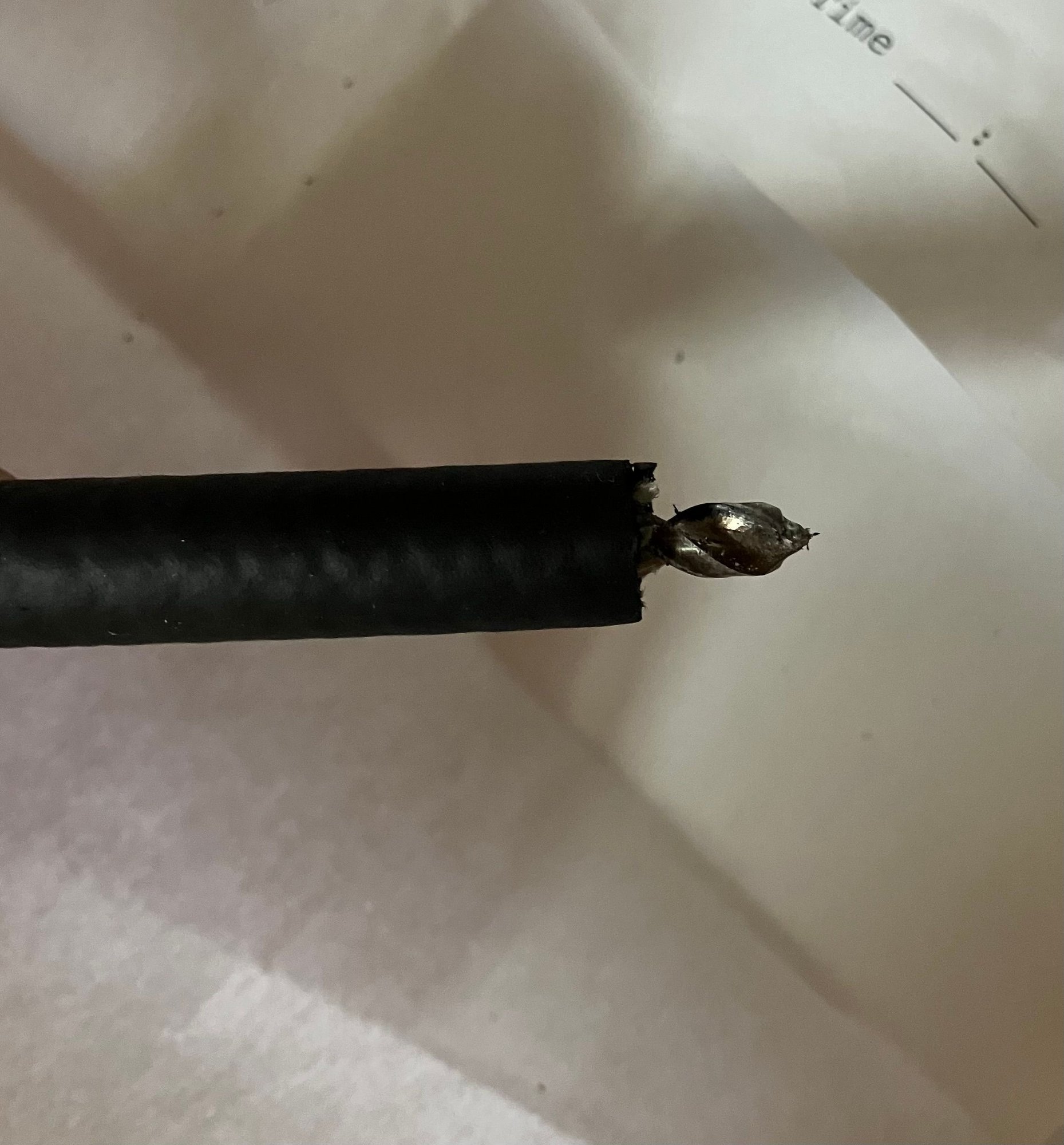

I've done this both inside and outside door belt molding on both of my 96's now.
I drilled out the three rivets with a 3/16 bit. I cut a piece of vacuum hose and left only 1/2" of the bit exposed. This is called a bit stop.
Once they are drilled out, pull up a bit at a time going down and back along the molding until it is off.
With the new, I placed tape where the clips go (see picture). Then I pressed up and down the molding again so as not to bend it. Once it was on, I used the rivets shown in the last pic.
Take your time, use a little patience and you will be fine.
Hope this helps.
