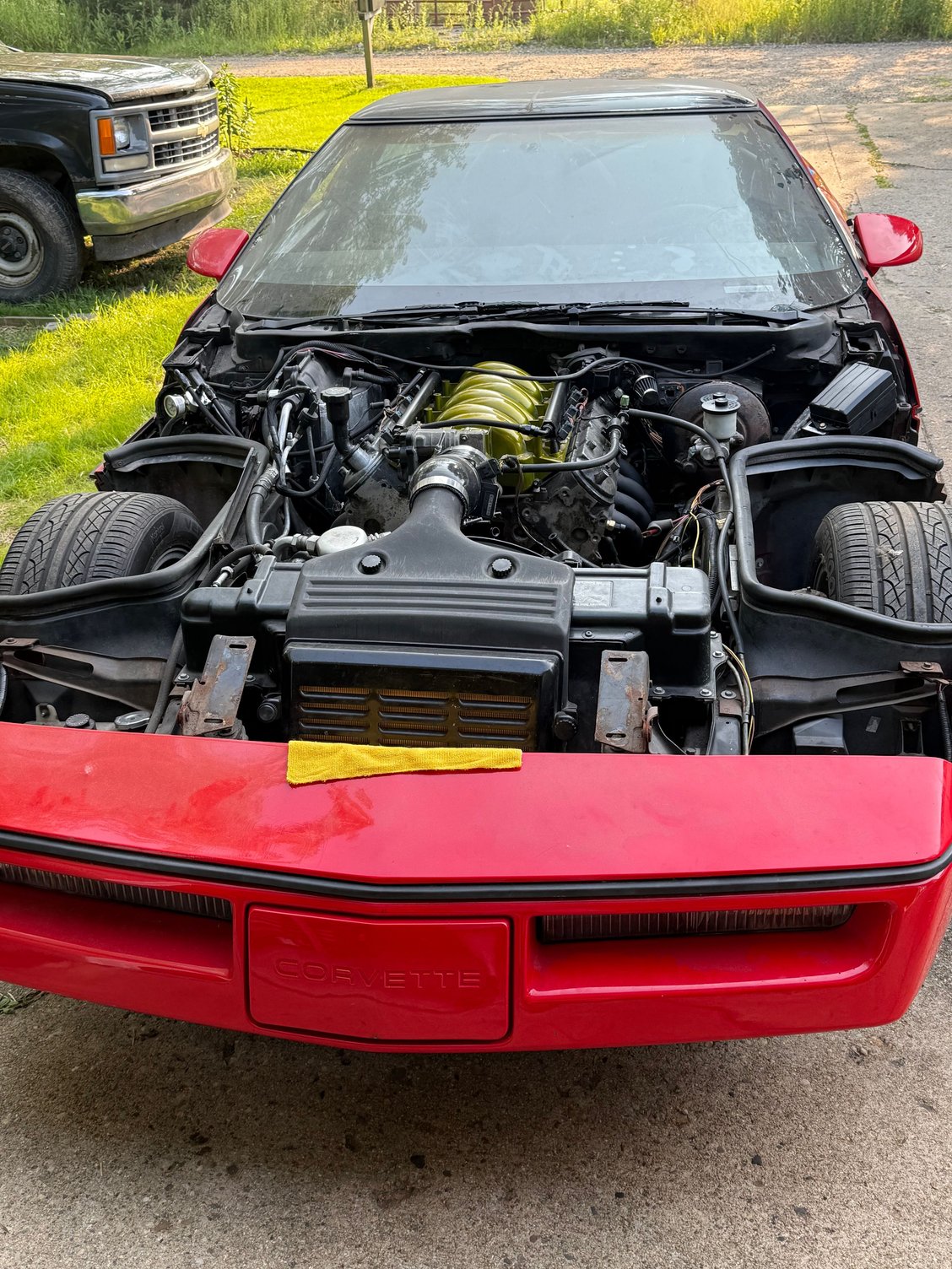

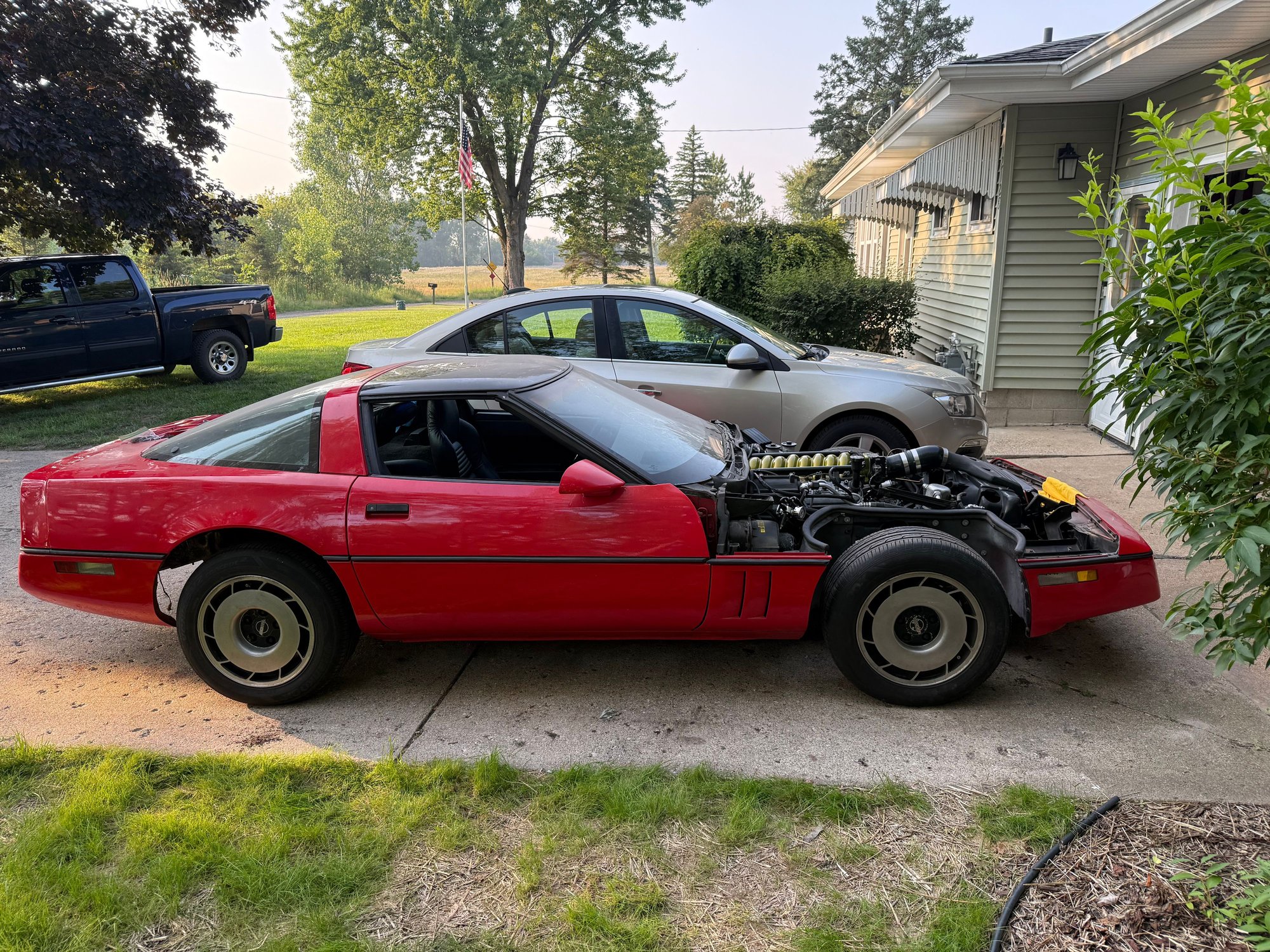

anyone LS swap an early c4? I’m almost done doing my 84. The car was pretty lackluster. Used and abused. Leaked and underpowered. Surprisingly, the car handled well even with every suspension bushing worn out. If you’re on social media, you may have seen my car. I don’t know, just sharing. I’m onto the nickel and dime stuff. I’m finishing the body side of the swap than taking the engine into the machine shop for upgrades

i yanked the 700r4 out and swapped in a 4l60e. Not a hard swap. I used the tail shaft off the 700r4 and paired it an adapter. Using the original c beam unmodified and the stock driveshaft unmodified. I also am keeping ac in my car using the factory style r4 compressor. I did have to modify a ICT billet bracket that was supposed to fit the c4 but did not. As for the dash, I could have sent mine out to be repaired but I didn’t like it anyway. I went with an aftermarket digital unit. I put in a double din radio in place of the switch panel/idiot light display. I installed little led lights under the radio with images on them to replace what I removed. I also retained the factory alarm system. I made my own wire harness and adapted that in with the 84 harness. I’m even retaining the cruise control lever and running cruise control. I can do that because I’m running drive by wire. The computer is mounted under the passenger seat and the cruise control throttle body module is mounted up under the dash where the original computer used to live. All the wiring goes out the original hole in the firewall. Wasn’t too bad a swap to be honest. I also made my own shift shaft lever arm in the correct geometry to ensure the shifter would work correctly and the indicator would land on the right letter. And on top of that, I also LS swapped a 1978 Chevy Malibu wagon. So you are correct, any car can get swapped. Was the c4 an easy swap? Yes and no. If it wasn’t for how tight the car was made, the swap would have been easier.
