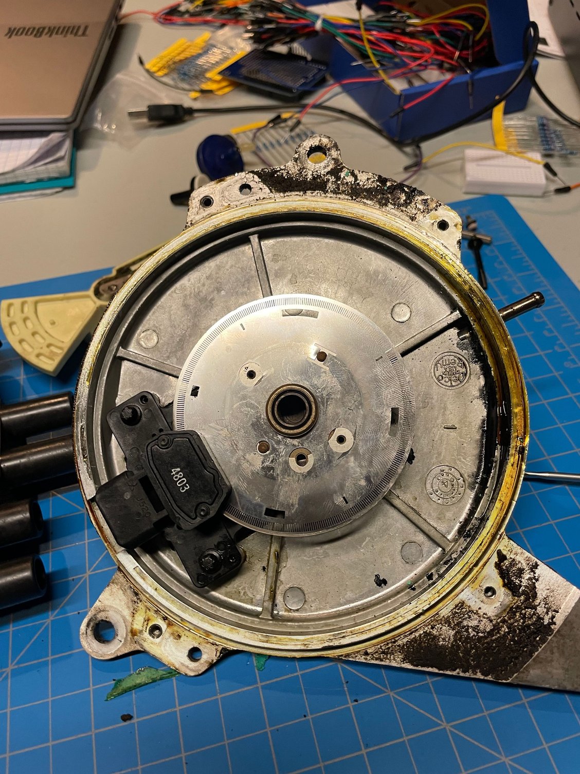

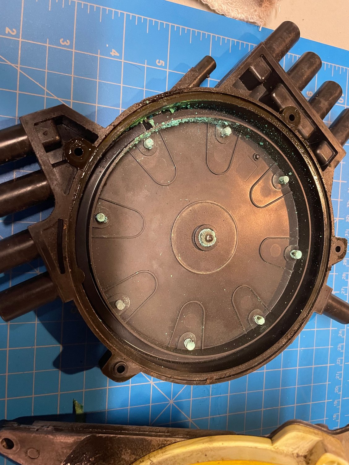

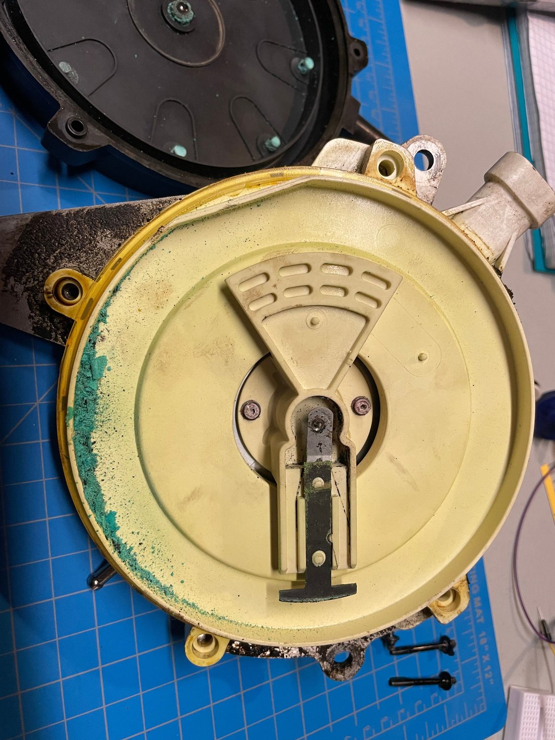

Here is the inside of my 80,000 mile presumably original Optispark. Crazy amounts of corrosion and what looks like blue raspberry Pop Rocks. This thing worked before I removed it, only giving me trouble after several days of rain (I think this was the culprit) The ventilation lines were also destroyed by previous owner, so I guess these things can be pretty robust despite what people say. It is being rebuilt with a new MSD cap and rotor.

Make sure the vent lines and metal tube is open for proper venting. Surely looks like moisture was stuck in cap,with no way to get out.

Verify that the vacuum is really getting to the Opti. The filter between the engine and Opti tends to clog with time.
