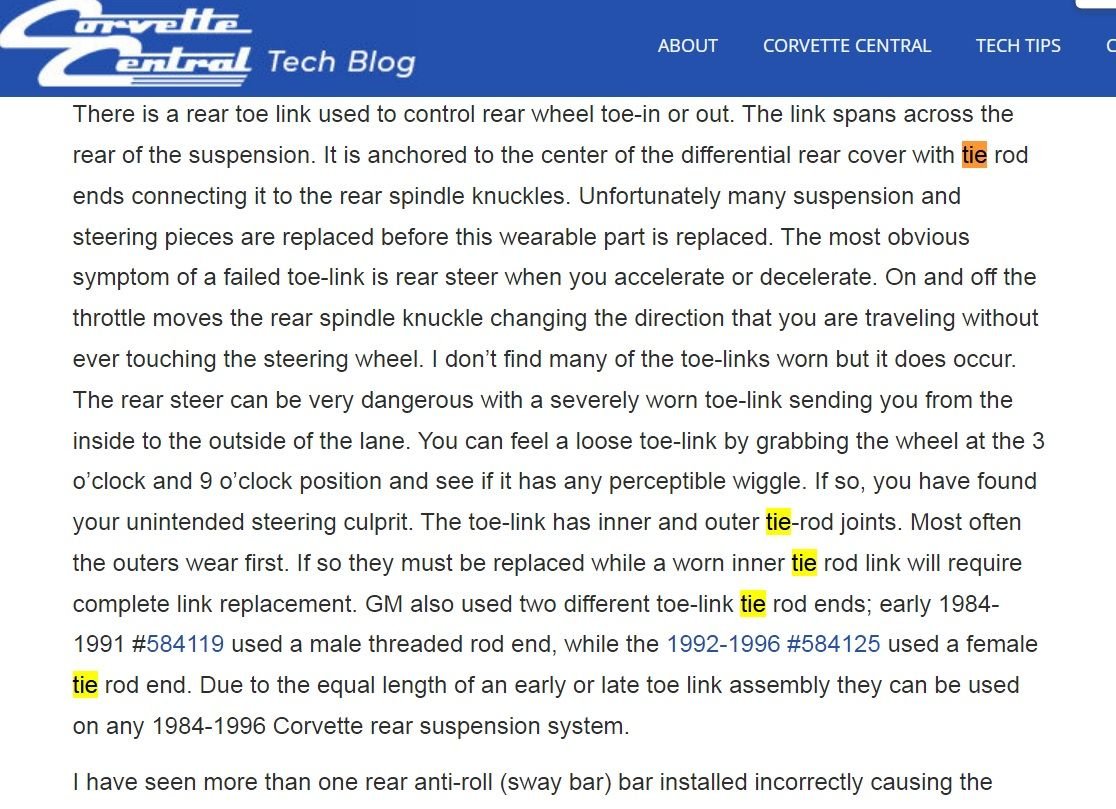

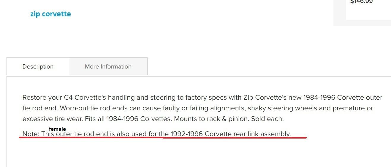

Talking outer ends of course. I believe for rear it depends on the year. I have a hard time finding anything listed as rear accept a couple articles.
https://www.zip-corvette.com/84-96-f...XXk1NYzfMgm3a0
https://tech.corvettecentral.com/201...-installation/
