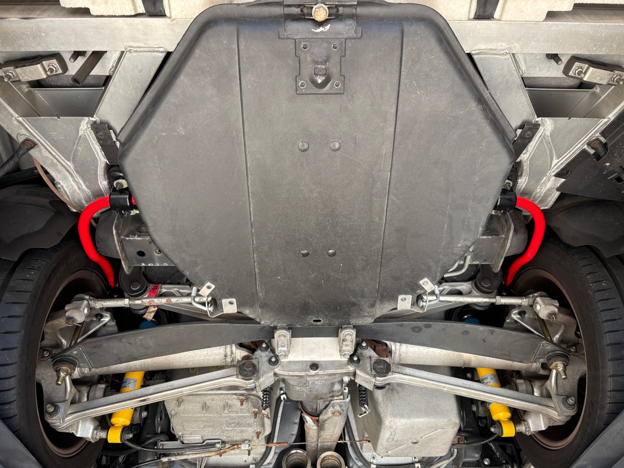

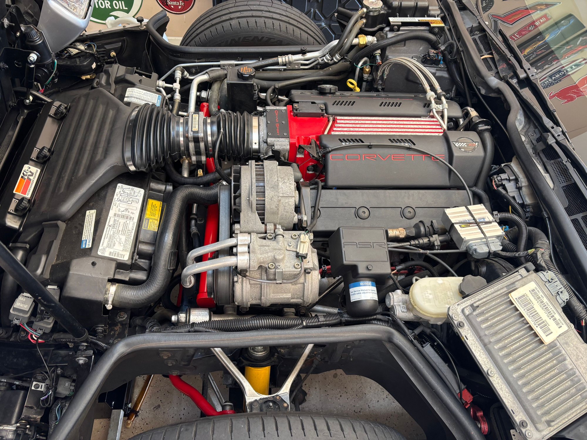

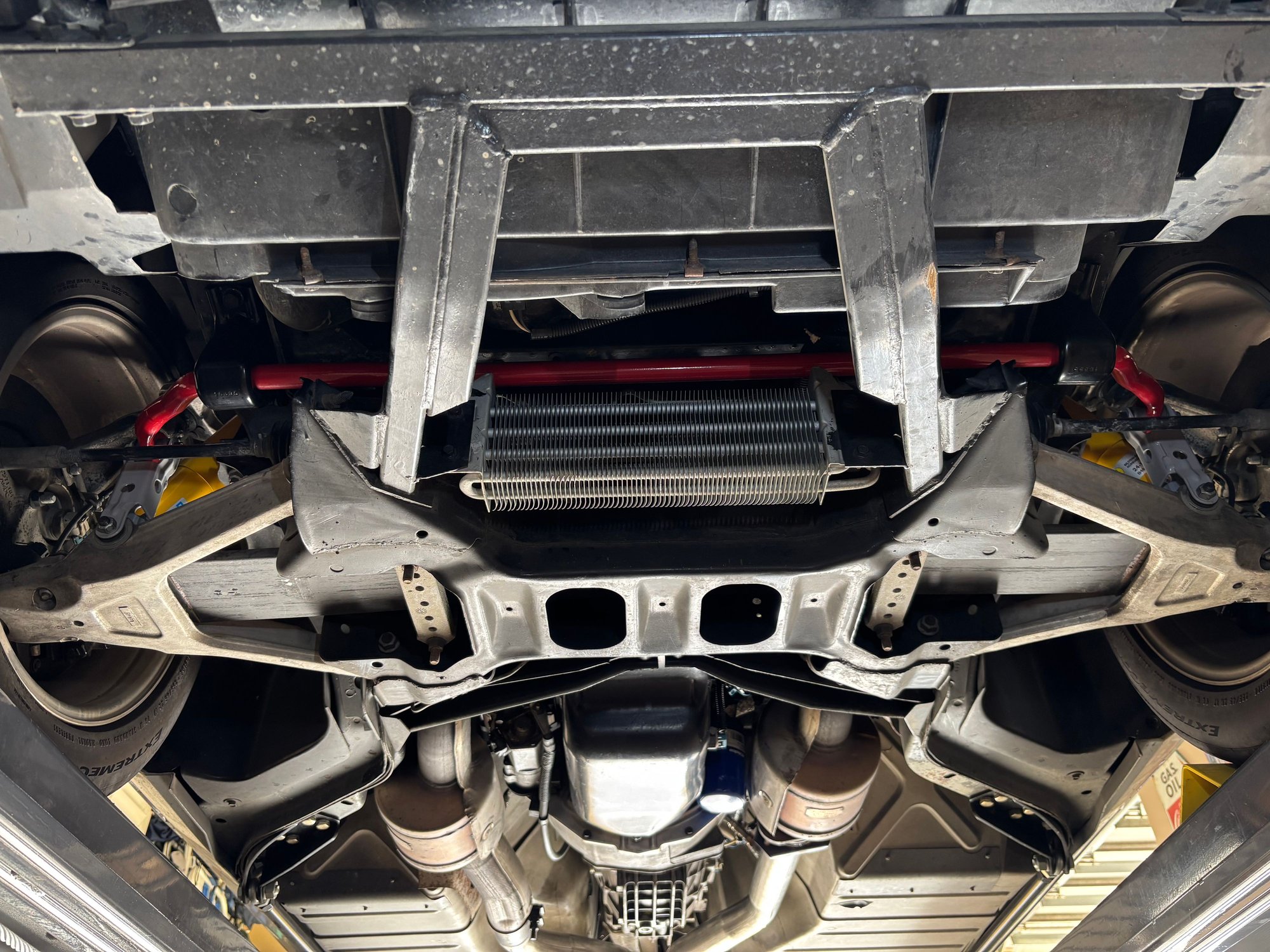

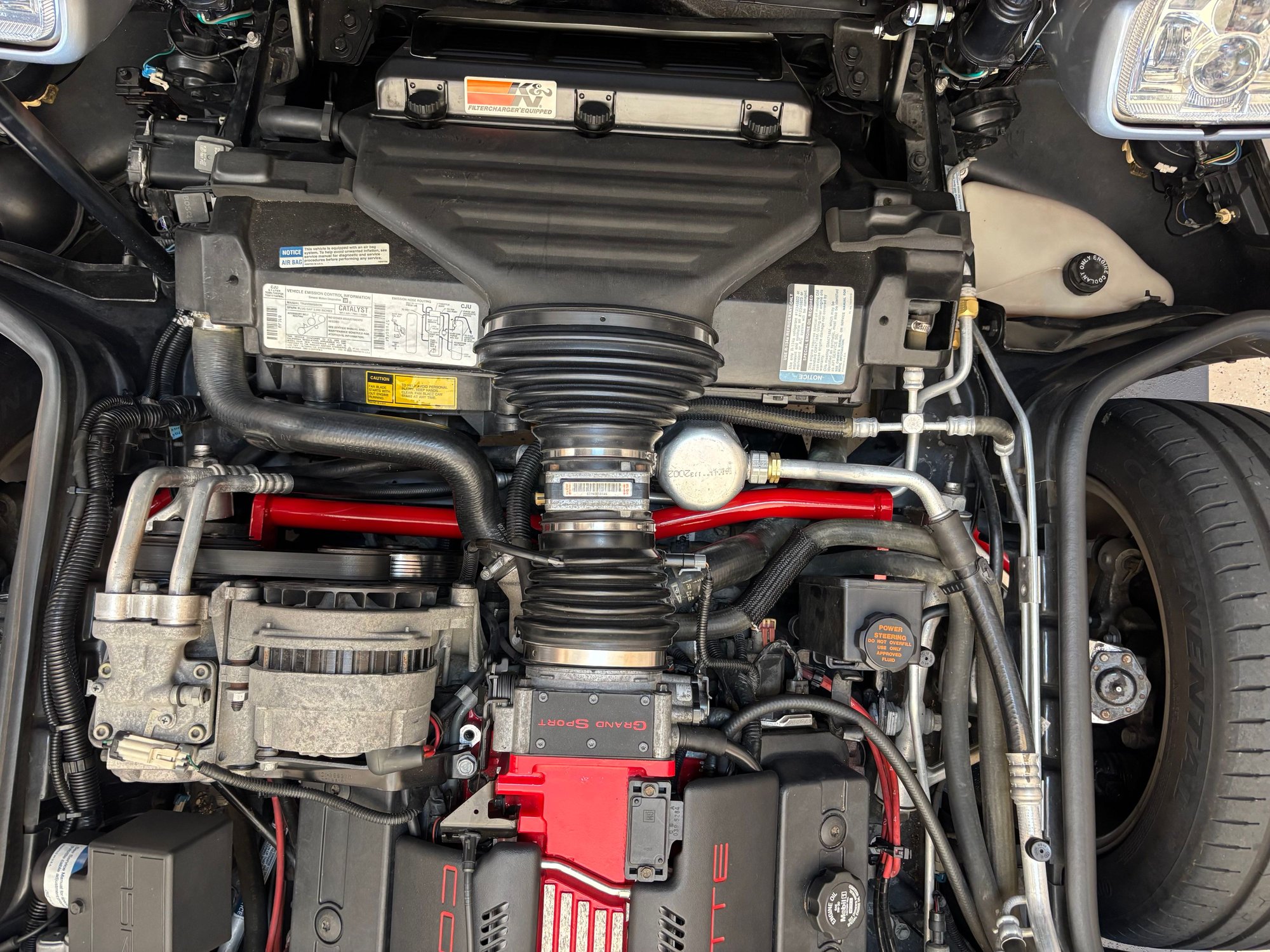

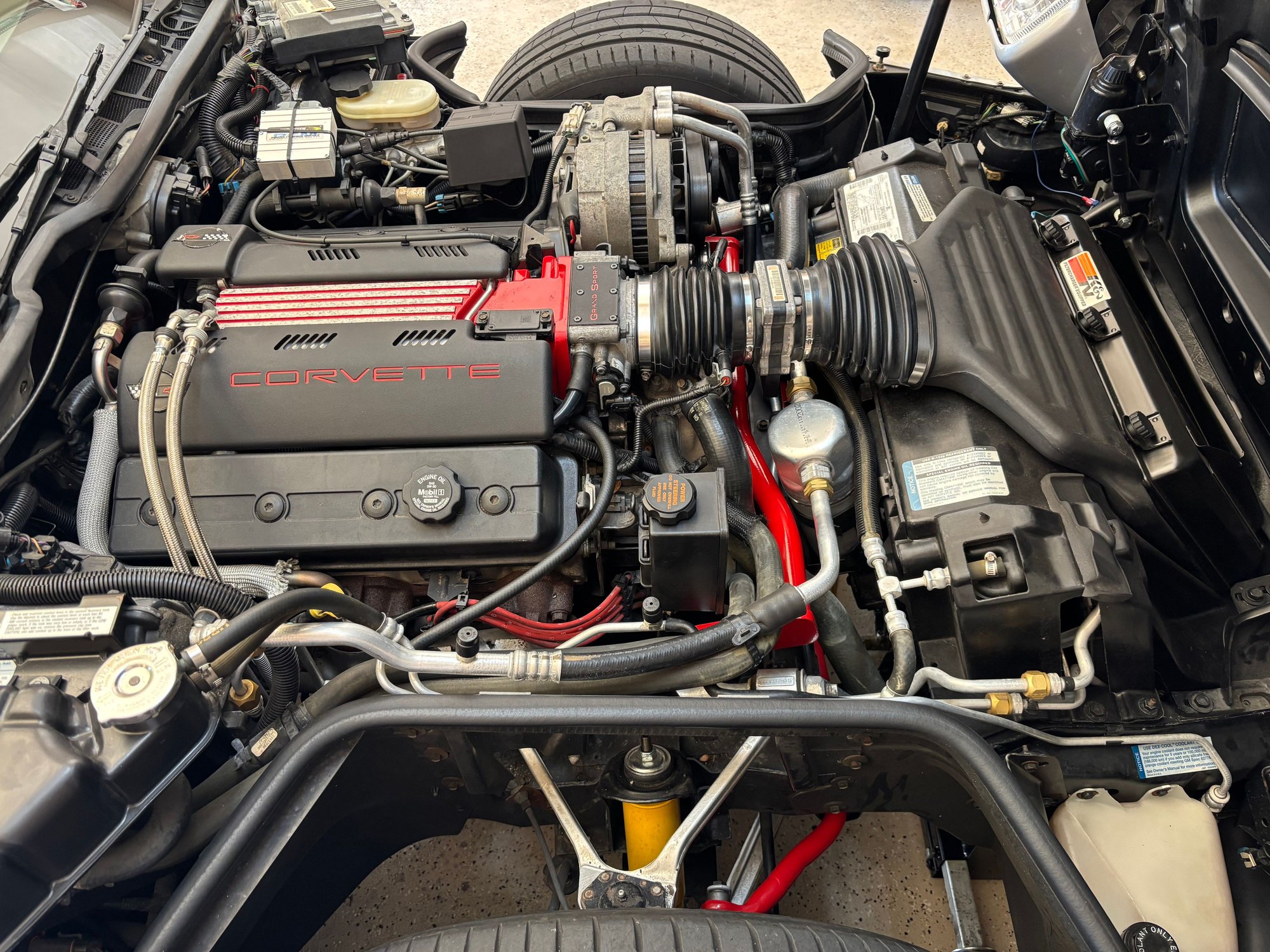

Well, I’m pleased to note that I was able to re-tap that front sway bar bracket hole, insert a new bolt, and it all went well and she’s all buttoned up. Got the newly powder coated Vansteel camber brace installed too, was super careful, taped it up, and actually didn’t scratch it putting it in either! The goal was to accent the LT4’s red color of the intake. Hopefully the pics will show up this time.
View of front sway bar and end links.
From passenger side.
From driver side.
From driver side.
From top.

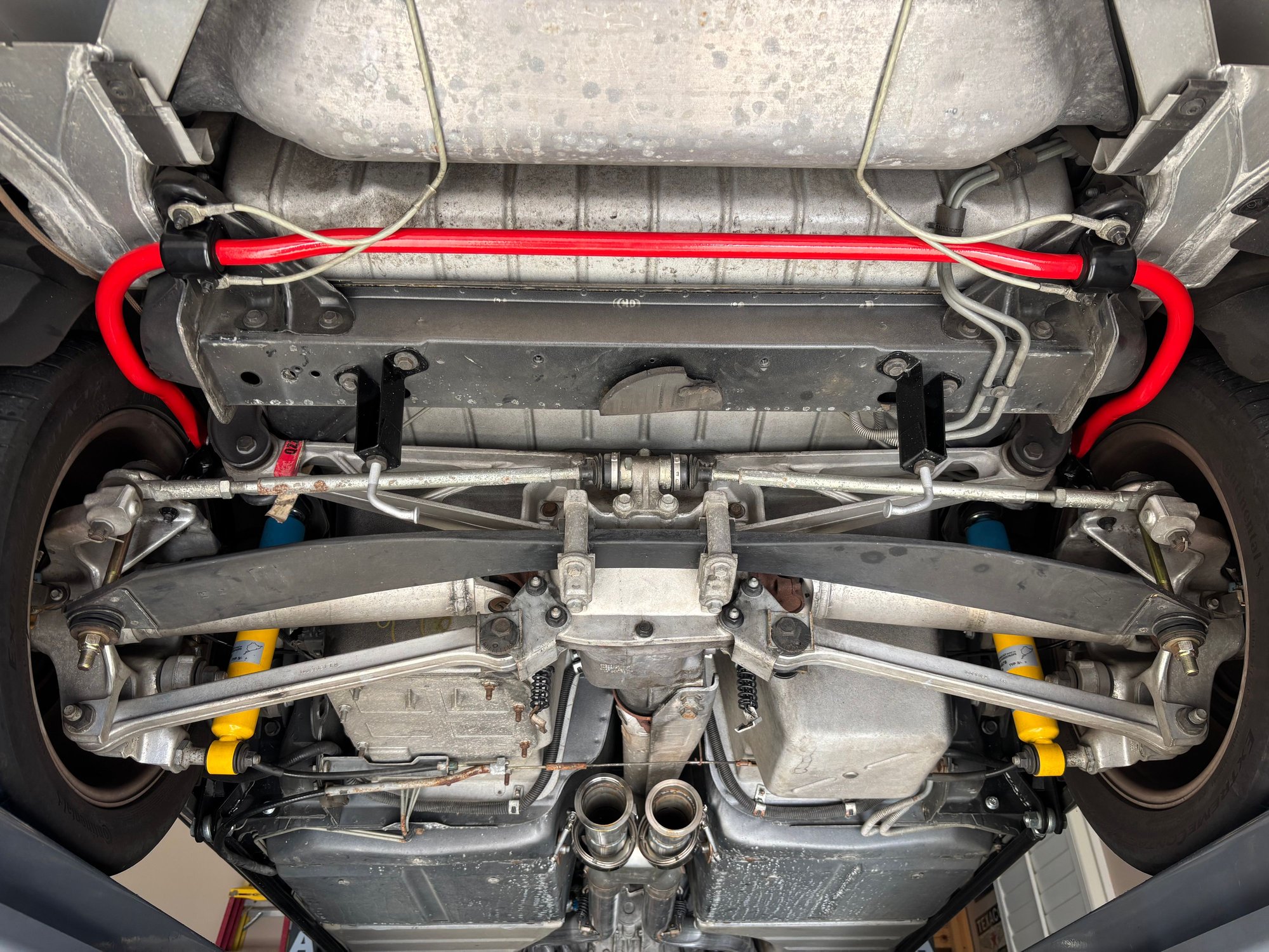

Rear sway bar. Forgot to take a pic after installing the mufflers. With mufflers in, it basically hides almost all of the bar, but still did it anyway.
Rear view without mufflers or spare tire and carrier.
