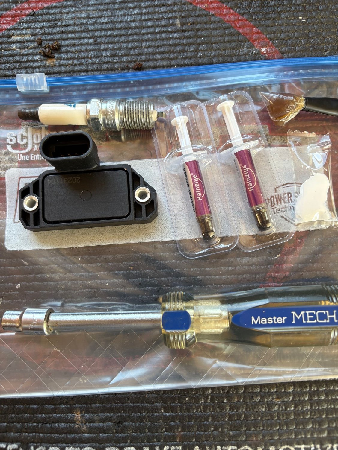

Don't replace a good working ICM. Do buy a spare and keep it in the car. It's a si.ple enough part to swap on the side of the road, unhook the connector and plug the new one in and you're back on the road.
The problem is, these are 30 year old parts with 60k miles on them. You don't know when it'll fail but quite honestly the side of the road is not where I'd like to find out (or work on a hot engine part). What if it's late at night? Or in the.middle of a downpour? Or you're in Arizona and it's 110° outside? These are extreme examples but you get my drift. In my opinion, spending a few extra dollars on preventative maintenance on these cars just makes good sense and can save one unnevessary headaches.

Due to advice I got here I carry an extra ICM. I also carry tools to install. If beside the road you can just unplug the old and plug in the new. No reason to fully install if the conditions are bad. Dan
