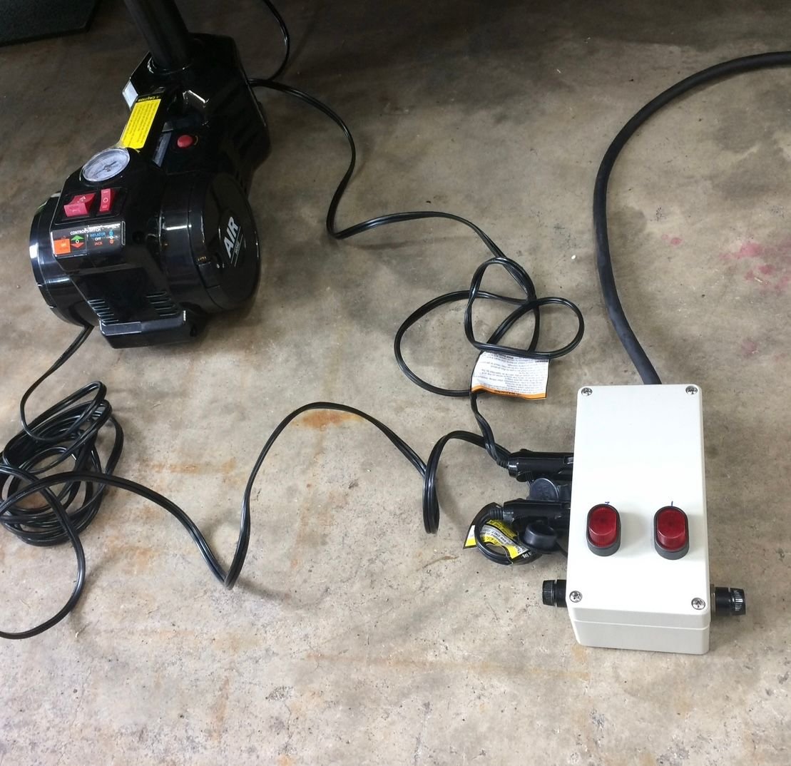

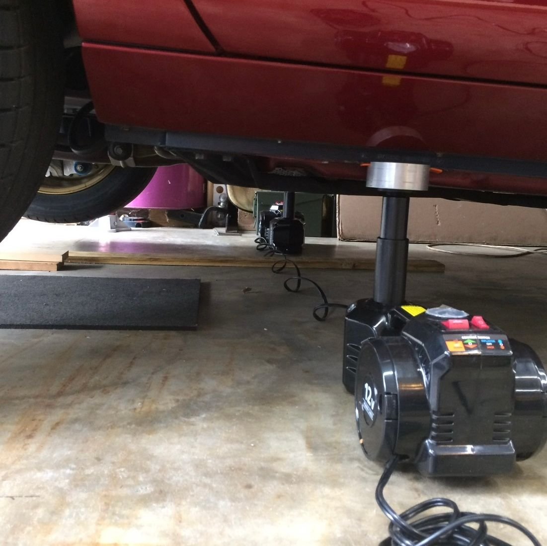

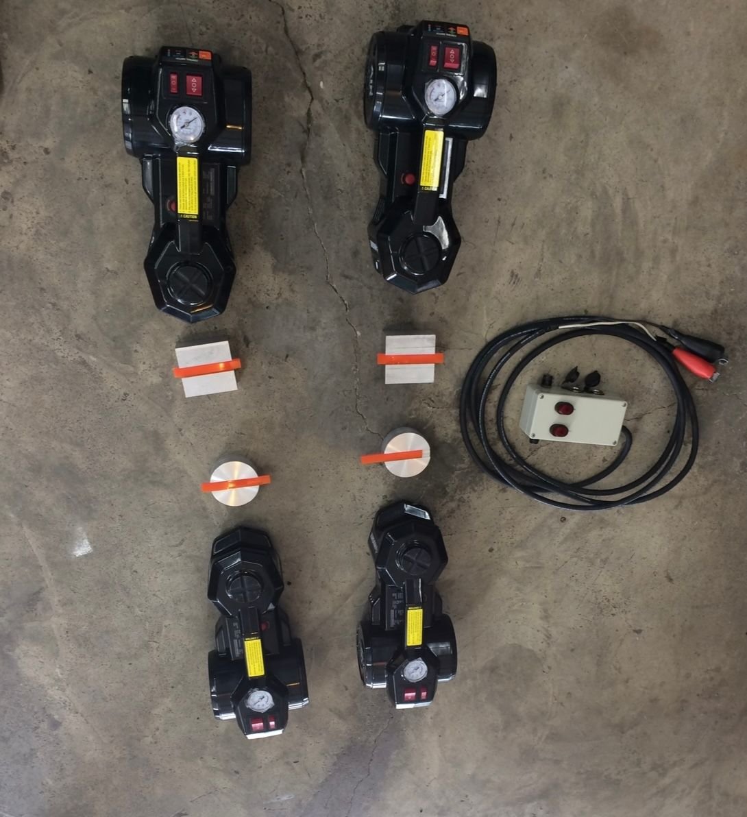

I was looking for a quick safe means to lift the rear. I made up a set of elec/hydraulic jacks with a control box. I also machined some custom blocks that fit the lift points. I can lift the front and rear independently.
It works well but is time consuming
