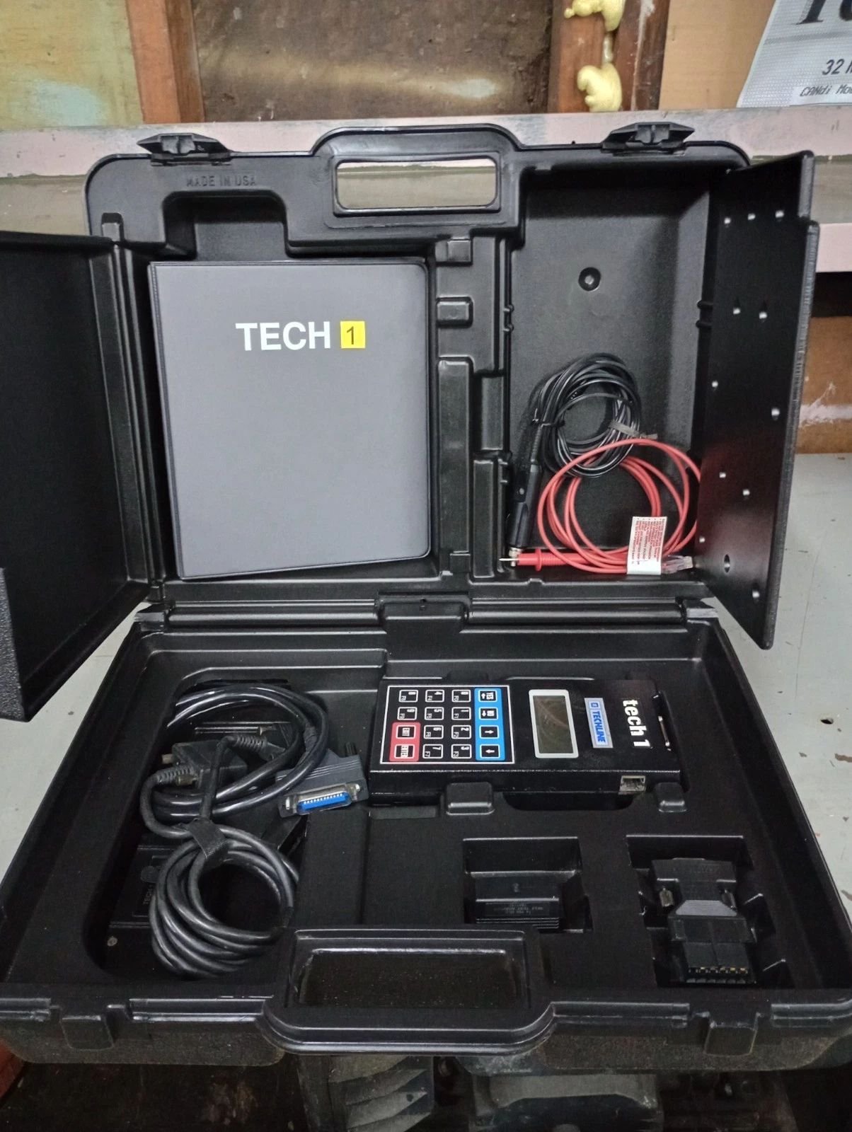

The main thing (that I know of anyway) is that with the Tech 1 you can work the ABS to thoroughly flush and bleed the brakes. Which I do not think that others can do.
No idea what other differences there may be because I never looked for anything other than a Tech 1. Mainly because that's what the GM techs were using way back when these were still being produced in order to diagnose and make repairs.
I landed one for myself for Christmas but have only started reading through the manual and haven't used it yet. Likely won't until Spring rolls around. My C4 is hibernating for the long, cold winter. Doesn't even have a battery in it. Once the salt hits the roads, that's pretty much it for the season around here.
