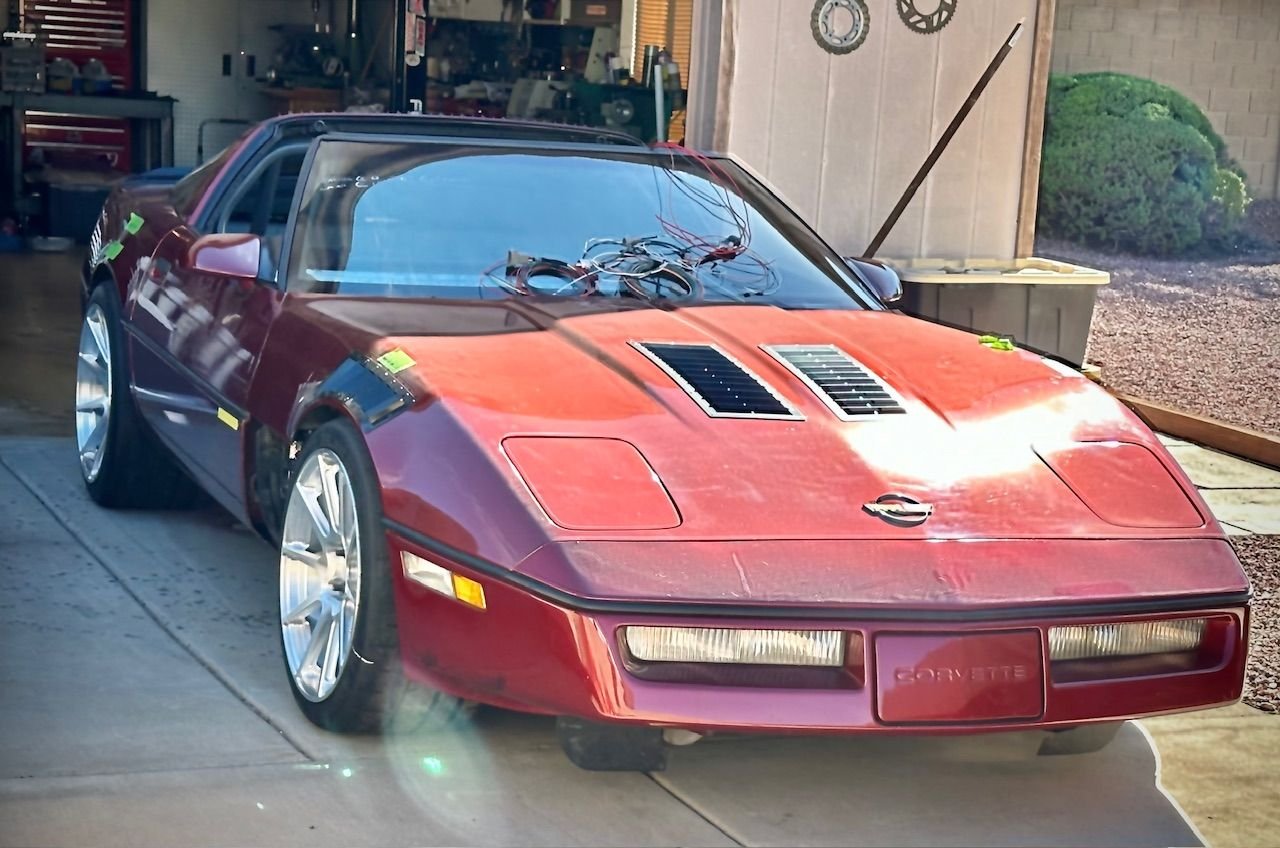

The wheels will work. Nice wheels… They are on sale and the forged wheels are light, no provisions for center caps.

Looks very nice indeed. John Nguyen confirmed to me that they would work, and your photos shows how they look on the car. Great, thank you for the photo. Do you live in Az?

Yes - Northwest Phoenix (Deer Valley). John bought too many of these perhaps because under $1700 for a forged set of wheels is crazy, and they are tough designed to bang into curbs, they are stiff so not as much deformation when cornering, they are light, and they look great. I bought two sets.
