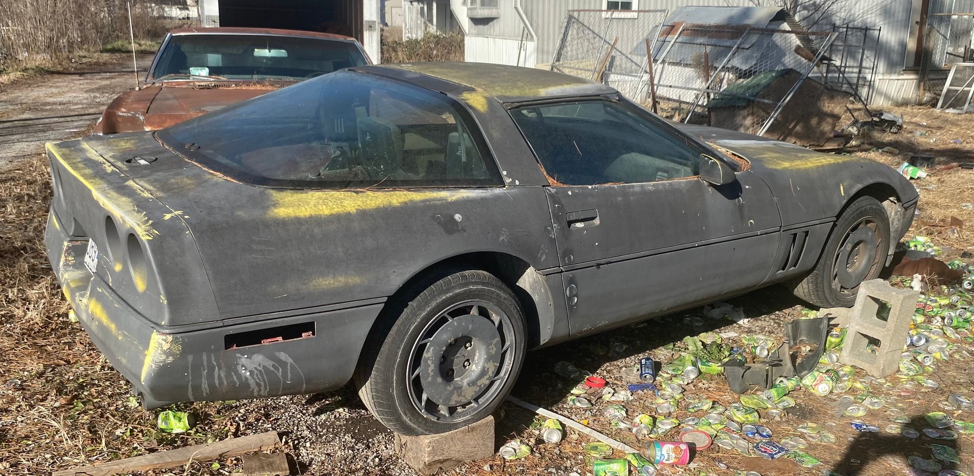

So for some context, I was given this 1984 Corvette that has been abandoned for the last several years. Even when it was running, it wasn’t taken care of. Here was my first look at the car.
I was also given a parts car, which I believe to be an 88 Corvette. Here’s a picture.
We came back a few days later and got it (84) off the blocks and dragged it onto the trailer. Not having any keys made the process difficult but we managed to get it done.
The first step was to get a battery, and after installing it we found that the car was alive electrically. Next, since we didn’t have any keys we had to replace the ignition lock cylinder. After this the car would turn over, but wouldn’t run. We poured gas down the throttlebodies and and it started up. It sounded really healthy while running.
The first thing to diagnose is obviously the no-start. I’m just going to assume that sitting with an empty tank for several years killed the fuel pump, but I’m still going to test if it’s getting power just in case. And yes I tried putting gas in It.
After that will be to install the radiator. Before the car was abandoned the previous owner thankfully drained all the water by removing the radiator so that it wouldn’t freeze. Should just need reinstalled, and I have most of the pieces to do so.

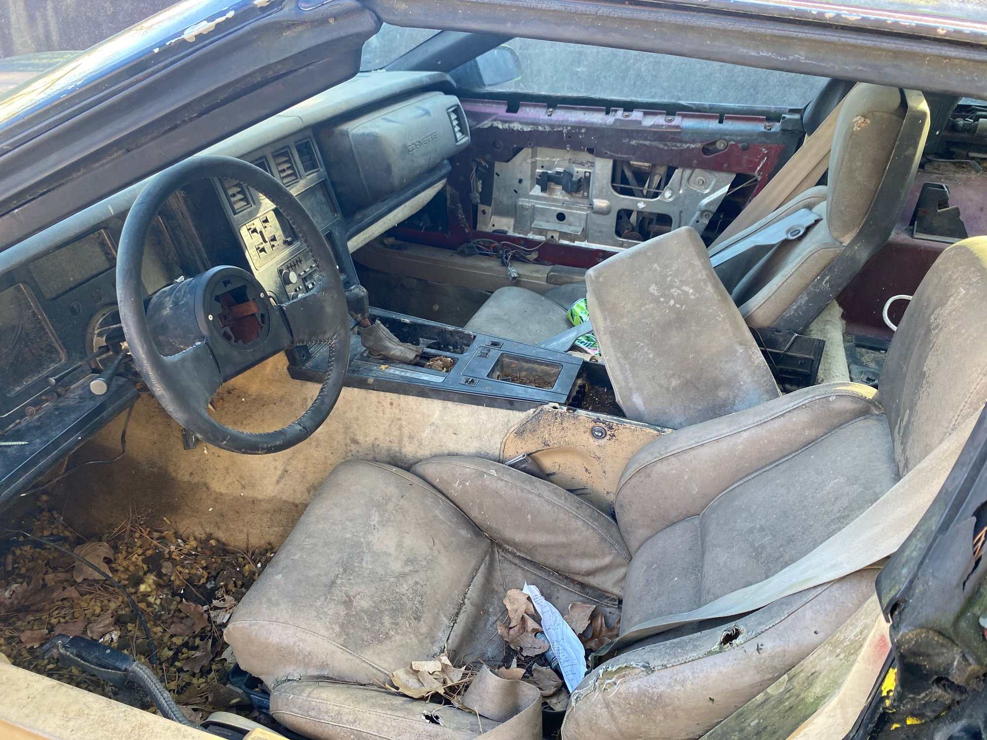

It currently has 150,000 miles and is an automatic. Here are some extra pictures.
Engine bay before cleaned
Current state of engine bay (I’m aware that battery won’t fit)
Current state of interior
This won’t be a restoration. This is going to be a revival.

You have quite a bit of reviving to do. Looks pretty beat. Have you come up, with a budget for it??

Hi... I hope you don't mind me making a couple of comments that are less than positive...
My daughter just restored a 1985 Pontiac Fiero 2m4 SE 5-Speed. Basically, we went through the car *COMPLETELY*. You could call it a concourse restoration, except no one is doing concourse judging on the restoration of an 85 Fiero. In any case... the car was running when we got it. It was fairly beat up, but it was running... though it had a lot of issues. Almost 30 thousand dollars later... it runs awesome:
Sorry, I don't know how to post the link without it turning it into a big video. Point is to show that it can be done, but only if you're willing to throw insane cash at something that will never be worth financially what you put into it.
Why would anyone spend 30 thousand dollars on a Fiero, you ask? Well... my daughter loved the car, and she restored it entirely herself. So, I considered it a father-daughter bonding experience, and an early college education before she actually goes off to college.
So why am I telling you this?
Because your 84 Corvette is going to cost a lot... I mean a LOT of money to fix up. It's missing a lot of things in the engine bay.
I bought a 1984 Corvette about a year ago.. my daughter is restoring it now, and we're doing a similar thing to the Fiero, but doing a "working restoration," which means we're going to try to keep as much as we can, and just replace or recondition what we need to. I paid $4k for the Corvette, and expect to pay about ~$10,000 to get it into safe and reliable running condition where it "needs nothing" to get down the road and have fun with. But... the Corvette we bought was already complete, and (although barely) already running.
So, I say this only because when I look at that Corvette... I see at least $10k worth of parts it's likely going to need, and you'll still have an engine that has 150k on it.
My recommendation is to take the 88 parts car, totally strip it of all the suspension and rear-end stuff, and sell it to someone on eBay who's converting a C2 into a C4 suspension.
Take the 84, and really decide what you want out of it. Are you hoping to make it like some pristine good-running classic Corvette? Because if you are, this is not the one to do it with. You can get running 84 Corvettes that don't really need anything for $8k, and you'll be so far ahead. I just hate to see someone take a car like this that needs so much, and start putting good money into it.
As for cross fire injection... I'm a huge fan. But if it's missing too much stuff, or it's not in good repair, then I'd remove the whole thing and just buy an inexpensive carb and intake setup.

Basically my plan is to get it running and safe. I understand that it would cost too much to fully restore. For example, the carpets are totally trashed, if I went on eBay and got really cheap carpets it’d be a couple hundred dollars at least. Or I could just rip the carpets out and leave it. This car will never be like it was leaving the dealership, and that’s why as I stated my attitude is that of revival, and not of restoration.
Since you seem to be familiar with crossfire, can you tell me what all is missing, besides the obvious and that is the actual air filter housing?

No, that's totally ok... I think the thing that's getting me is that you're basically going to have to replace everything. It's still an American car, so it's not like buying parts for a Porsche... even if it is still a Corvette. Most parts are cheap... and they're still "GM" so it's not a huge issue.
If this was my car... the first thing I'd do is make sure the engine is even worth working with. At 150k miles, it's pretty much at the end of the line... and you may want to seriously consider pulling the motor and having it rebuilt. Same with the transmission.
I say that because you could put a lot of time and effort into it, but EVEN if you replaced everything, at 150k miles, that motor is going to have significant blow-by and it just isn't going to run right. So the first thing I would do is hook up a battery, check the oil, and try cranking the motor. Not to get it to start, but too see how it cranks. If you hear any mechanical failure noises at all... the engine is toast. You also want to listen for a lumpy crank. That is... it doesn't crank smoothly, but feels like some cyls have more pressure than others... which means you've got a low compression problem.
The transmission is a 700-R4, so it's not a hard transmission to rebuild, but you'll want to have it done.
Personally, I think you should pull the motor and transmission if you actually plan on doing any work on this car. You can easily rebuild that motor with a basic re-ring and bearing kit. If you want to spend a little more for better pistons, you can send the block to the machine shop and then re-assemble it yourself. You just need a good torque wrench.
Expect to spend about $800 for a simple rebuild with machine-shop costs. This is by buying clearance on Rock Auto, and shopping for low prices on eBay.
Transmission, expect to spend about $1000 for a simple rebuild. This is assuming you've taken the engine and transmission out yourself.
Once you've done that, you can start putting a lot of the stuff back on. You're missing the air cleaner assembly, of course, and they no longer make the air filter for this model, so you'll have to find a used one or make one by cutting up some other filters. But you will need to buy a rebuild kit to rebuild both throttle bodies. My daughter has a video for that here:
But before you try to start it... my guess is that you probably need to completely re-do the entire fuel system. You'll want a new fuel sending unit and fuel pump. Buy both at Rock Auto because it's inexpensive. You'll want to get a shop manual too of course. This all assumes your fuel tank isn't rusted... you don't need to remove it, just make sure it's empty. Replace EVERY SINGLE RUBBER FUEL LINE... there's several by the fuel pump, and then again under the car where the fuel filter goes (behind the front passenger wheel under the car), and then again when it goes up the front of the motor.
Hopefully the injectors are OK... they're a little expensive.
You're just starting with a major deficit... I'm merely suggesting you could start with a much better car. But if you want to really learn about this car, this is the way to do it.
But I'm concerned about the brakes and suspension. It's likely all totally shot. The front has wheel hubs, just like the rear. It's not like other older cars where you've got a steering knuckle with a spindle that bearings ride on... it's built more like a modern car with wheel hubs, which are also expensive... and they do go bad. The brake booster is also no longer available, and my guess is that it's probably failed. So you'll want to buy one from an 85 and install it. This itself will make you hate life... but it can be done.
Good luck... we're here to help.
