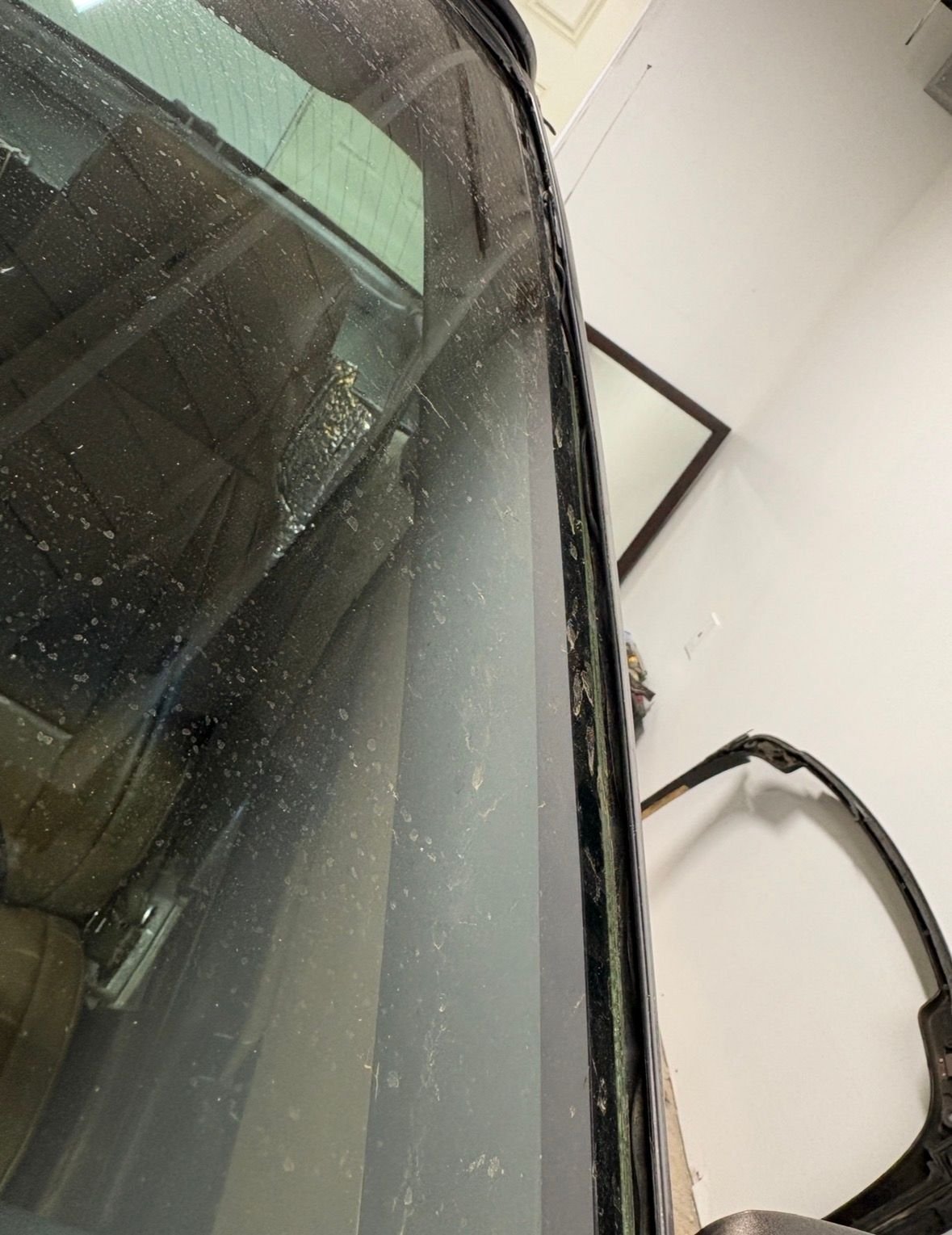

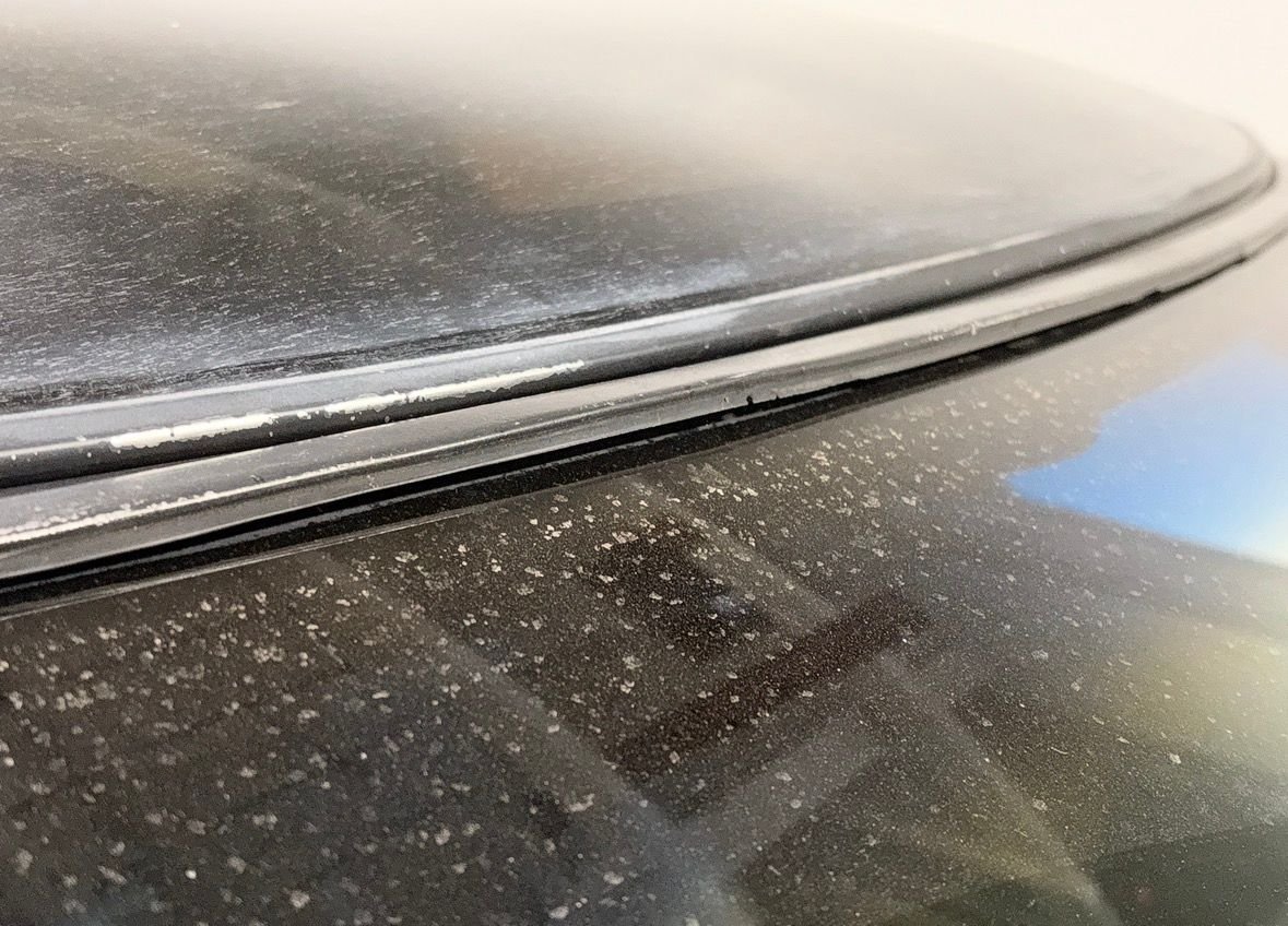

Good evening all!

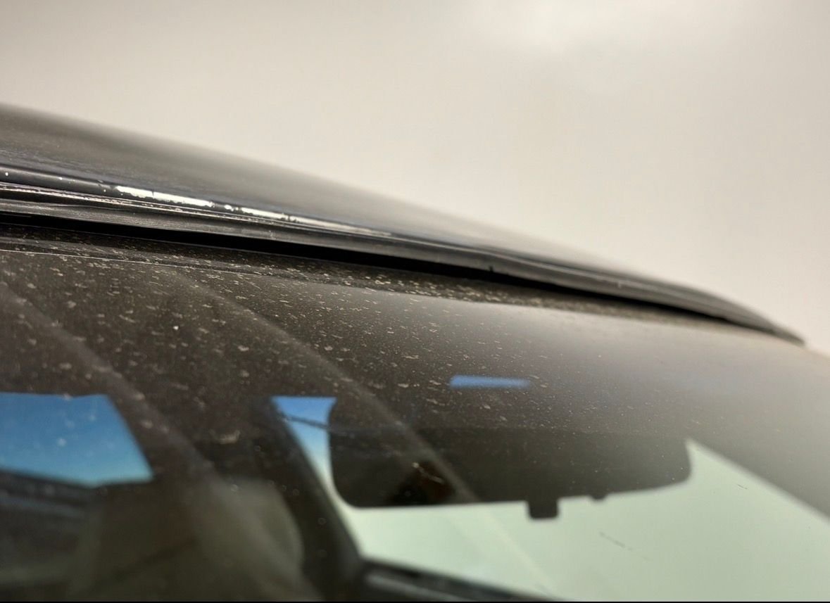

One thing that has always bothered me about my 84 is how the trim around my windshield looks. It seems that there was a seal here at one point, it degraded into nothingness, and someone tried using some sort of liquid sealant over it. Now even that has degraded, and nothing is separating the glass from the metal trim piece.
So I’m curious, would it be necessary to seal the top/sides of this windshield trim? I hear the windshield area can be prone to rust if not properly sealed. And if I were to seal it, would some generic foam stripping from Home Depot work, or should I use some sort of liquid sealant from a caulk gun to fill in the space?
A fellow forum member let me know how the trim on his 84 looks, and it seems like it should have a rubbery seal from factory. But in my case with an aged and neglected 84, what would work best?

On second thought, I think I know why this is so weird. I think my windshield was replaced at some point in my cars past.
In most images and videos I see of windshield replacements, people say to be very careful with this metal trim since it’s easy to bend. Perhaps someone in the past was aggressive with the trim removal and bent it?
There’s a chance I can bend it in better shape. But still, it would be nice to know if these trim pieces were sealed off from factory with anything.

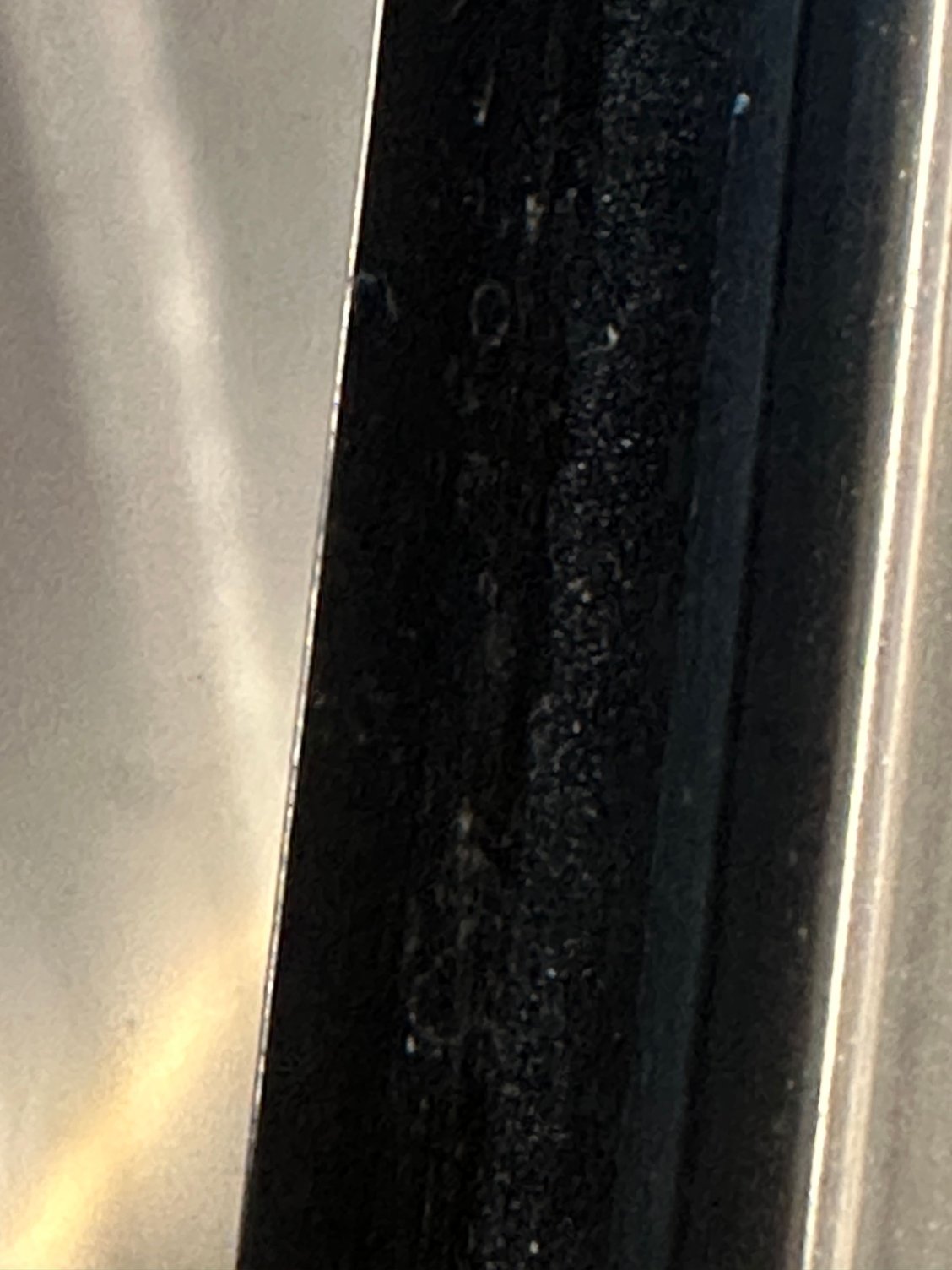

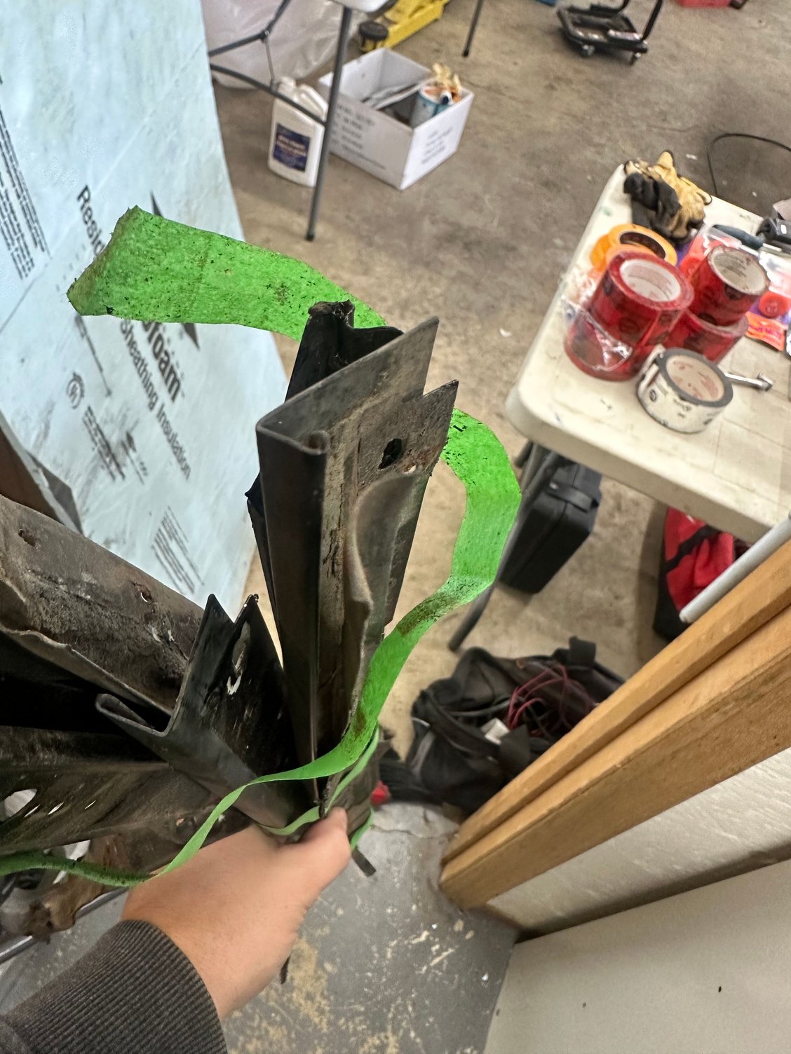

Likes: 2,737

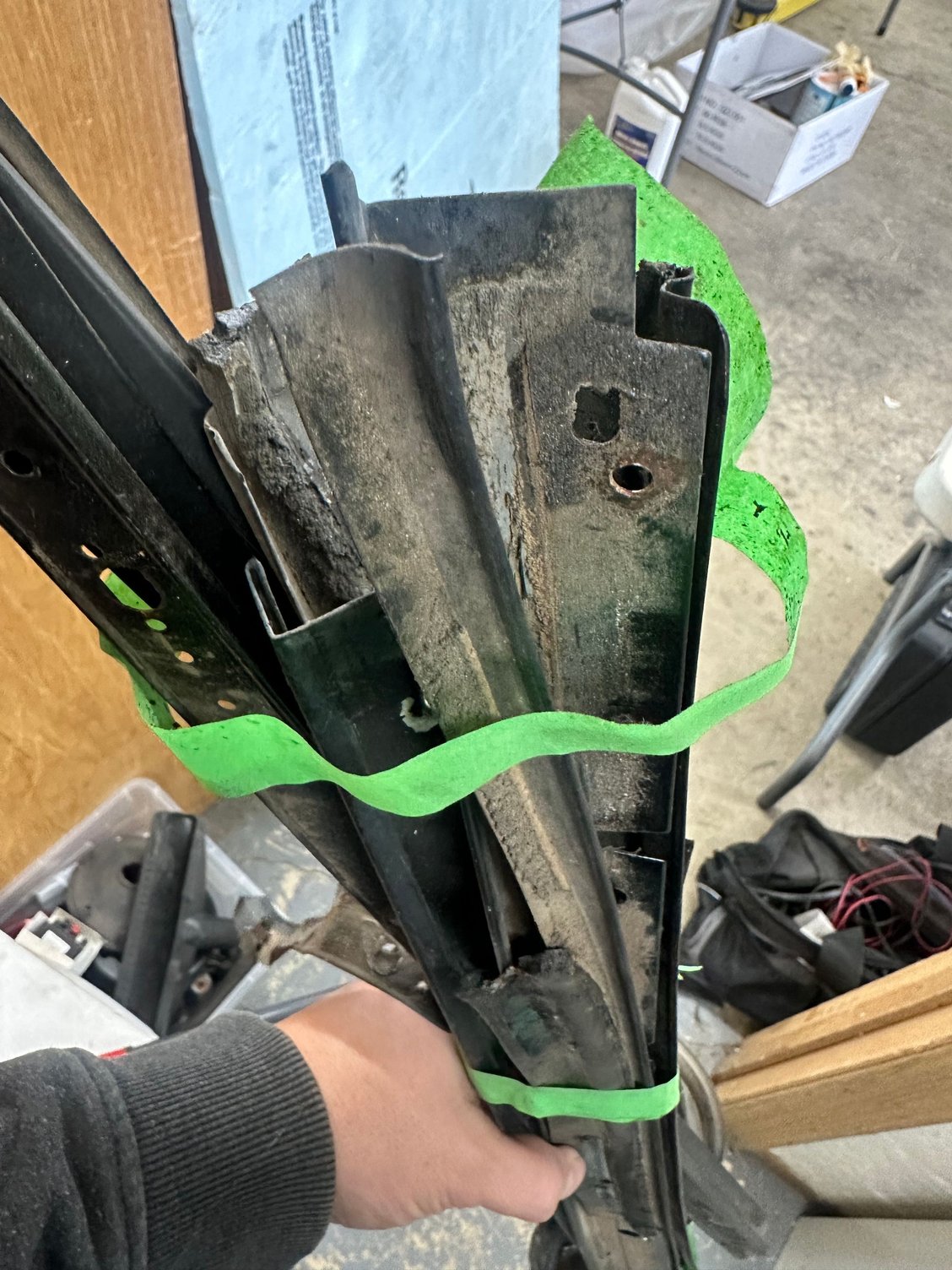

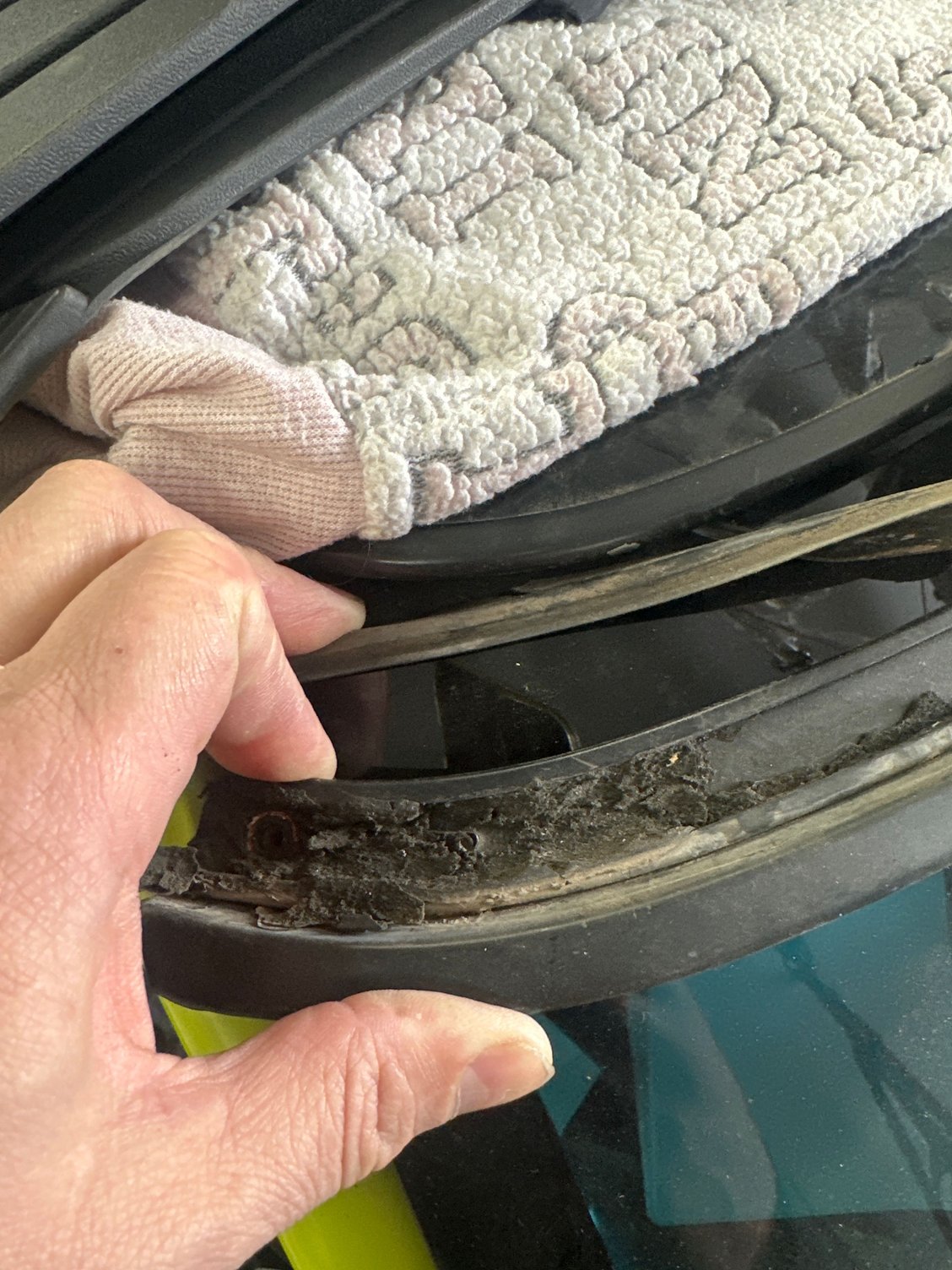

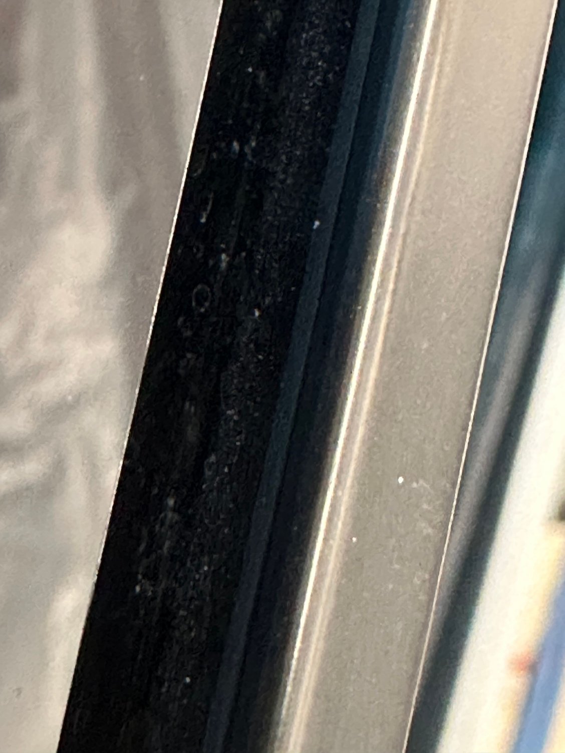

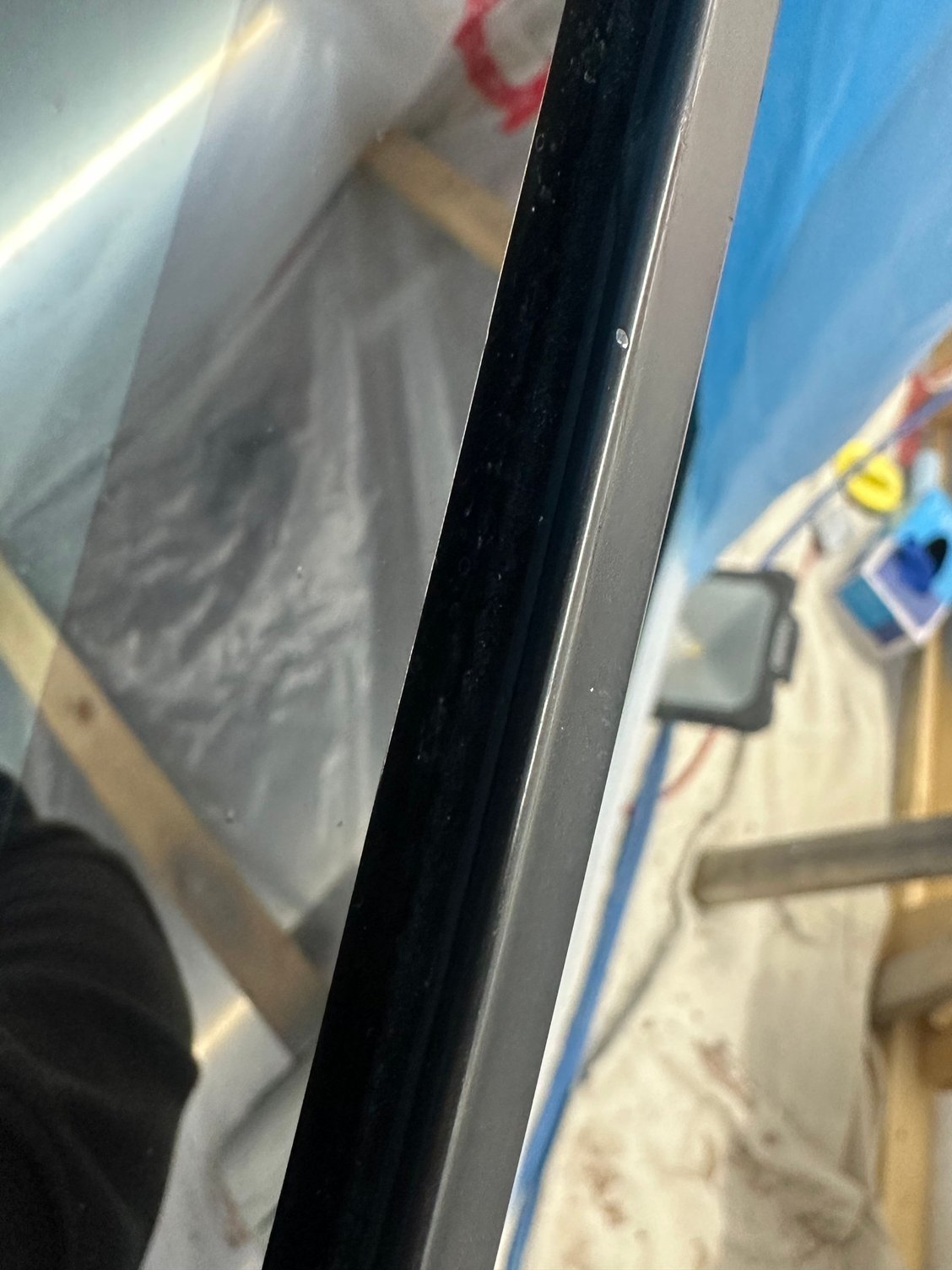

So, here are shots of frostbites windshield. it DOES have a pice of plastic trim btwn the metal and the glass.
AND i happen to have saved my 90 racecars windshield trim….and it also shows a bit of plastic trim that would be btwn the metal trim and glass.
So its possible that your oem stuff was lost or installed wrong, on frostbite its really tuck in there you cannot see it at all. Or maybe yours is aftermarket.
Im guessing its to prevent metal trim to glass contact.

Thank you for the images. They’re always very helpful.
Alright so it seems like my suspicions were correct and someone seriously messed up with a replacement windshield installation. And it seems like whatever trim sat between the metal and the glass has either degraded into nothing or was simply lost.

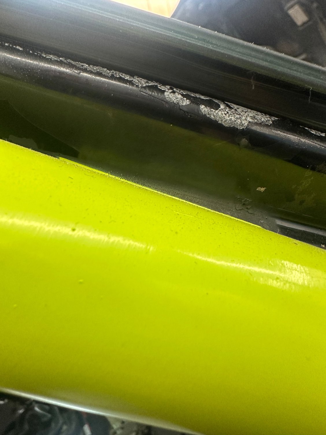

EDIT: I also have a little less than half a bottle of this left over if I wanted to seal that gap. But this might be overkill for the glass-to-trim sealing job.

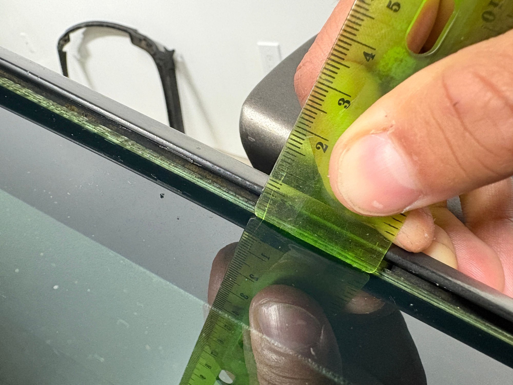

Old Feb 22, 2026 | 06:35 PM
VikingTrad3r's Avatar
VikingTrad3r
Oil Producer
Joined: Apr 2014
Posts: 9,377
Likes: 2,737

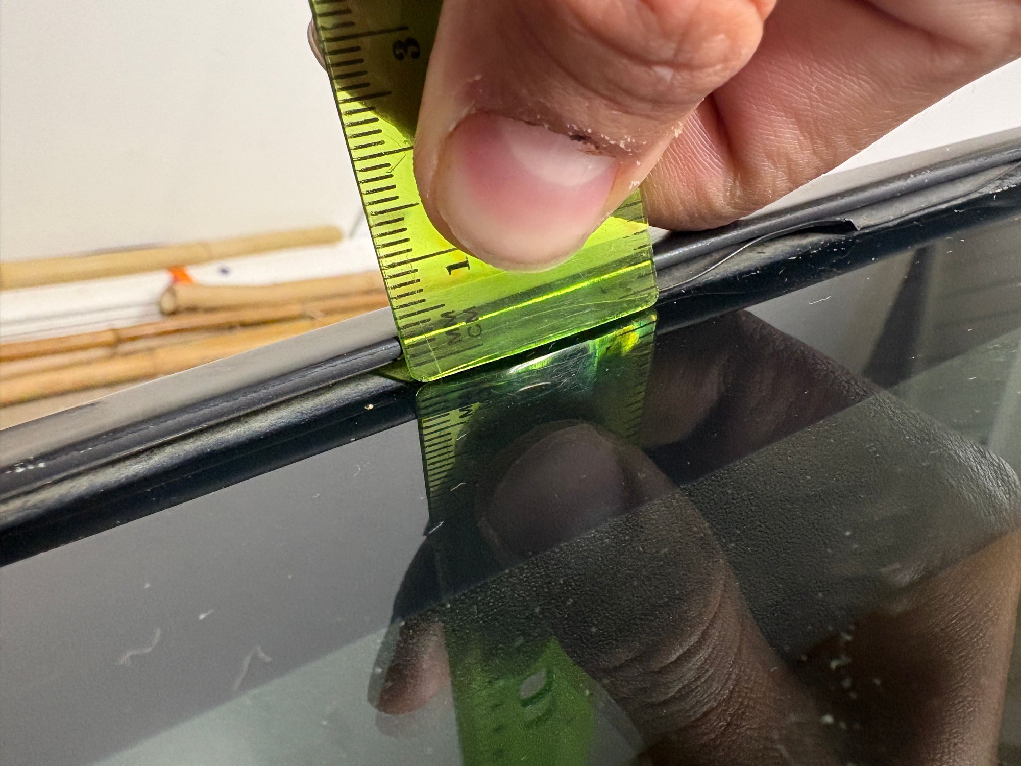

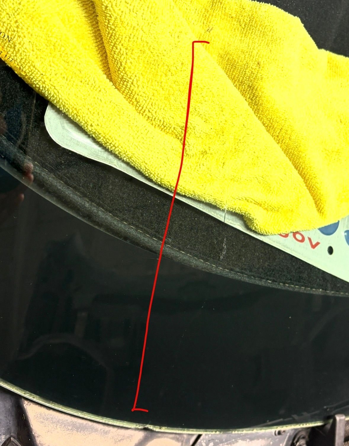

Default on reviewing the images with the ruler

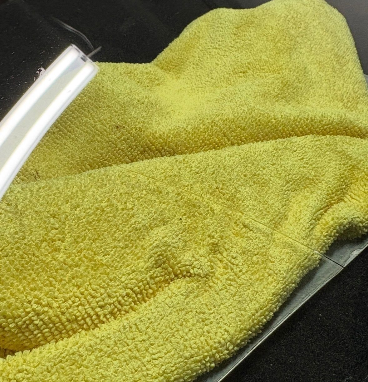

I think u have the correct plastic trim piece. There was just too much gap greated by either pushing the windshield too far in or not using enough urethane.
i took this pic on racecar to show the urethane. You can see how to much and windshield stands proud. too little, or pushed in too much (one of these two your most probable situation) and u get trim to glass gap and the plastic strip is allowed to get wavy in the hap
