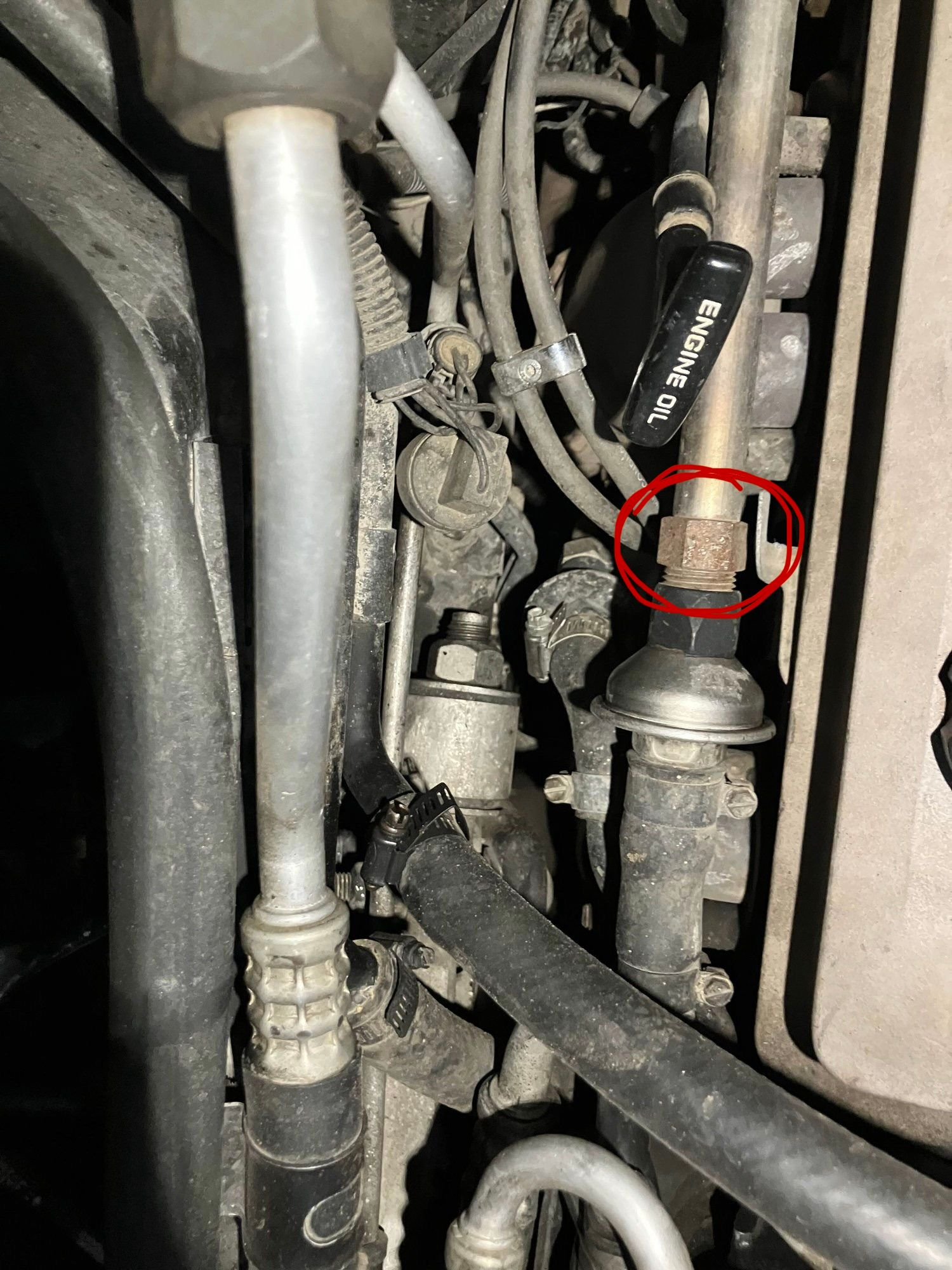

I am trying to find the correct cap to plug the secondary AIR injection system at the exhaust manifolds where the check valves thread into.
Fitting I’m trying to cap off circled in Red.
1989 Corvette L98

Looks like you got your answer on one of the FB forums. 1/2" npt plumbing cap.
I did. Thanks!
