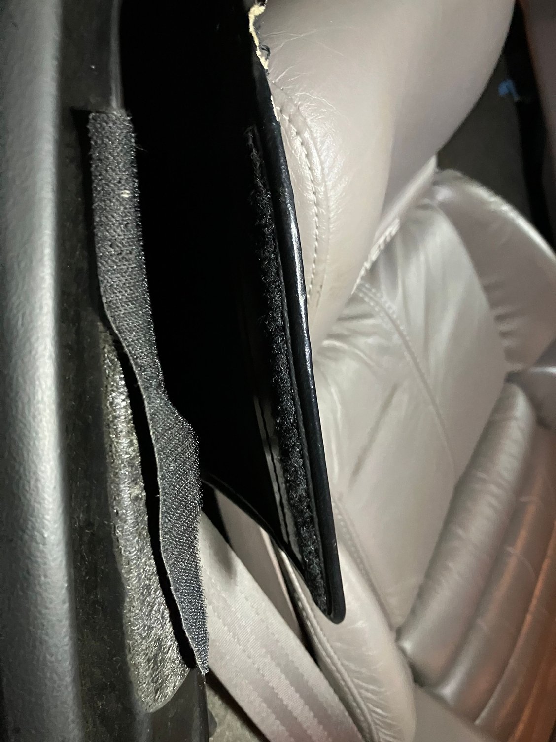

Which glue or adhesive can be used to sercure this piece. The Velcro part is good it’s the back part that needs to be stuck to the frame

I used 3M Glue!

Ive starting using E6000 glue. Cheap, readily available, and seems very strong and durable

I wonder if Velcro strips would hold…….I’ll try the e6000 and see what happens…Thanks all

I know if this had come in as a complaint in my dealership days I would have grabbed the Black 3M weather strip glue with out a thought

Contact cement. You put it on both and let dry for 15 minutes or so. When it sticks together it stays. This allows you to put a little stretch on it. Regular glues are too hard to clamp in this position. Dan

The e6000 has some flexibility

I've had very good lick with Barge's contact cement.

I'm a fan of Shoegoo (and it's copycats) for generic stuff. It does take a day to fully set, but it holds very well and can take a bit of vibration.
