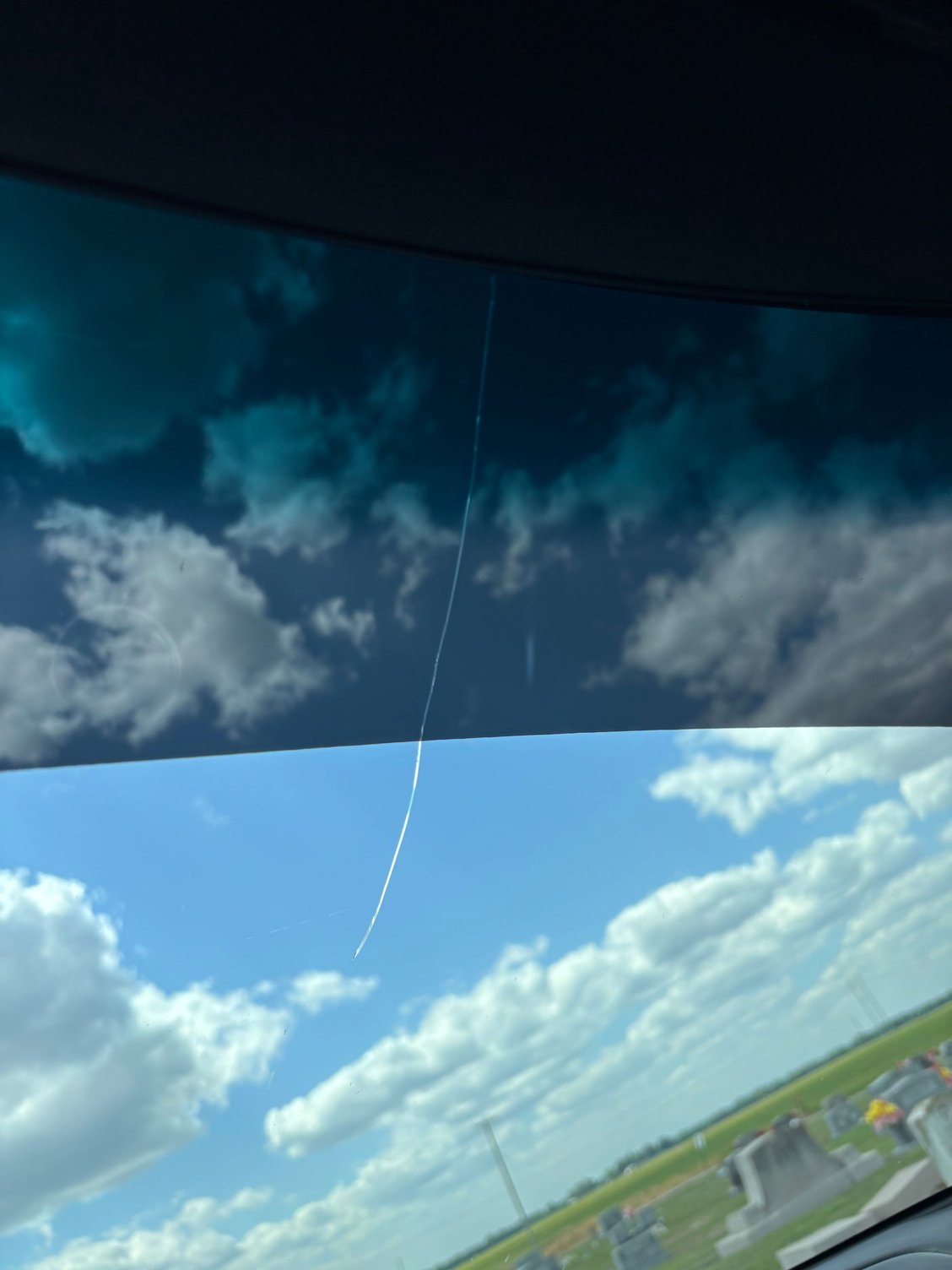

Well, picked up a rock and now the windshield is cracked, so I get to go through the process of getting new glass for my C4. I haven’t even looked at options yet; I’m familiar with Safelite and another local to me vendor, both of whom have done my non-Vette vehicles. I kinda vaguely recall reading that C4s are a bit challenging to get windshields for…that an accurate statement? Thx in advance for any feedback.

Windshields on Corvettes is a No Joy, Glass availability Questionable no worse than any other 30 plus, Safelite I don't think they even touch it they like new fresh cars l called them to do my Tahoe and he said we don't do cars beyond 5 or so. I figured he was picky No I call another Safelite No.
So do your research find a good private installer, Next how old and what condition are your weather strips in because the black trim around the glass needs to be pulled so if there in bad shape hopefully they can be removed without much damage. So plan on replacing them as well possible the tracks

Well, good and bad. The good, the place I found was recommended and they did a good job overall. And the tech said he has done older vehicles and had done a C4 as well. There’s a new windshield in the LT4, but the bad news is there’s also a lot more wind noise. Like significant wind noise compared to almost zero, basically zero as I don’t even remember hearing any wind noise with the old windshield. In looking at it more closely, can tell the trim is not quite flush so it’s catching air rather than deflecting it over itself.
Can hear wind noise in both driver and passenger side top corners of the windshield, significantly louder on the passenger side.
Arrrrgh. Frustrating…..now I either figure it out and make the adjustments myself (which is probably what I ought to do; you know, if you want something done right, you do it yourself), or take it back and have them redo the trim. Or have them get new trim pieces and do the trim part again.
I ended up not getting new trim pieces beforehand and my weatherstripping was still in great shape so I did not spend the money for new rubber from corvette rubber.
