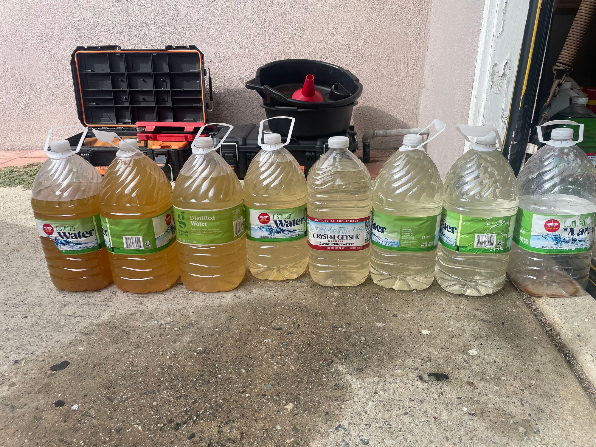

You can also break the porcelin off the knocks by accident so then the connectors wont properly attach. Ask me how I know! The shop vac method looked interesting but I flushed using a hose then simply refilled several times with Antifreeze to dilute the tap water in there. If your hoses are not pressurizing, maybe your thermostat isn't opening (due to corrosion or another malfunction) or your water pump is shot. I've posted this picture before on the forum but it's a great demonstration of how much rust can accumulate in a neglected cooling system. Keep in mind there was a harbor freight bucket amount of flush in between each water bottle!
