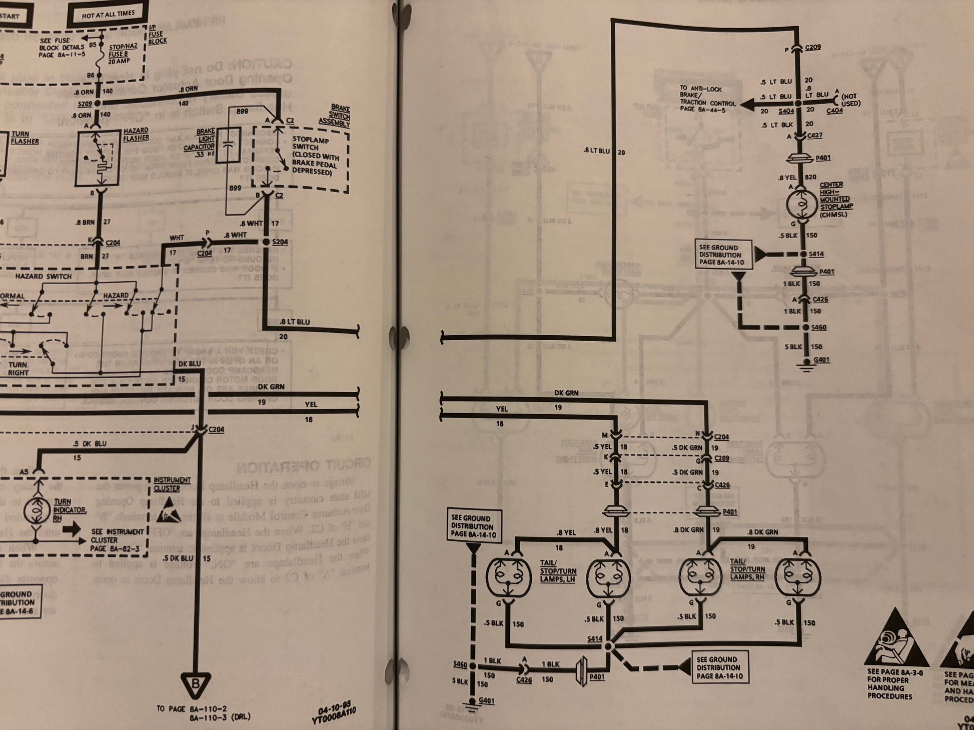

Also, the CHMSL is not coming on when hitting the brake pedal either so I guess that pretty much narrows it to the sls.
I see in the FSM where that white wire splits to the lt blue to the CHMSL while the white goes to the brake/tail lights via dk grn and yel.

I did locate the diagram in the FSM. I’m a good DIYer and am analytical and detail focused, but am not an engineer, so I’m learning some of the FSM stuff as I go.

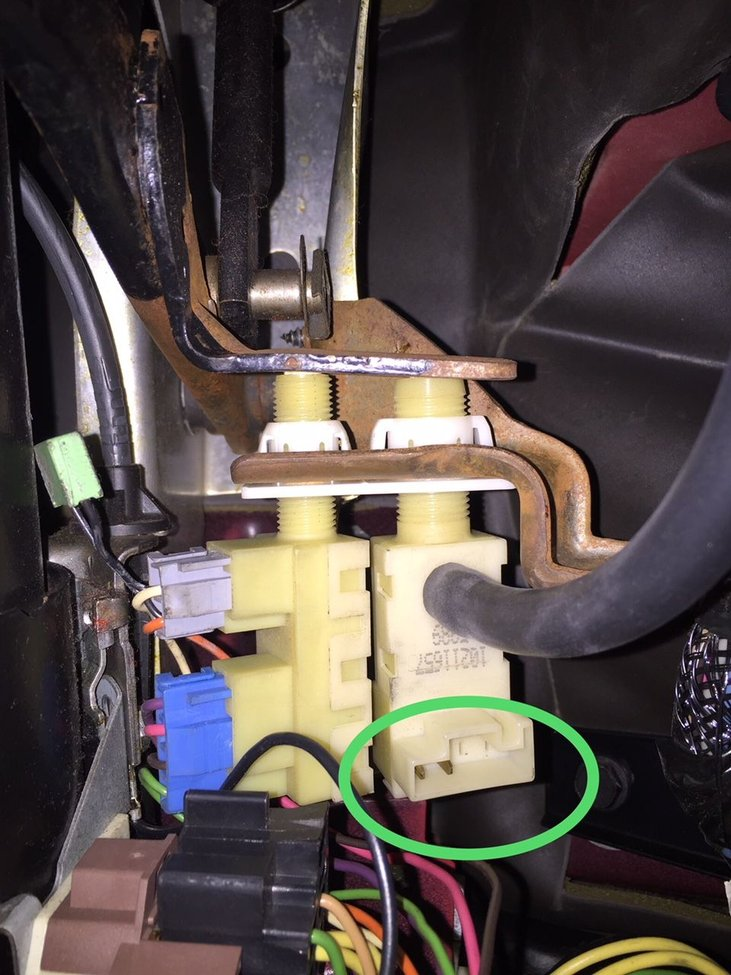

Would you mind sharing the accepted solution? I searched and found some recent discussions where you noted a solution but I did not see what it was specifically. Is there an option to pick up an SLS that will work for 93 and up C4, or parts to fix as existing SLS, at a local AZ or O'Reilly's? I'm planning to take the lower driver side dash panel(s) off this Saturday and try to fix it....hopefully, it just need adjusting, but would like to have access to the part/local solution that day as a backup. Thank you in advance.

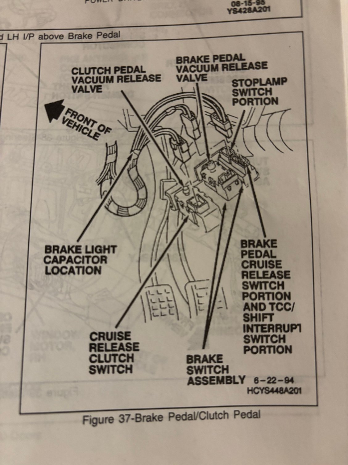

I am not familiar with the 93-up SLS assembly. Looking at the image above it appears that there are two components on the brake pedal. A vacuum release for the cruise control, and another switch with two electrical connectors.
My hunch is that the electrical switch has two sets of contacts. One normally open for the brake lights. These would be the orange and white wires. The other set is normally closed and are for the cruise control. I didn't look it up, but cruise disengage wires are usually gray or gray/black. Ok, I did look it up: Lt green and a brown.
I'd remove the switch and see if it can be disassembled and the contacts restored. Or take the switch to a chain store and see if you can find a two-terminal normally open replacement that physically mounts into the location. Connect the orange and white wires to the new switch.
For the cruise wires: Obtain a 12V 'cube' relay.
Put the (2) cruise wires (gray and/or gry/blk?) from the old switch on terminals 30 and 87a. (These are the Normally Closed contacts.)
Tap the white wire and connect to #86. (The white wire is powered with the brake pedal depressed.)
Connect #87 to ground.
Another possibility to the above: The existing vacuum switch with no wires on it is almost certainly a N.C. set of contacts. Transfer the lt grn and brown wires (in the blue connector) to the vacuum switch. Done. No relay required. Note: A 6-speed car will not have the pink and purple wires in the blue connector as these are for the TCC in the automatic.)

This post 1st in the thread is a snapshot of '93+, it's 2 switches joined with a threaded plastic plate that was sold as a single part number. Most any GM SLS will and can be substituted for the electrical aspect of the '93+ GM# 10211657. I've posted a few part numbers that in the after-market should substitute for the electrical aspect. All are available 'local'!
Notice in the snapshot the cavities that DO NOT have a connector available in the car harness and aren't needed!
cruise control won't engage 96, also a mystery connector? - CorvetteForum - Chevrolet Corvette Forum Discussion
Ether of these 2 numbers should interchange locally for a fix if needed.
If you need what you imaged there use these GM numbers for maybe an interchange at NAPA or your favorite local might do for you. 25551819 or 10170430. The 93+ is a combination switch that hasn't been available for quite some time. Whatever you buy and if it's a fix be sure to post it. Do the diagnostics first and don't just be throwing parts at it. Do you have the FSM (Factory Service Manual)? I've suggested those previously and they've been mentioned to work.
