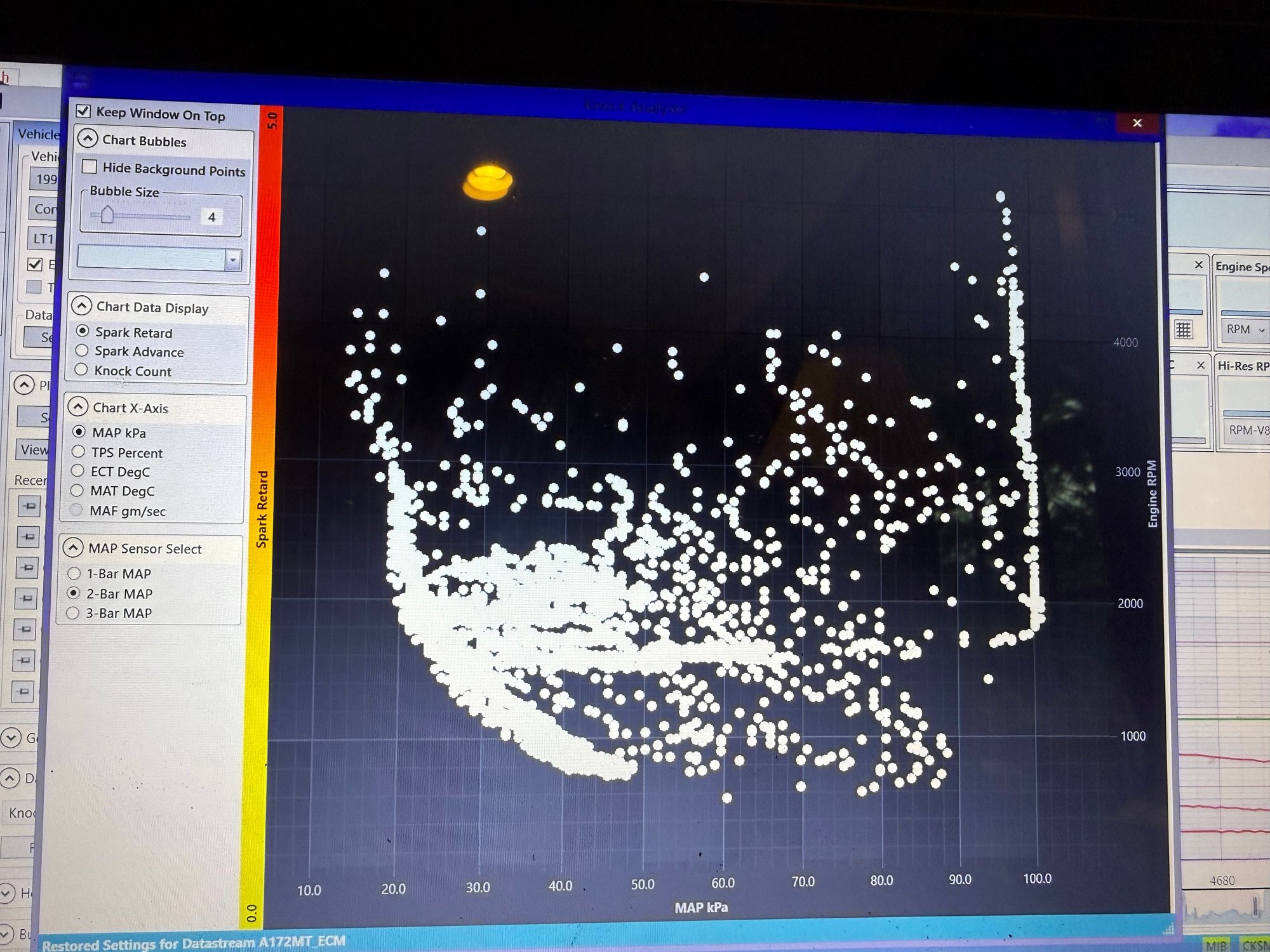

Some people here gonna hate, call me names, they get tired of hearing from the same person all the time. i dont care. Today im gonna provide some data that those people wouldnt try to, or dont even know how to try….
72F - 1993 corvette #2.
Forged 383 6spd, 80 lb/hr inj (overkill), 185F coolant temp, 215F oil temp.
9.5:1 compression
214/218 , 114 LSA cam, .575ish lift
Was down to 5 gallons 93 octane and mixed in 8 gallons 87 octane.
did some WOT up thru 5100 rpm, uphill WOT on ramps, coast downs, highway pulls WOT lugging it in 5th or 6th uphills, and 1st gear only WOT sprints
had zero knock (see data).
will repeat experiment in warmer weather and with additional 87 octane to further knock down the octane to 87

Question from a amateur. Does your engine have antiknock sensors that will cause the ECM to retard timing if it detects a knock?

Yeah, as far as I know... all Corvettes have a knock sensor. My 1984 Corvette (which has lower compression, 9.0:1), has a knock sensor located on the lower passenger side of the engine block, just below the exhaust manifold.

Yes, most new cars have knock sensors which can retard timing, lower boost pressure, etc., to prevent further knocking, (pre ignition). Notice I said to prevent further knocking. This is a fact that most overlook. If a knock sensor detects knocking, that is past tense, some amount of knocking has already occurred. And at 4 or 5 thousand RPM that could be multiple times. I had rather spend a bit more on higher octane fuel to help eliminate knock than to have it occur at all.
