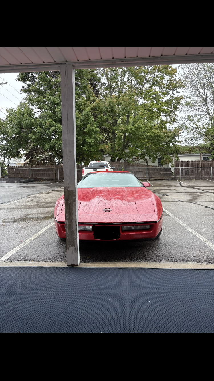

The Vette on an adventure to Maine last summer
The beautiful Vette on an adventure to Maine last summer
