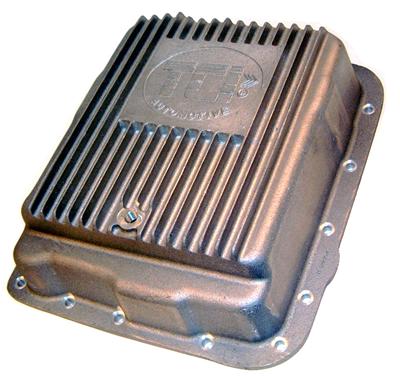

Speed, the 92 didn't come with one. I'm installing a new larger capacity pan like this one and I'm adding a trans temp gauge on a pillar pod. :steering:

So basically you’re looking for the best place to fab in a threaded hole for the sensor?

Yep. :thumbs:

Sorry man, never tried that before. I imagine if it has internal clearance from moving parts, and external protection from strikes and heat, it should work fine. Just make sure there isn't a single shaving in that pan when you put is back on, or else......clunk..cu..clunk "dad gome sonofa!" But then again I'm probably not telling you anything you don't already know.

Be careful with that new pan, it will most likely be the lowest point on the car by a fair margin.
