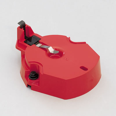

After dad went out again I decided to make another run after the car was cooled down. When I first broke the tires loose on the burnout, I felt a very slight hesitation, then it was fine. Did my dry-hops and all felt normal. Staged the car and launched. Again major airtime (wish I would have had the video camera - fogot it on the kitchen counter. Dad said my wheels were at LEAST 2-2.5ft off the ground. The run felt nearly perfect all the way out, until about the 1000ft mark when all of a sudden it felt like someone turned the "power-****" down on the motor. I immediately lifted and glanced at the oil pressure while reaching for the key to kill the power. My oil pressure was at 65psi (normal) and my new oil pressure warning light was off. I coasted the remainder of the track, and did not see anything behind me in the way of smoke or anything, and thought perhaps I was low on gas or a plug wire came loose.
I got off the track at the last turnoff and pulled off. Got out and got down to look under the car. No oil - good sign. Went out and looked everything over - and everything appeared to be ok. So after pondering a little bit - I went back in and started the car. It fired up with a 1/2 rotation, but the motor shook. The oil pressure again shot right up to 60psi, but i killed it right away. Leaning towards the thought that I lost a plug wire or one burned through or something I went out again to check them. Went around all the wires down at the plugs and they all looked/felt good. I then went up to the distributer and started pressing down on the wires there to see if one popped up off. After checking few I noticed the distributer turned a little while pressing down on the one wire. WTF??? It was loose as a goose! Awe-man - that must be it. Thought boy I thought something MAJOR went.
By then a track guy was there with a 4 wheeler and we pulled the car back down into the pits. There I popped off the distributer cap to phase the rotor to the cap, since I run a crank trigger, my ingition is trigger with the signal from the crank trigger and my distributer cap is merely for the delivery of the spark, so it turning really does nothing to my timing, just how strong or weak the spark it or worse, which had me worried is what post the spark goes to (pre-ignition 100 times worse than knock). When I pulled off the cap, to my utter amazement I found the rotor lost the S-Shaped metal piece and all I had was the piece of spring steel that the caps button sets against. I thought WTF - how did this thing even run? But again I thought, well that is why the power dropped off - lets run and get another rotor at the local autoparts store. Got a new one for 6 dollars. While installing it we discussed how stupid and rinky-dink the design of these things are. I never really took the time to look at them, but take a look here and I will describe what you see.
The piece of spring steel is what the button in your cap sets again and as you make your way out the steel you will see a black square piece of plastic. This is exactly what it is. That piece of black plastic is glued to two small 1/16" wide ribs and it holds the S-shaped piece and the springsteel together. Without it, the S-shaped piece that really comes closest to the postes and makes sure the spark does to the correct post will fall right out.
After we got the new rotor back on, and got it all phased - I went in to fire up the car. The motor fired right up, but again shook - so I killed the key. I went out and double checked the wires - which were all right. I went back into start it again and the starter would just click. When it rains it pours. I tried to turn the motor over with a power bar and it was solid. This is NOT good I said to dad.
I went around starting with #1 adn pulled the plugs out, which all had a nice light tan look to them. Got over to #2 hole and I pulled off the boot to find the porcelin on the outside of the plug where the wire presses on, completely shattered. I looked at dad and said: Well - she definately pre-ignited- and this is NOT going to be good. I started to pull the plug out, which I figured was going to be mangled up on the cylinder side, but it came right out and at first glance looked ok. But upon a little closer inspection - the inside porcalin was also shatter and some missing. Told Dad that at a minimum I probably mashed the bearing in that connecting rod, but may have broken the crank or bent the rod.
I pulled the car up onto the trailer and crawled underneath. The pan looked ok at first, until I noted a very small BB lookin dent from the inside out up at the very front. I had a screwdriver with my and I turned it around and banged on the pan with the handle. A sound that is NOT good reported back to me. Sounds of metal jumping around in the pan confirmed what I suspected may have happened.
After talking about how unbeleivable it was for a 6 dollars stupid rotor falling apart could cause such a HUGE mess - Dad said he was going to make me feel better by taking his car out and smoking off a 9sec pass with his chevelle. He went out cranked off his first ever 9sec pass at 9.98@141MPH pass. I was super proud for him and we put a LOT of time in the past few weeks to achieve that goal for him. It made me realize how awesome this sport can me. While there are times like I just experieced that are not real pleasant - they can easily be forgotten when hard work pays off with a good run.
We loaded up the cars and headed for home. We spent the evening pulling the pan off the car. No small task with this milodon pan with a kickout. Never is that pan going back on. Upon pulling the pan off, the picture was not pretty. #2 definately pre-ignited and most likely took the rod bearing out and ultimately caused the rod cap to fail. The connecting rod was completely mangled and stuck between the cam and crank. It looked like a bomb went off with metal sticking out of the bottom of #1 & #2 pistons. The block *looks* like its ok. Just a little boogered up on the bottom of 1&2 cylinders, but not up in more than .25 inches. There are some small nicks out of those two cylinder walls, worse in #2. Worse case - "hopefully" it will need to be sleeved.
So there you have it. One second running like a perfectly fine tuned machine - the next; taken out by a 6 dollar rotor failure.

Ralph...not real sure, but the spark plug being just about stripped of the porcalin is a sure sign of pre-ignition - which I know will destroy a motor in no time. MUCH MUCH MUCH worse than any knock/detonation problems one might have. Most motors if built with good components can take pretty much knock, but pre-ignition will take one down instantly.
When the rotor left loose, that allowed the spark to jum[ to whatever post it wanted to, and apparently the timing was just right on #2 that the piston was trying to come up to TDC, and had to try to overcome the pre-ignition that created an explosion in its path - and ultimately the destruction.
My oil pressure was fine through the entire run, even after when it was started 3 times. I suspect that perhaps some damage was done to the rod, and it was still on there, and when I started it the last time it left loose and that is when it got caught.
