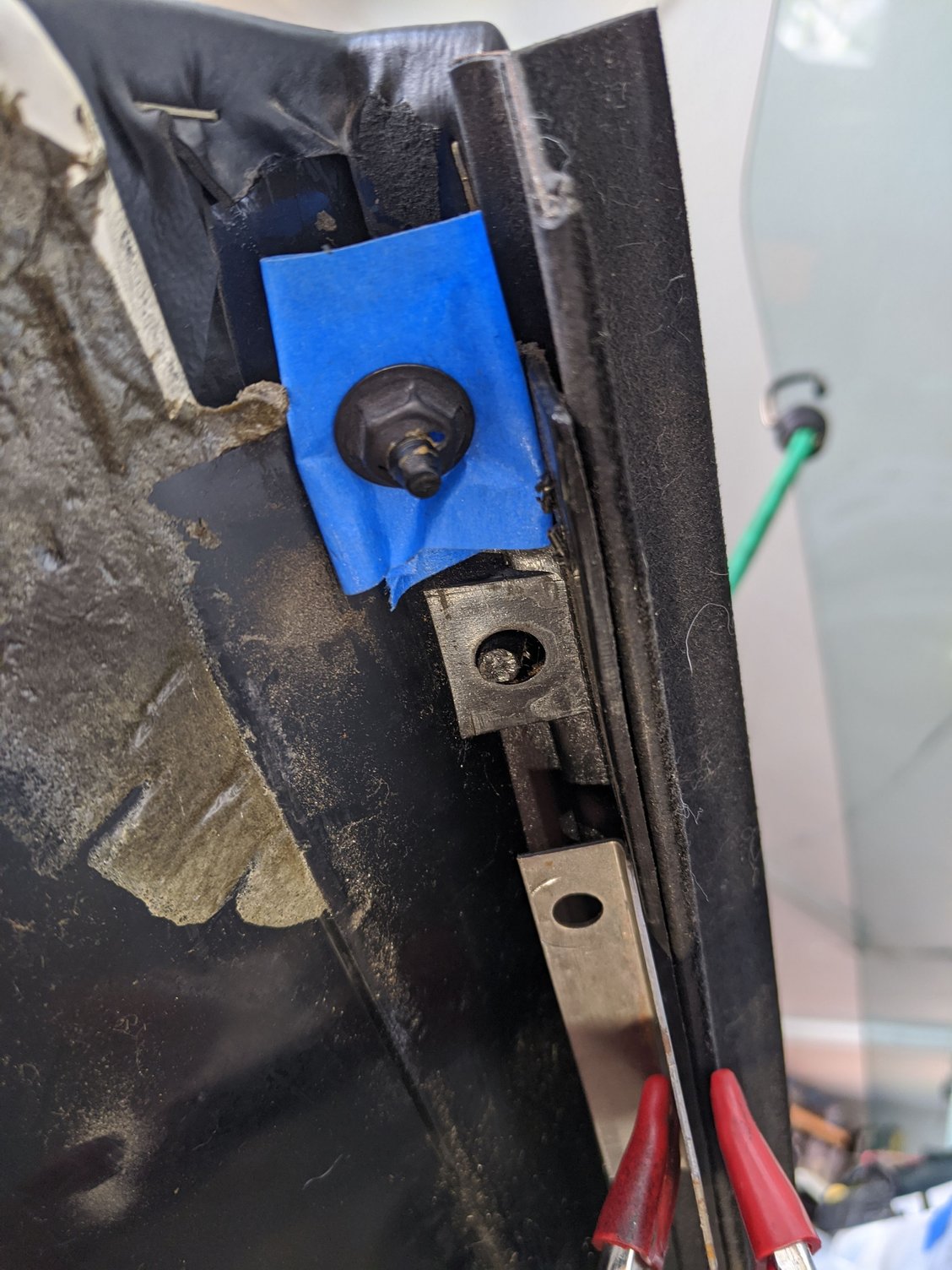

I had the Bose amp repaired for my '88 and was testing the passenger door operation when I heard a "clink". This is a GM 10082828 RH part. Now to get it reinstalled - maybe the window will sound better in open and close testing.
GM 10082828 RH door clip

There is also a broken stud assembly - looks like the plastic just sheared off. The picture approximates what I think would be the correct installation with the parts assembled - probably more clear than GM bulletin 87-116, Number 10.
