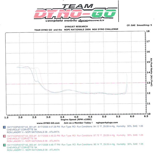

My first dyno in my life at 40, I have had many vehicles, and this is my forth C4. My wife and I went to the Atlanta Motor Speedway this past weekend for the NOPI Nationals and while we were there and in the show, I paid $80 to have my car dyno'ed. Keep in mind that it had the 383 stroker LT1 build shorty headers , mild cam but is still running the stock factory tune, and with that runs and drives pretty well, I've been told though that I can expect an increase in numbers with a new custom tune since the stoker build, that will be coming soon, but for now it had three pulls here are the pictures and numbers...276.08 HP at wheels, and 315 Torque, I'm hoping that after the tune it should be well over 300 HP... I know not really big number to brag about, but not to bad I thought.
Here is the Horsepower ratings 3 pulls:
Here is the Torque ratings 3 pulls also:
And the air/fuel ratios graph, pretty level for the most part they said:

Try leaning it out to about 12.8 for a start.

That sounds good, I'm guessing that when I get the custom tune that it should have had after the stroker build was completed that they will probably do that with any other adjustments that are neccesssary, I will mention it to the guy doing the tune and next dyno. Thanks

Definitely can be leaned out for starters. I hate to be the one saying this, but if you are 100% sure that is a stroker in there, its performing identically.... to a bone stock LT1 6-spd on a dynojet. AT least from what I know. What I really want to say though is that if it is indeed a stroker, you're leaving quite a bit on the table by not having it tuned right. It would freak me out leaving a stock tune and putting a $$$ built 383 on a dyno and running it at WOT.

Every dyno is different. Perhaps that dyno has a more accurate load system or just has more resistance etc. too many variables that come into play. If they're saying stock LT1s have put out 230 , you definitely are running in the ballpark for a mild stroker and perhaps the stock ecu is doing a great job. I'm going to guess by asking if its a 94 because it has the older side fenders and if so the MAF certainly helps the ecu know that its drawing in more air and is more able to adapt than a speed density setup.
To help put things in perspective for you with regards to the point I was trying to get across, on the same dyno I had my car tuned at, a new 06 z06 put down 418 rwhp the day before I went. There's the regular post of stock z06s in the c6z section of them putting down 488 rwhp. go figure.
My first suggestion would be to find another dyno. verify the type that it is etc and the settings (weight, correction factor etc), and go for another pull. Reason being as others have also hinted, your numbers look smack dead on for a bone stock LT1 6 spd on a dynojet.

based on the #s alone, you have what appears to be a stock LT1 with short tubes and corsas. As for a tune, if it is indeed a stroker there may be much more in it. If it isn't, there isnt because most stock Lt1 cars are very close to that #.
Only thing that has me going is that they told you most other stock LT1s are around 225-230. If that is in fact true than THAT dyno may be putting much more load than it should or just may not be calibrated properly.
