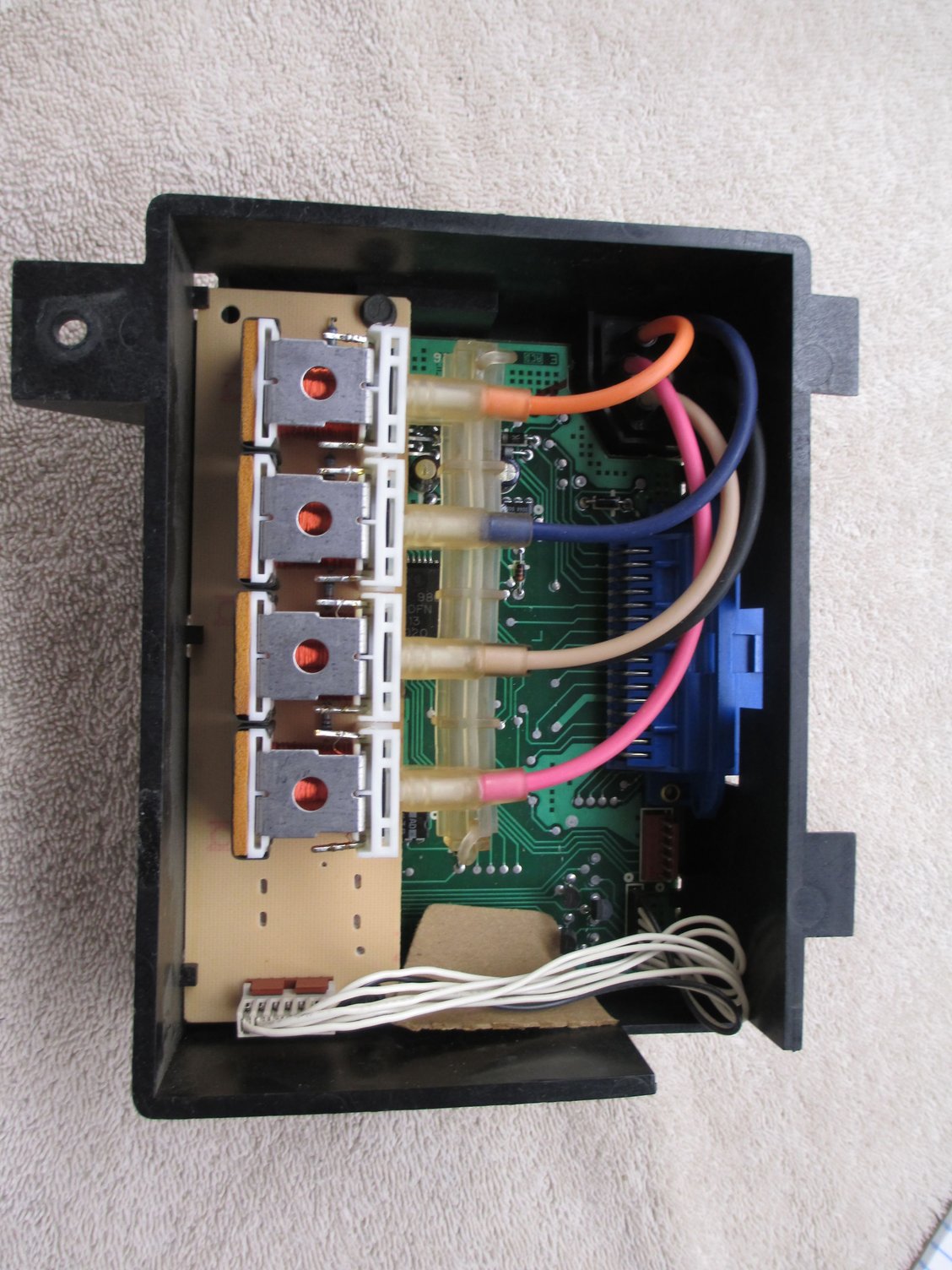

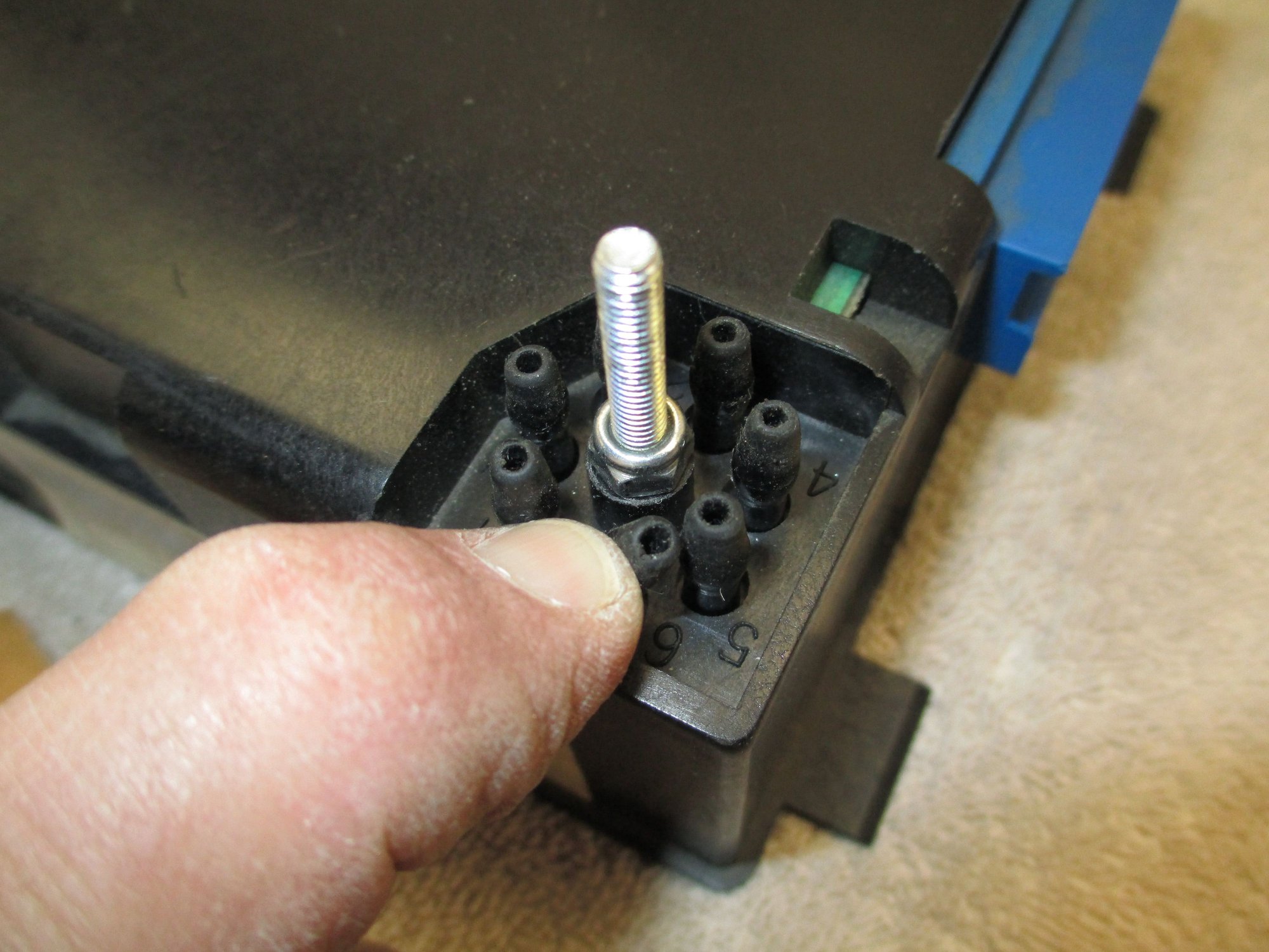

I fixed my '96 Grand Sport's HVAC gremlin yesterday, and the problem is the manifold connector on the '96 HVAC controller.
Photo 1 shows the manifold connections on the '96 controller. Notice how the plugs are very soft. They appear to be so soft that they are collapsing under vacuum.
Photo 2 the manifold connectors on a controller I purchased for $40.00 on ebay, unsure of what year it is. Notice that the connectors on this one are hard plastic. Not knowing the compatibility of this controller to my '96, I just removed the manifold connector and swapped it into my controller unit. I used a locknut to screw it down.
AC immediately comes from proper vents now, and all other functions work properly.
bvsmith and LannyL81 (above) correctly identified this connection as the culprit. I believe one could clip the soft tips back on the stock controller and also possibly alleviate this problem.
Old controller I bought on Fleabay
Inside controller showing tubes going to manifold
Newer controller with manifold swapped

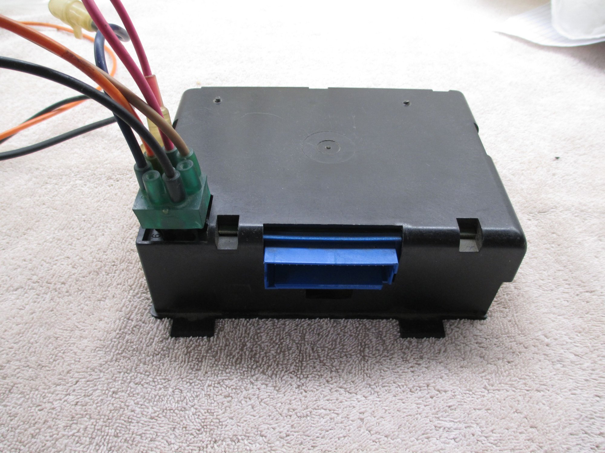

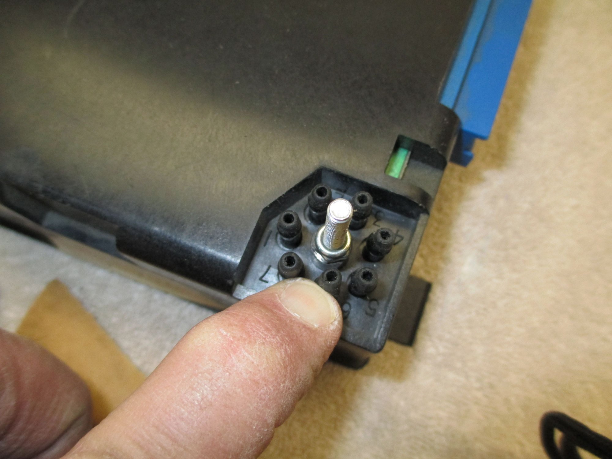

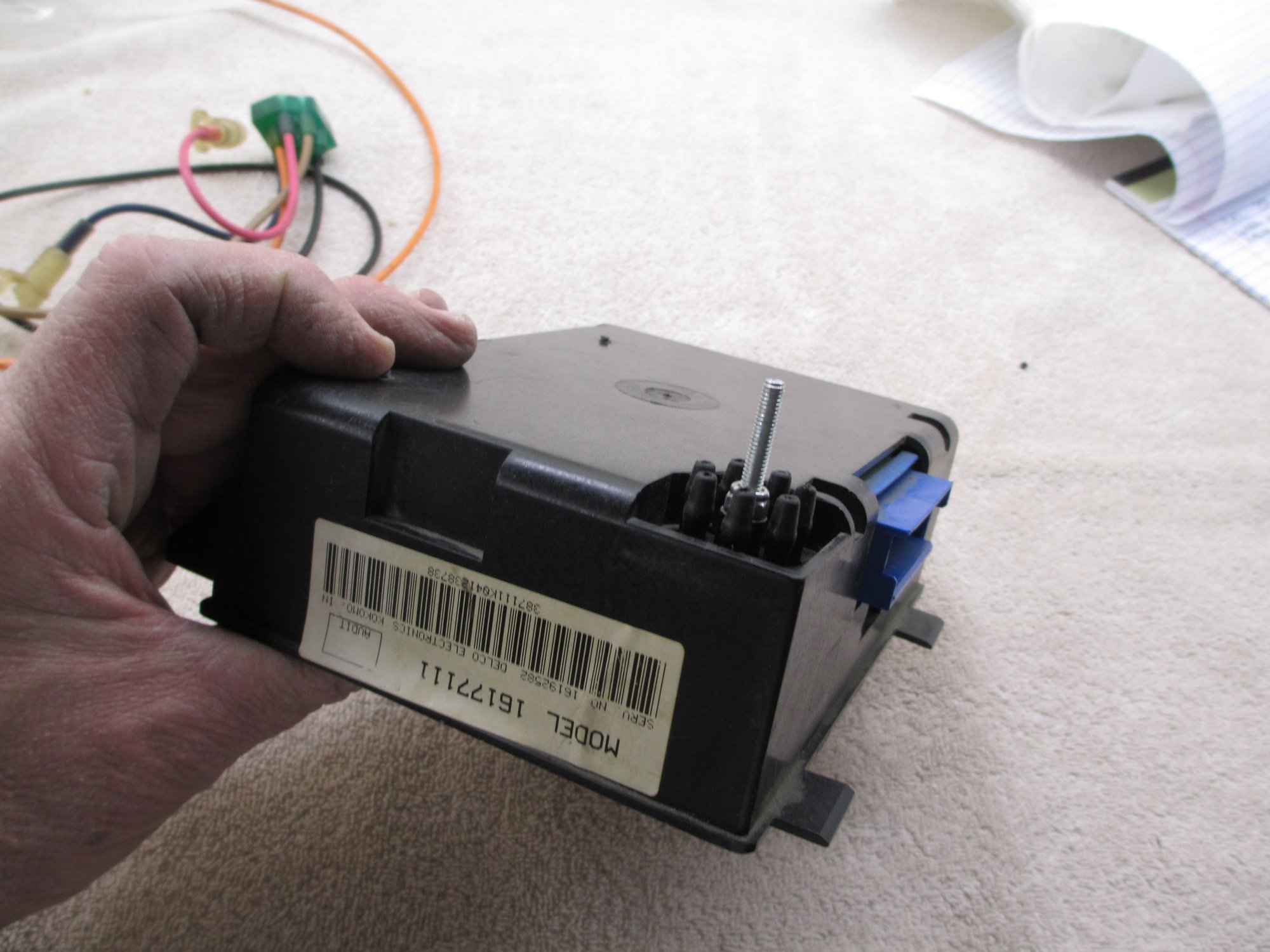

I also just fixed the HVAC controller on my '96, although I went about it a little differently. After getting the two halves apart where they join at the controller (took awhile I must say), I cut the colored tubing at the connector where it goes to all the diverter doors and removed the controller from the car.
Undid the bolt that holds the other half of the connection on the HVAC controller. Took the header assembly out of the controller and cut the tubing at the connection block. Now, this eliminates any connection on the controller itself.
Now here's where you can save yourself lots of time on your back. Cut the colored tubing close to the connector before you even get started! Then you can remove the controller with both halves of the connection attached. If I had known I was going to do the repair the way I did, I would have definitely done this. There's no need to separate the two halves while your upside down in the car!
I used 5 pieces of 3/32 ID tubing, each cut 8 inches in length. Connected each piece of tubing to the five colored tubings coming from the header. Replaced the header in the controller and fed the new tubing directly through the holes in the controller. Marked each open end of the new tubing with the corresponding color, sprayed a little CRC in each end and placed the controller back in the car. After that, it was as simple as matching the colors to the new tubing.
No worrying about collapsing tips or matching up the two halves of the connection and then trying to make sure it's tight enough. Yes, the A/C now comes through the vents and I no longer have icicles on my windshield.
Another word to the wise... Remove your driver's seat. It's easier on the back, but a little tough to get out of the car. Make sure someone's within yelling distance!
