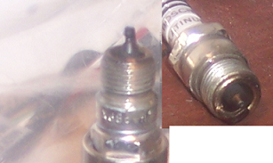

I have a problem with the #4 cyclinder. The spark plug was fouling from what I'm guessing is oil. So I changed the Valve stem seal. Drove the car for a couple of miles and recheck the new plug and it seem to be fine. I drove the car everyday for a week and it started doing it again. I did a compression check on all cyclinders and they were all the same(180 psi). I'm not sure what to do at this point. Is there's something else I over looked that could cause this? I posted a link/ picture of the plug. This engine has about 7k on it.

that is definately oil fouling...
a compression test is rather useless, you need to run a leak down test. a leak down will check the cylinders capacity to maintain pressure.
I don't know why you would want/need to replace a valve seal on a new motor like that. If it's that new, you might have a warrantee claim, if it is a head related problem. There is a chance that the head shop didn't properly hone the new valve stem seals.

Lot of brown (gas) on there-try switching that injector onto a different cylinder and see if the problem moves.

Rssshen: When you replaced the valve seal on #4 cylinder, did you feel for any radial movement of the valve in the head? From what you said in the initial posting, the replacement of the valve seal seemed to help for a few days and then went south. You may have what Bogus suggested: "There is a chance that the head shop didn't properly hone the new valve stem seals". This would quickly wear out the new seal and then leak oil into the cylinder. This condition would not impact the compression on that cylinder.

A leakdown test will show you cyl leak issues, but won't show you a bad oil control ring. Oddly enough, a cyl with an oil issue often shows an abornmally high compression test reading. (you stated they all came in at 180).. Weird stuff. Wish you were local, i'd love to tinker with it.

honing valve seals...that was a new one on me I think I'd opt to first try the fuel pressure test just to eliminate that from the equation, plug looked fouled to me but I really couldn't tell by the pic if it was oil or gas. And you may want to ohm the plug wire. I was brought up with compression testing and I still have alot of confidence in it...but it won't show a bad valve guide, and that could be the problem.
