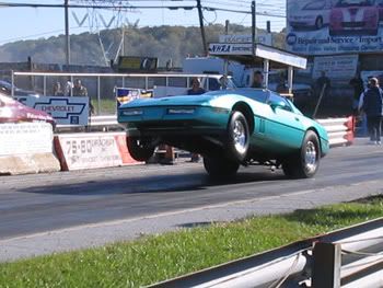

Gosh I can't remember the screenname, but there is a guy on here who has a turquiose green C4, and his sig pic shows him lifting the front end up high. The kicker of the sig is that it mentions the (motor's)bottom end as being stock.

I believe the turquoise car received a solid axle rear a few years ago.

Originally Posted by 89 Paul in Cal
... there is a guy on here who has a turquoise green C4, and his sig pic
It took a while for me to recall his name, but I believe we are talking about
HOOKEDUP
Then there is
Wheelsup
Of course I neglected to include the owner of the white car posted
earlier - ski_dwn_it
