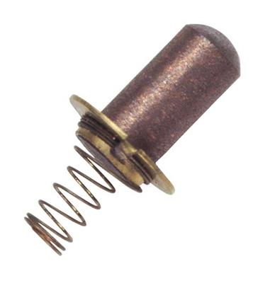

http://store.summitracing.com/partde...5&autoview=sku
I use this button , haven't had a failure yet with the 6al
