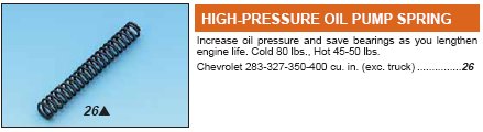

I dont know if this helps,
but I have a #26 SBC High Pressure Oil Pump Spring made by Mr. Gasket that measures .300" OD by 2.220" long
Never used still in the package on my desk so it has not been collapsed, no paint color, just steel.
At first, the available dimensions suggested your Mr G spring is similar
to the spring I have.
However, a check of the catalog (p54) indicates that the company markets
the spring as a 'High-Pressure Oil Pump Spring'. Mind you, 'Hot 45-50 lbs'
is not all that high.
LD85, if you have calipers and some time it would be interesting to see
the rest of this spring's physical measurements for a more complete
comparison. (I measured coils-per-inch inward from the ends to get
away from the squared/ground portions.)
At the risk of redundancy, this spring and my springs are 0.300-0.320"
in outside dia. They fit into the recess of the screw-in plug retainer.
Springs in the pumps that use a roll (taper) pin for retention are larger
in outside diameter, nearly the size of the bore of the by-pass - 0.442".

10 coils per inch
.300" OD
2.220-2.230" OAL

Sorry,,, .040" wire diameter

Restating the dimensions of LD85's Mr Gasket 'High-Pressure Oil
Pump Spring' (P/N #26) gives us the following
0.040" wire dia
0.300" coil dia
??? coils
squared and ground coil ends
10 coils per inch
2.220-2.230" uncompressed length

My mellings M55 is 80 psi cold and 40-45 psi when warm, around 180 degrees. So, I must have the higher pressure spring.
Mine has a roll pin and a orange colored spring. It was installed in engine 2001.
This is in my 96 LT1 396 in my 93 Vette
Mine may be a Canton Racing spring
http://www.cantonracingproducts.com/oil_pumps/acc.html
