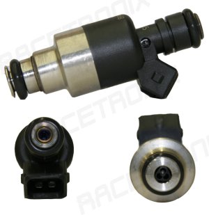

We stock new replacements which use updated disc technology but use a factory-style body for proper fit and appearance.
http://www.racetronix.com/01D036x.html
