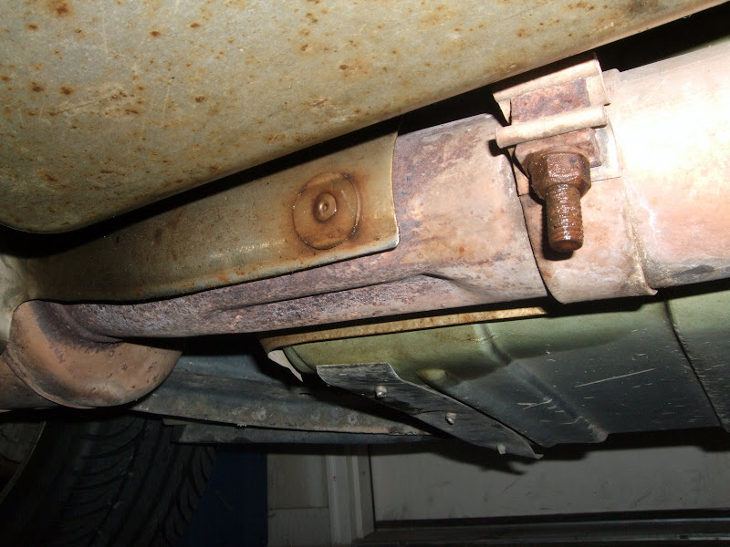

What's the fluid on the body underpanel (and on the exhaust clamp bolt too)? You spill something behind the driver's seat? Probably not related, but ya' never know...
The car ran great when it went in their doors,

Originally Posted by Chad McCan
I got a photo of the "alleged" damage...
That is a factory dimple on the exhaust. It's really for the verts as the X-frame crosses the exhaust right there. GoodYear didn't do that. Maybe they road tested it and something went wrong. How's your opti-spark? Mine crapped out around 40 k.

Yeah, we have already determined it's not the dent causing the problem.
