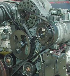

Originally Posted by 69427
I'm not familiar with the difference between early C4 pulleys
and your '96. Can you post a picture sometime?
Courtesy of Schram
Aardwolf, what is the diameter of the pulley on the '88?
Have you looked back through the claims made here for Lucas P/S
Stop Leak fluid?
Perhaps explain more about what you intend to do with the hose
barbs and the reservoir. The reservoir inlet (side) and outlet (bottom)
are low/no pressure lines.

Ack, GM stole my idea! I like that vented pulley! I'll either vent mine like that or if I find one cheap buy it. Thanks for the tip!
I was thinking to move the reservoir so the hoses would need to be a little longer. I could splice them or run new hoses. Maybe an aluminum reservoir would help shead heat too.
RickF, did you add a cooler with that PS pump too? I've read people using coolers and some that don't. I'd rather not add one if it's not needed with the better Turn One pump.
FYI found pix of pulleys on Ebay.
Listed 94-96
ZR1 got holes to! 90-95
05-07 really got cut away!
Slalom4me, I'll check the pulley dia later this aft. Any thoughts on balancing a home vented pulley?

There is something vaguely unsettling about the pattern of the
holes in the pulley shown in the first image.
March offers an aluminum 6-rib serpentine pulley as P/N #610.
This one is 6-3/8" in dia. It is unclear what the offset is and
whether it is a suitable replacement for an '88 L98.
Perhaps the cut-outs contribute to pump & fluid cooling - it
would be interesting to learn by how much.
Pressure takes work and this creates heat. If TurnOne's
modifications involve reducing the operating pressure of the
pump then this should reduce fluid temperatures materially.
Rebalancing a modified pulley statically might be done by mounting
it on a mandrel, setting the assembly in v-blocks or bearings of
some kind and then relieving material until the pulley remains
stationary - no matter where it is positioned within 360º of rotation.
Balancing the pulley dynamically might be achieved through the help
of an engine shop or an electric motor winding facility.
Either path seems more frought with issues than locating a suitable
replacement.
