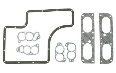

Anyone know if the runner gasket alignment problem still exists?
It was one of the two gaskets that are sitting inside the lid gasket in the picture.
Its been a while since I did mine however I do remember that the gasket would have leaked without question if you didn't modify it.
Old Jan 15, 2009 | 03:26 PM
Slalom4me's Avatar
Slalom4me
Joined: Jan 2002
Posts: 9,036
Likes: 13
From: Edmonton AB
In 2005, Caboboy reported a problem with his SuperRam gaskets in
the following thread.
Here is the ExecSum:
Superram people, vacuum problems? Step inside (2005.02.05)
Originally Posted by Caboboy
All my gaskets have an EGR slot 1-15/16ths long, whereas
[Rich at CruzinPerformance] are all 1-3/4" in length.
Originally Posted by Shadow1
Accel/Mr Gasket produces the gaskets for the SuperRam's
and also for the Accel LTR's. They each use different gasket
sets hence the difference in the now infamous "slot length
dilemma". It appears that what happened is that someone
mistakenly packaged gaskets intended for the LTR's into the
74196G SuperRam replacement gasket boxes as well as into
some of the 74196 SuperRam plenum/runner kits. Its a
mistake, plain and simple.
