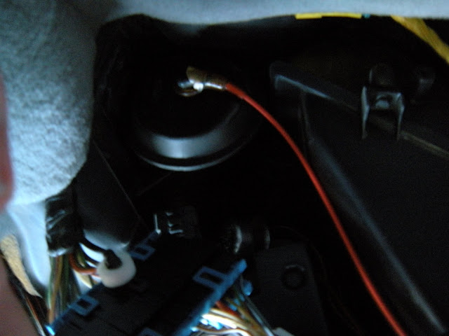

The fuse box looks like this in my '91
And as stated above, it's located at the passenger side, real PITA to get to. After you have removed the kick panel, you still have to crawl on your back all the way as far front as you can and then the fuse box will be right over your forehead. Good luck!
Here is a view from a different angle, check the colours at bunch of wires in both pictures, and you'll know, where the fuse box is.

Hello,
Thank you very much for the pics because I thought I was loosing my mind. I can not find a fuse box under the kick panel. There is an empty space where the fuse box is in your picture.
Well.....I just found the problem: It was a fuse in the fuse box. I was looking for a 5 amp fuse and looked right over it because a previous owner had replaced it with a 10 amp fuse.
Thank you very much for your help.......
Ok. So it has changed since the '91 model. Sorry, that I misled you
